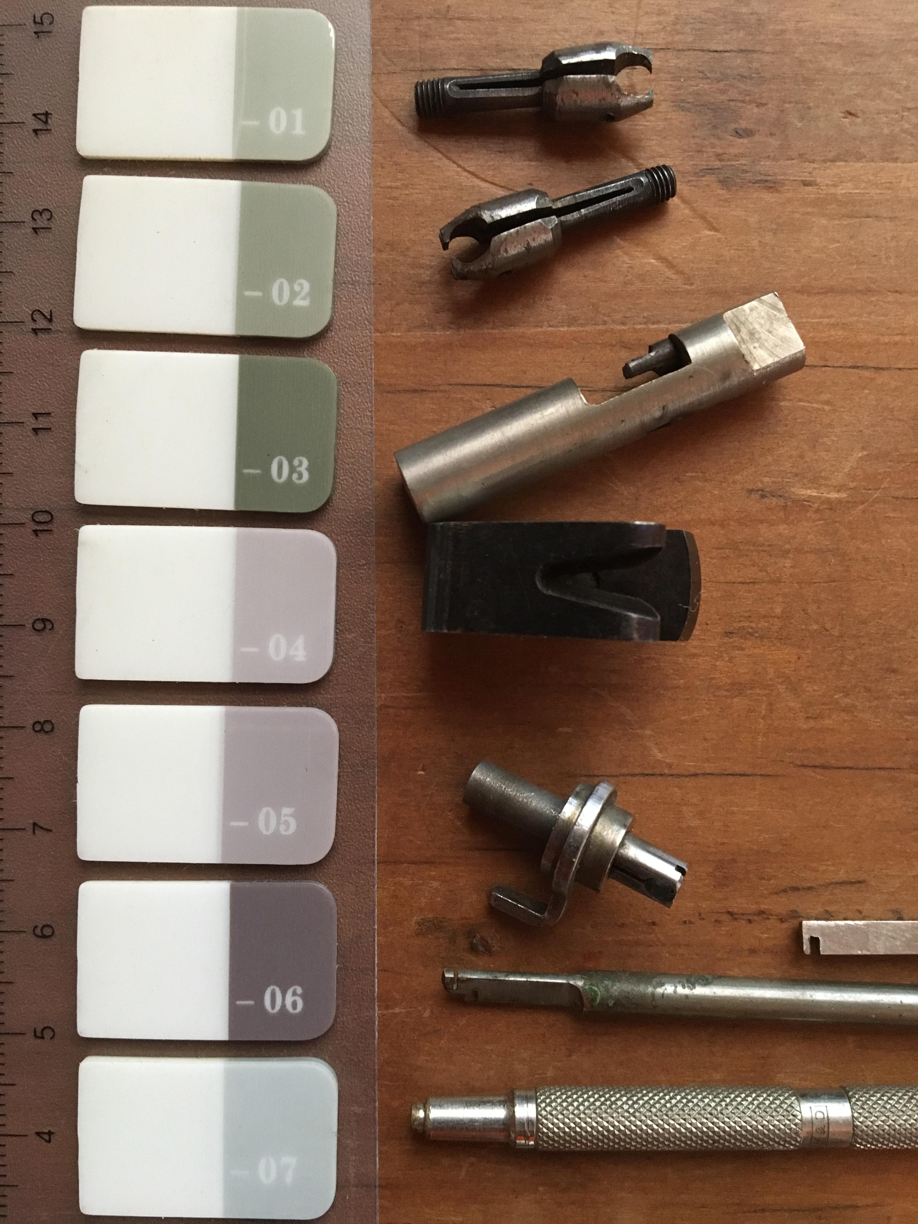

Dear all, I was given some nice mistery tools, and cannot wait to use them. If only I knew what are they for..
please help. I am aware most are incomplete, and would love to make the missing parts and restore them.
1 and 2 look like part of a tool to remove roller tables as does part 4.
6 are home made tools used to straighten bent balance wheels.
6 are used in conjunction with truing calipers and allow you to grab the outer rim to the balance wheel and bend it to straighten it.
Edited by Tmuir
  Hi   As Tmuir explained the top 2 are rolller removing stumps used in conjunction with a staking tool or roller removing table.
No 5 is also a roller remover, No 7 Is a tool by Kenrick and Davis need a better look at the ends before defining its possible use Nos 3 maybe a roller remover fork, No 4 again need to see the ends It is possible its for tightening cannon pinions
Thank you Tmuir and watchweasol!
roller removers by the dozen, then.
Here are the pictures for n. 7. I guess whatever it was, it’s not worth fixing now.
Number 3 is intriguing..
