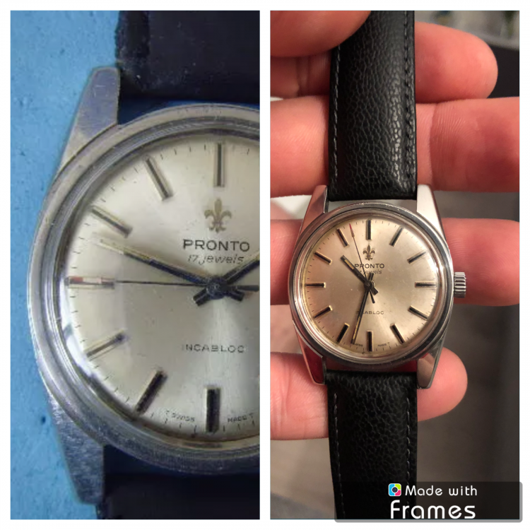

Did the last finishes on the watch today. Sanded down the case with 400, 600, 800 and 1200 grit sandpaper to get rid og the worst scratches. Then polished with metalpolish. It turned out well, have a look. Pictures before and after.
But again, what oil should i buy for the pallets? Moebius 941 or 9415?
