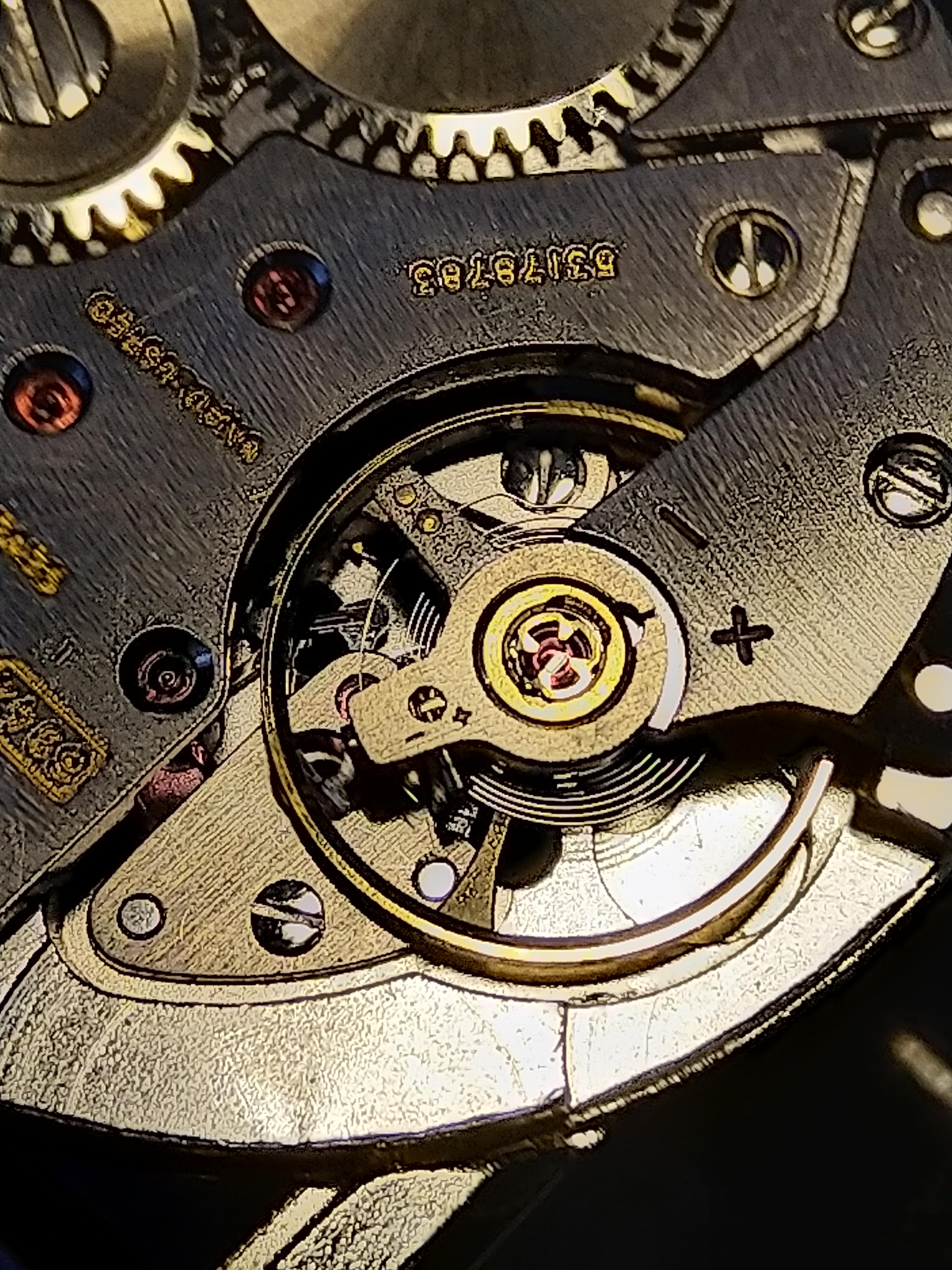

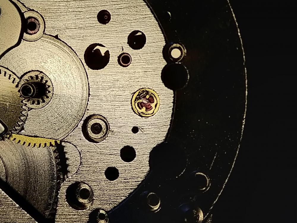

When you look at the shock absorber through a Lupe you can se it has a wide and a narrow slot on the brass ring. On mine the narrower slot is positioned to the left.
With an oiler I push the spring on the narrow end downwards. the spring should pop up a bit so lift it up to the position you see in the picture.

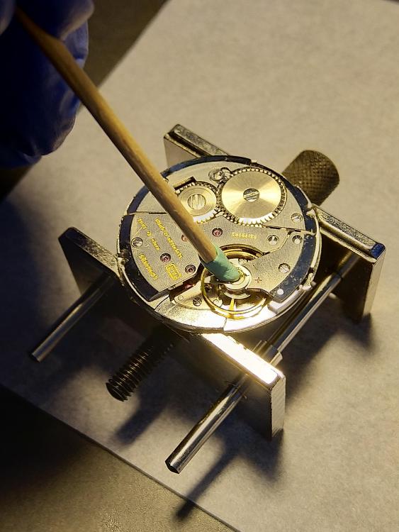

Cote a sharp peg wood with the Rodico and form a point. I think even Harry Potter would be envious at this magic wand!
With this homemade precision tool pick up the jewel, sometimes you just get the cap first so you have to do this procedure twice.
After cleaning put a small drop of oil on the flat side off the jewel. make sure it do not fill more than 40% of the surface area.

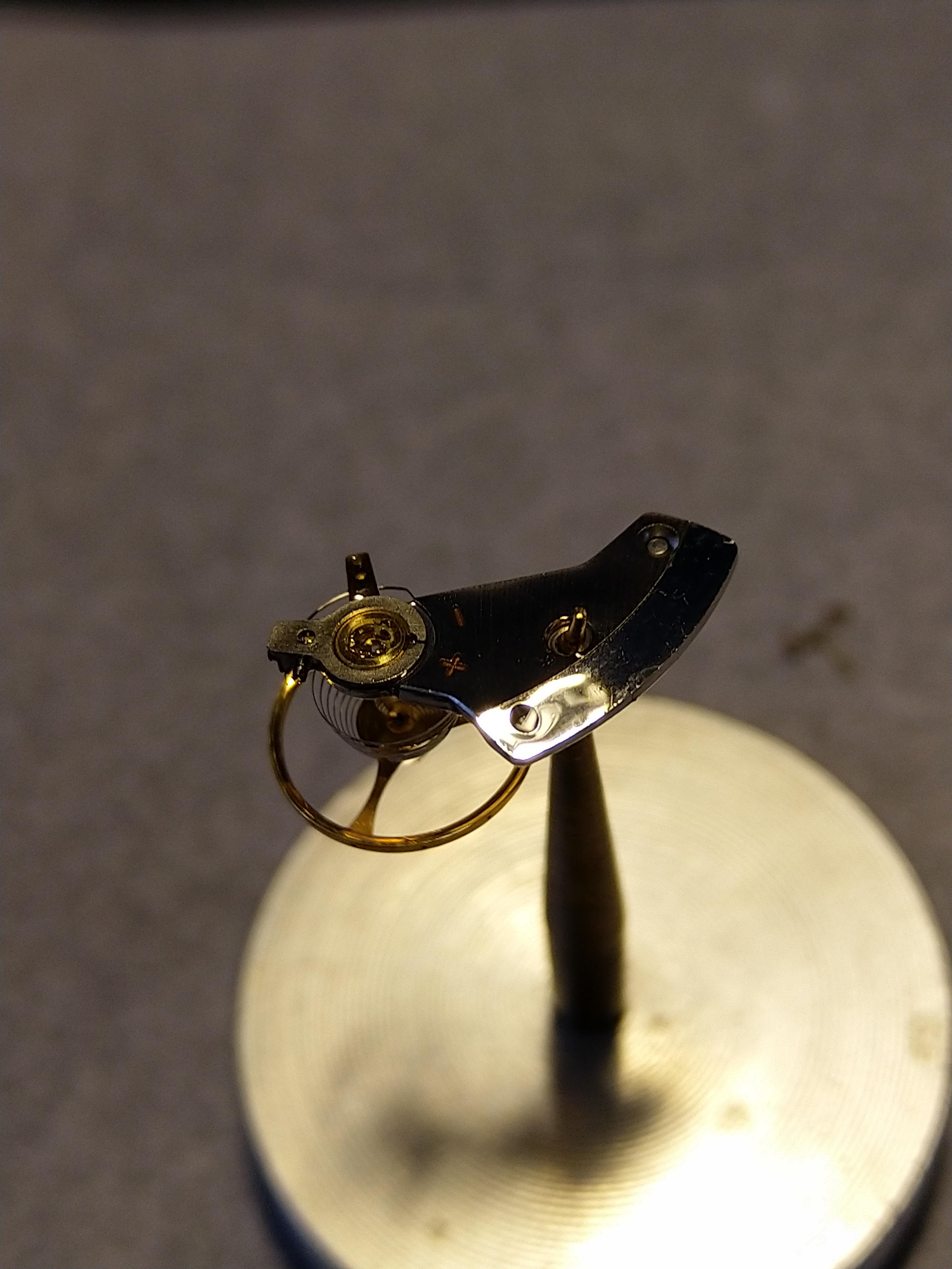

Remove the balance bridge.
Make it soak in the one-dip, even if it looks empty there is a fresh load of it in the jar. Cleanliness is a virtue ;)

16 minutes ago, rogart63 said:
What use does the +- have on the beat error arm?
Guess they just symbolize the direction to go when adjusting the beat error. It isn't like on the regulator where you make the spring length shorter or longer and by that increase or decrease the oscillation frequency. Should have been R & L since you center the impulse pin in relation to the pallet fork with it,
Edited by HSL
Somehow statements like that comes back to bite you in the ass.
Even though this contraption is on the beat error arm it can be used to regulate the rate, python port regulator, hence the + and - .
It has a smal brass disk attached to the center of the small setting screw, it moves back and forth. Due to the friction between the brass disk and the regulator arm it moves it in micro steps.
For some reason one always seen them but never given em a closer thought.

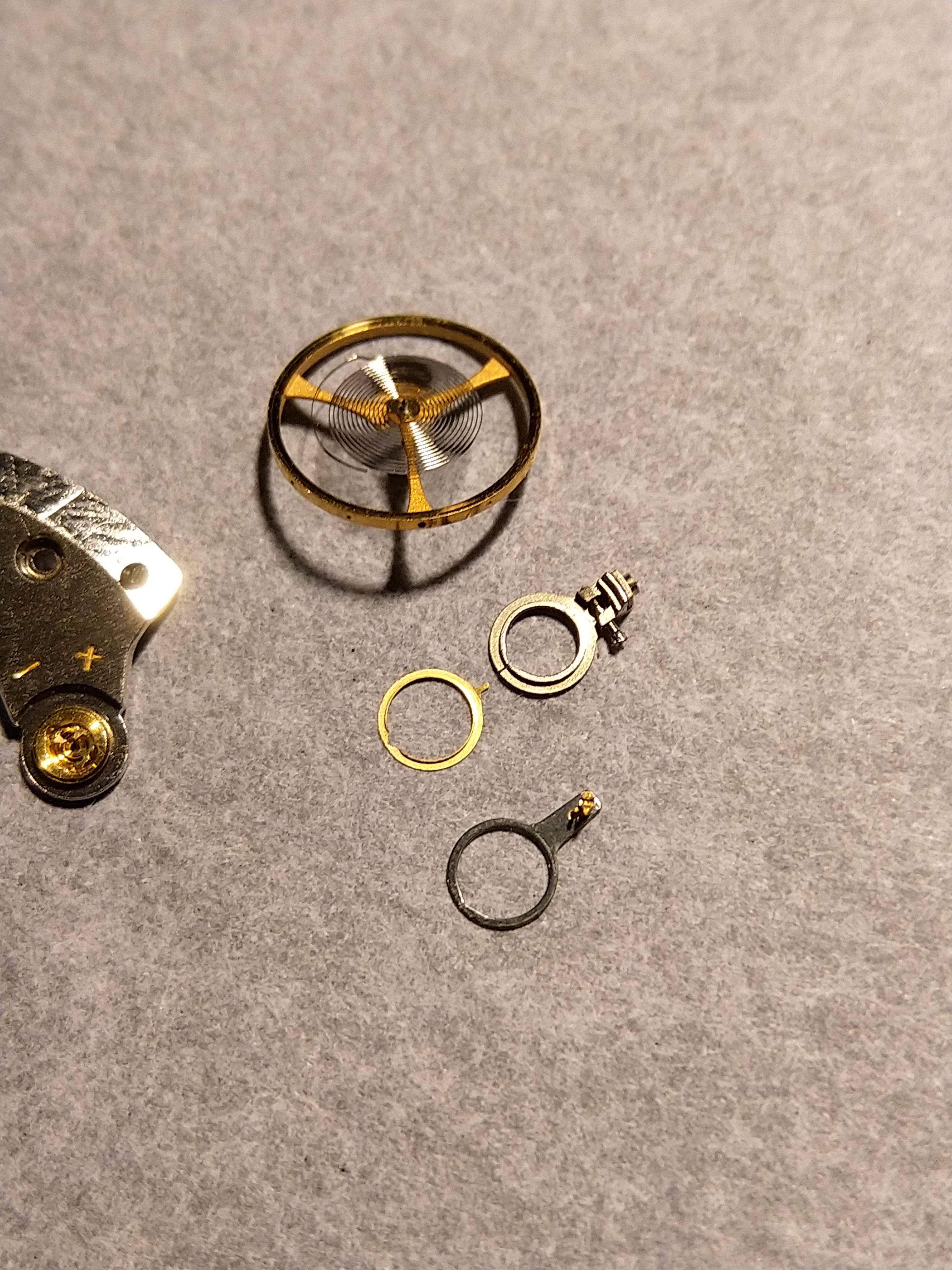

Here is a pic of a spare I had. Notice the easy studless hairspring attachment.
i didn't see the screw. I thought it was a screw from the top. But it's a nice idea to be able to adjust the length of the spring.
