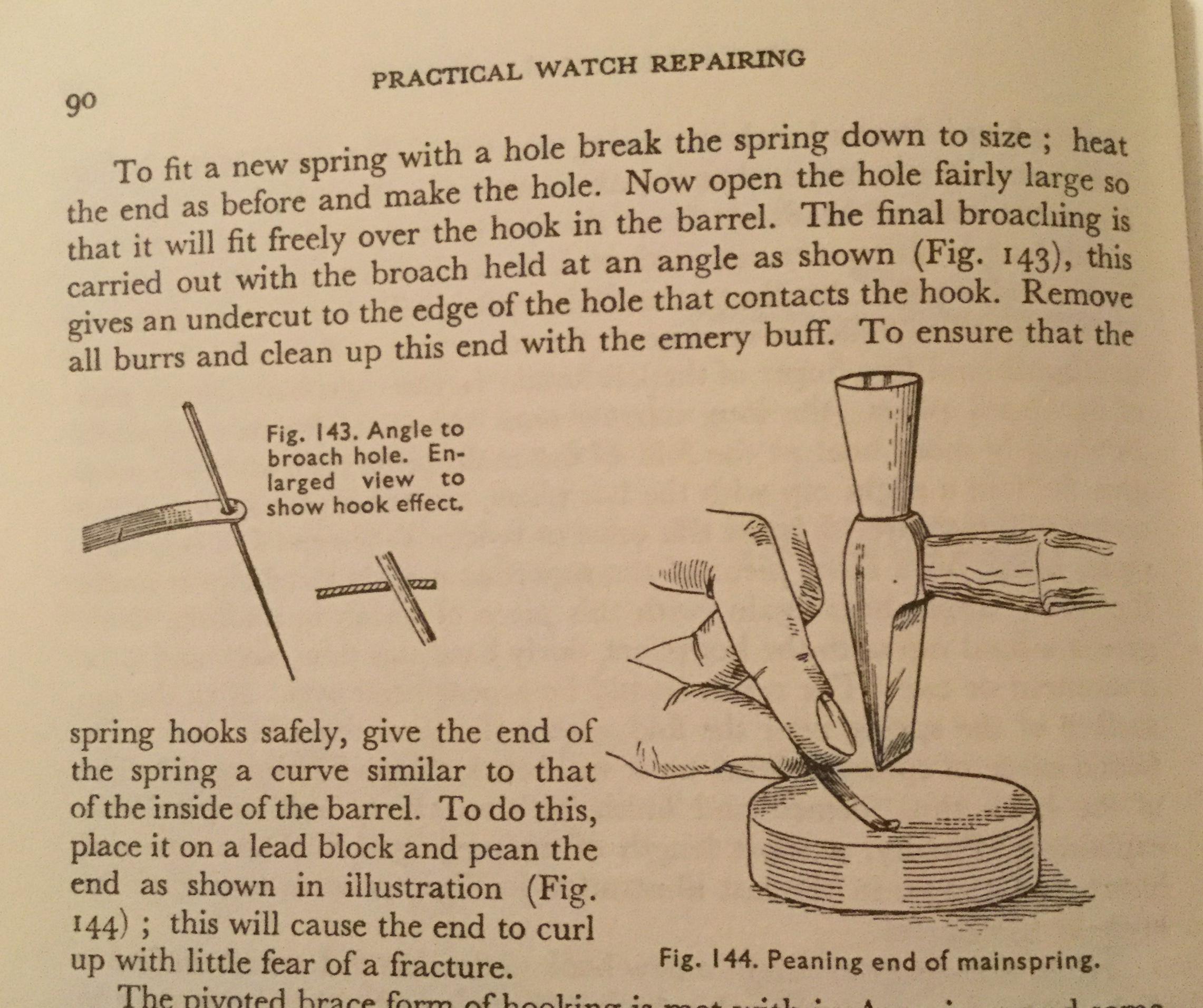

I've a Swiss pocket watch, no markings to identify the movement, but it needs a new mainspring.
The old mainspring is 1.9mm wide, 0.185 thick and 620mm long. The barrel is 19mm and the arbor is 4.8mm so a length calculator says 590 to 737mm, so the 620mm is about right.
The mainspring has a hole end, so that seems to make it difficult to find.
I've found a reference that says this matches a Baumgartner/BFG 760 or 80 calibre, or GR5630, but not found anywhere that stocks anything that matches or even seems to be close to this mainspring, particularly with a hole end.

First of all, where did you go to check the spring you found in the watch is the correct size? You need a spring which gives 0.1 to 0.2mm clearance on height - so check your barrel depth, and I like the reverse engineering calculator here http://www.vintagewatchstraps.com/mainsprings.php#reverse to work out thickness and length. If you have a 19mm barrel i/d, then you do probably need a thicker spring - more like 0.24mm. Read the whole page for more info.

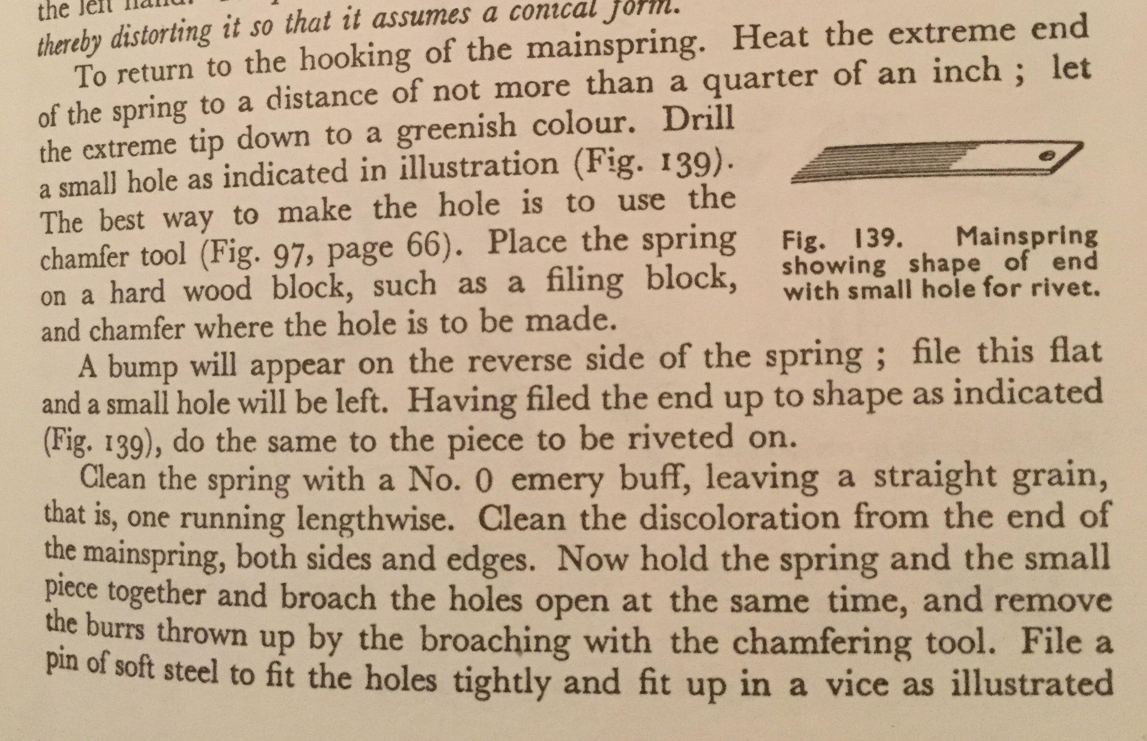

You may have to buy a longer spring and cut to size and create your own hole. Mainspring hole punches come up on eBay from time to time, but see below on how to create a hole without...
Here is the reference on “heat the end as before and make the hole”
The chamfer tool described is a bit like a centre punch with a pyramid shaped end.

@StuartBaker104 - thanks for the calculator, I'll see if the parameters it provides match any of the off-the-shelf springs. Otherwise I may have to, as you say, modify an off the shelf spring to fit - I have Donald De Carle's excellent book, but thanks for the images.
