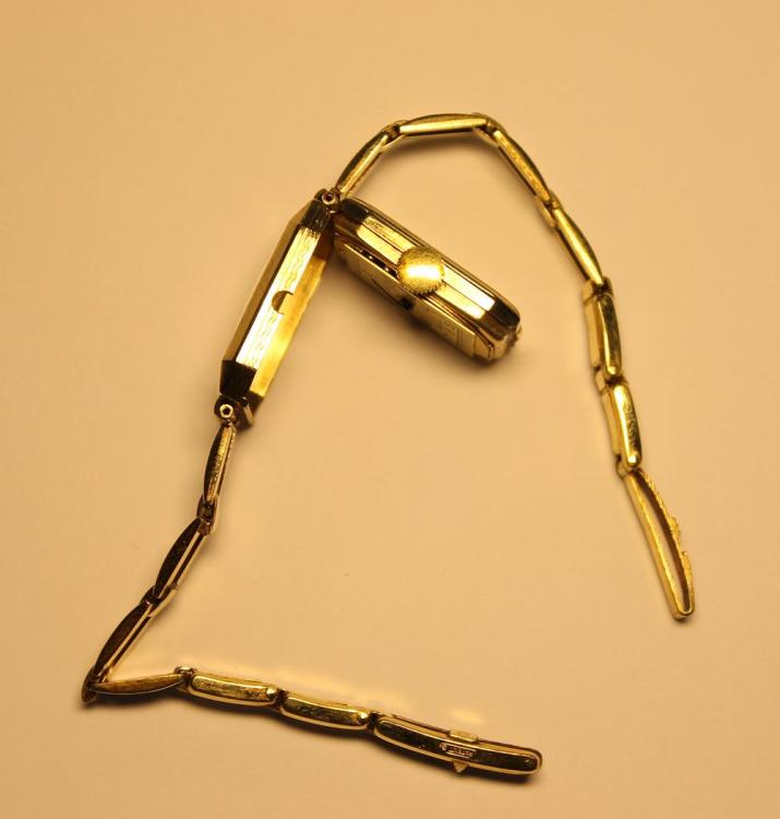

The LACO ladies watches I'm going to service are from this period. All the three watch housing and bracelets are made from "Rolled-gold", 20 microns, are brand new (NOS) and are in excellent cosmetic condition. None of the movements do run, however they seem to be intact. Two of the watches do have the 16-jewels DUROWE / LACO 503 movement and one has the DUROWE / LACO 501 movement, which has no jewels. Clearly the 16-jewels movements are of high quality finishing. All the screws do have a high polished finish, so does the top of the ratchet-wheel and trans-wheel. Both wheels do have an immaculate polished "hollow-disc-like" finish. The 503 and 501 are in build-up identical, so I'm only going to describe the servicing of the 503 movement.
All the watches do have a hinged back-lid in which the movement houses;
With the back-lid hinged open, the movement can be taken out;

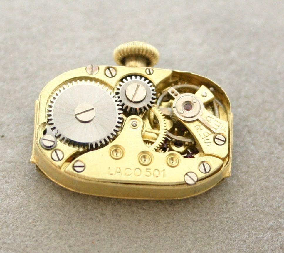

Around the movement sits a "case", more like a case-ring. The ring has a tube soldered on the side through which the winding-stem runs. The movement itself is held in this ring by two case-screws;

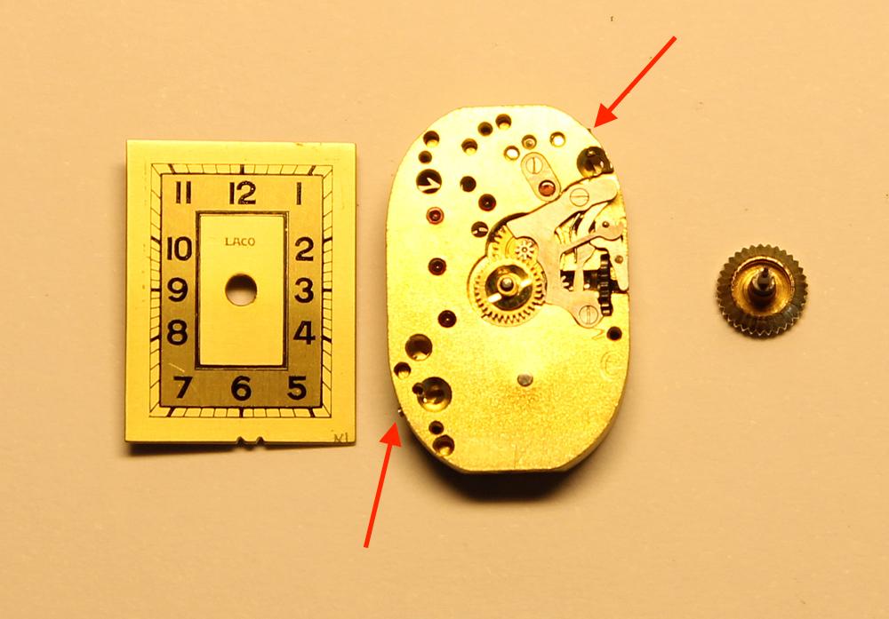

With the winding stem pulled and the case-screws removed, the movement comes out at the front. Clear to see on this picture is the highly polished finish of the ratchet-wheel.
Once the movement is out, the dial, secured by two dial screws, can be removed;

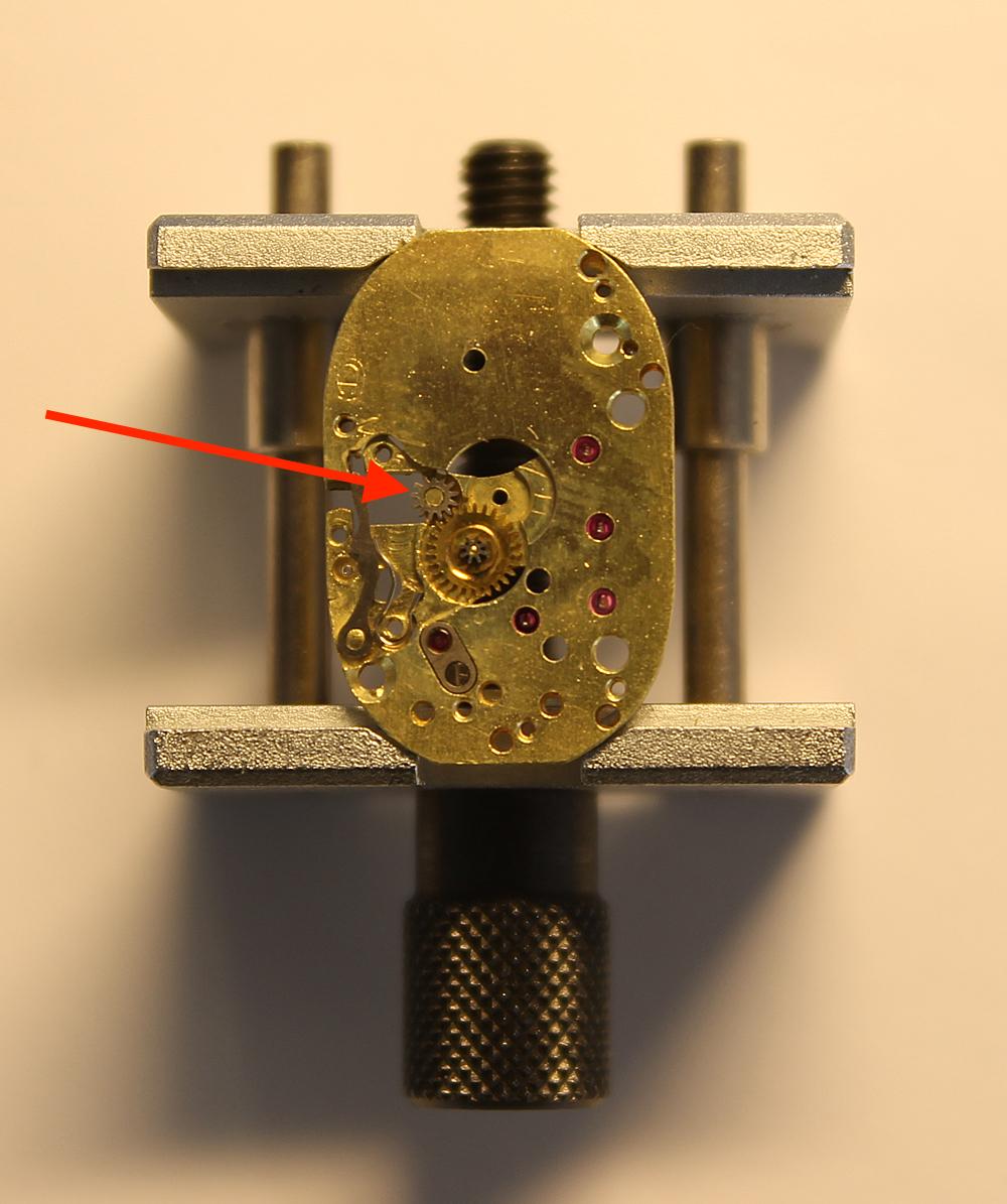

This movement fitted much better in my Bergeon 4039 movement holder than the similar shape Kasper 200 movement. Removed the balance and pallet bridge, but the pallet-fork self was "stuck", that is to say that it was able to swivel from left to right and vv, but I couldn't lift it out of its jewel.
I decided to dismantle the movement to the point that I could submerge it in Zippo lighter-fluid, letting the oil, which was holding the pallet-fork, dissolve.

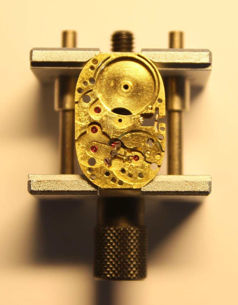

Wheel train bridge off;
Now I could remove the 4th wheel and the escape wheel. The 3rd wheel was underneath the center-wheel, so I had to flip the movement over to pull the cannon-pinion with the pallet-fork still in situ. Removed the cannon-pinion which left me with the main-plate and the "stuck" pallet-fork;
A part of the keyless works was still attached to the main-plate, but that couldn't harm. Left it all a hour soaking;
and the pallet-fork came free ;)

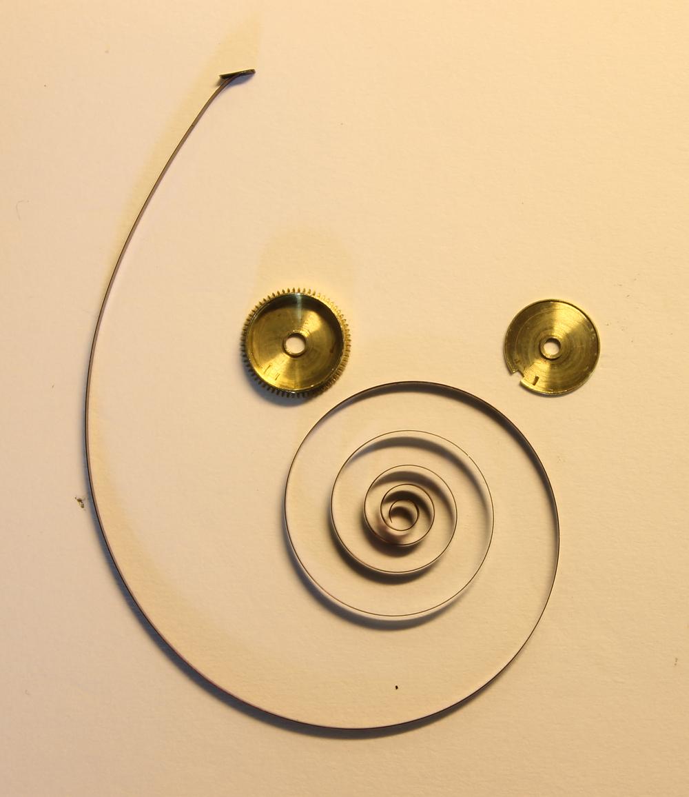

Took the main-spring out the barrel;

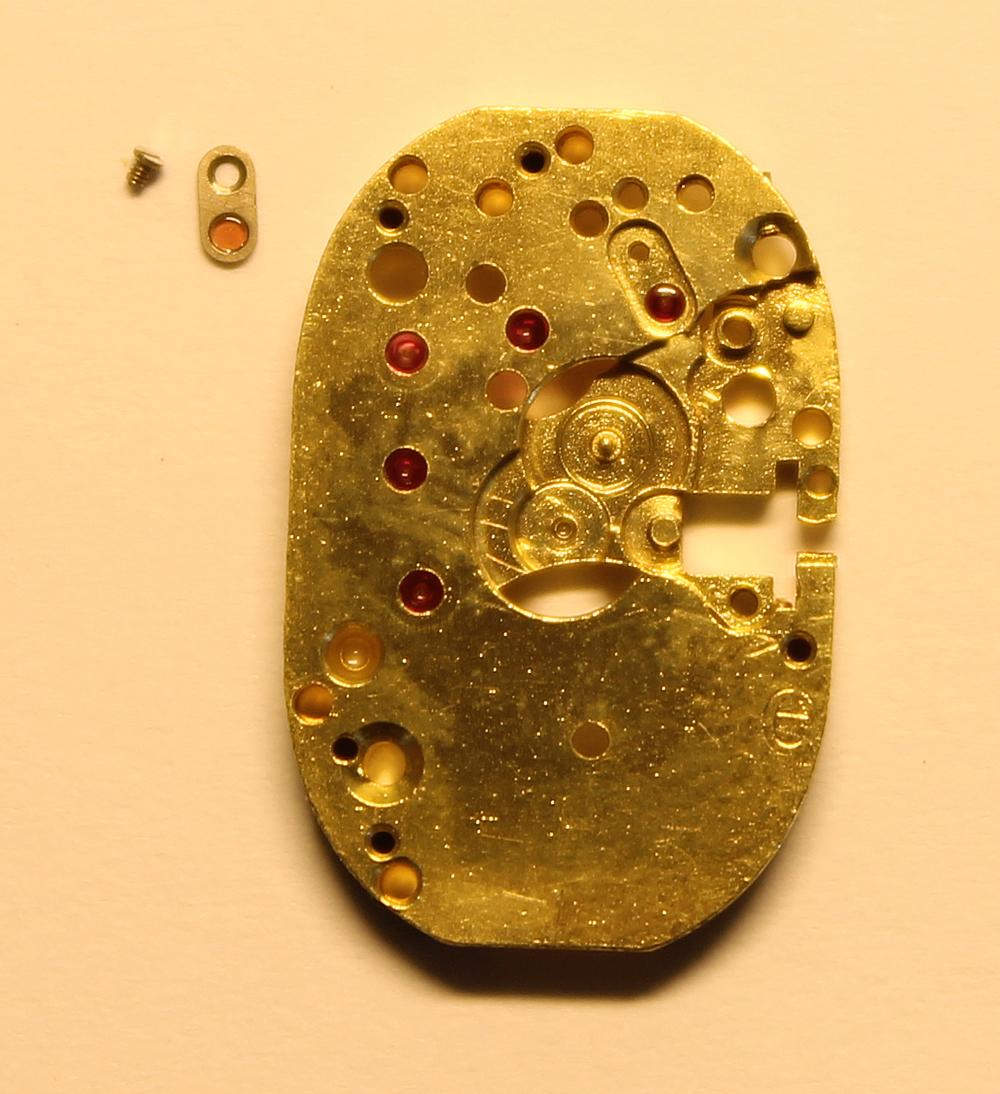

and the balance cap-stone off the main-plate;
All the parts are now submerged in Zippo lighter fluid and tomorrow it will be the cleaning of the jewels, cleaning & oiling of the balance cap-stones and hopefully the reassembling........ if all goes well !?

The balance cap-stone on the main-plate was no problem and while having the main-plate still empty, I took the opportunity to check the line up of the balance impulse jewel and the banking pins; the jewel was right in the middle.

Totally dissatisfied with the results above, I decided to strip the movement again and let the parts soak in Zippo lighter fluid. Old oil seemed to be the culprit and some serious pegging had to be done. This time there was no easy "opt-out", the balance jewel in the balance bridge had to be properly pegged and oiled.
I decided to get the delicate balance out of the way first. As described above, the 0.8mm screwdriver was too big, the 0.6mm screwdriver fitted, but proven to be too weak for the task.
I decided to customize the 0.8mm screwdriver blade by dressing the sides down to the full length of the screw-slots (about 0.7mm) and flatten the tip of the blade until the blade had the maximum amount of "beef" and fitted the screws-slots snugly. This would give my the highest, and the final, opportunity to undo the two screws.
Lo & behold; It worked !! :woohoo-jumping-smiley-emoticon:
Now I could do a proper oil job, but pegging the extreme small bore of the ladies movement balance jewel was another challenge. My experiences with these tiny holes are that if you get the tip of peg-wood in, it brakes off easily. Next to that, once you got the peg-wood in, while rotating, your fingers slide & rotate down. Once the fingers are to the end of the peg-wood, and some more pegging is required, you either have to pull the wood and try it again or; try with the peg-wood still in the jewel-bore to get your fingers back on top of the peg-wood ........ with a very high probability that the peg-wood tip will brake off; stuck in the jewel :huh:
Some kind of solution had to be thought of, perhaps this has been done before, but so far I haven't seen it; the screw-peg ® ! :biggrin:
I had a small box of toothpicks. The diameter was 1.6mm. One of my screwdrivers is 1.6mm. I removed the screwdriver steel-tip and with one of the toothpick ends cut off, the toothpick is a press fit in the handle. The toothpick-tip can be sharpened multiple times by either a knife or dressing it on a diamond stone.
Now, with the peg-wood tip in the jewel, you can rotate as long as you deem required. I also found to have very high control over steadiness, direction, rotation and applied pressure.
Works like a treat !! :jig:
Back to the movement; Pegged & pegged again every hole till spotless. Pegged every pivot. Installed the balance to check free movement and re-check the impulse jewel line up with the center of the banking-pins. With now both cap-stones oiled, the balance rotated freely and smoothly.
Same with the pallet-fork; installed the fork and it rocked backwards & forwards on its own weight. The wheel-train run with the slightest touch on the spring barrel. Sounds good !? ....... hmmm, not so........ with the movement assembled, it still doesn't run happy. An amplitude of below 120 degrees is hardly something to brag about. It also stops after a few minutes, continues again after a little shake .... perhaps pallet-fork / escape wheel area ? Still a beat error of over the 7ms, whereas the impulse jewel was spot-on the center of the banking pins  ..... Hmmm ....... :mellow:
Being Dutch, I will say: "Luctor et Emergo" .......
