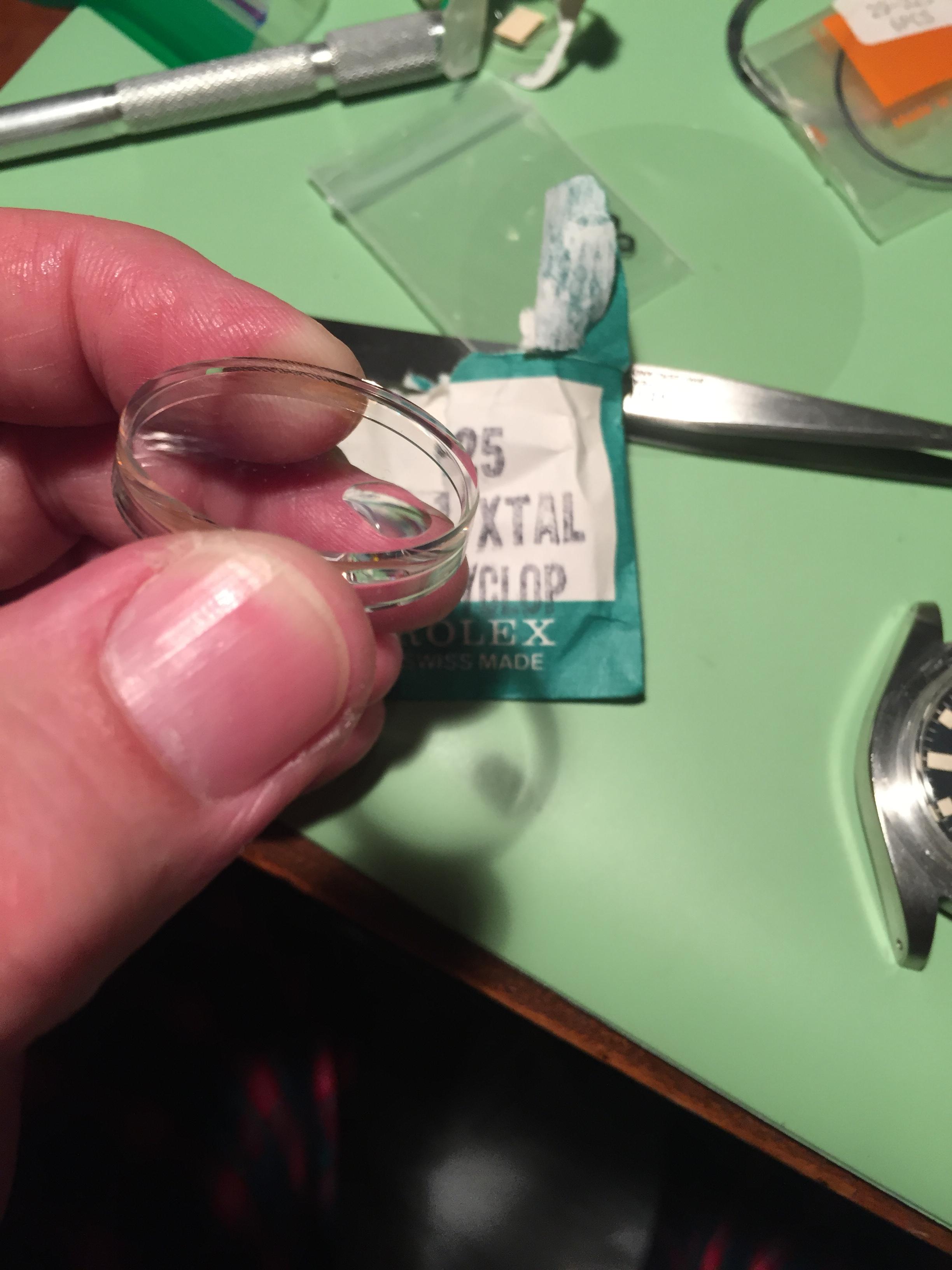

Now we finally set the crystal. A lot of guys set it earlier, getting the case “ready” ahead as it is a bit more “brute” than other watch work. The reason I wait is to set the crystal in perfect alignment with the date window. I use the loupe and ensure the top and bottom edge of the cyclops are parallel to the date window. Not a big deal but when it’s off, it’s annoying to me. I keep a scrap crystal on the case so I don’t ham fist the hand stack...
