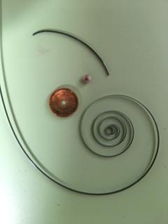

HI All
I'm a beginner asking lots of questions and I'm thankful for the replies.
This is an EB 1575N pin lever I bought for practice.  It's my first attempt at working on a mainspring.  Is this considered "set"?
Also, I plan to run it all through a Naptha clean in the ultrasonic.  At the moment, I only have two lubricants: Moebius 8000/4 oil and KT-22 grease.  Will either do for the spring?
Thanks
Charlie

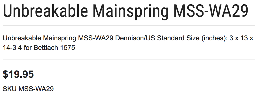

Its done...broken. You'll need to get a new one. Here is some info from Casker's material House to help you out. Maybe you can find a donor movement of a generic spring of  the same dimensions and end type.

Thanks!  I was just watching Mark's video on choosing a spring.
Do you think the 1575 and the 1575N have the same spring.  Mine is an automatic.
