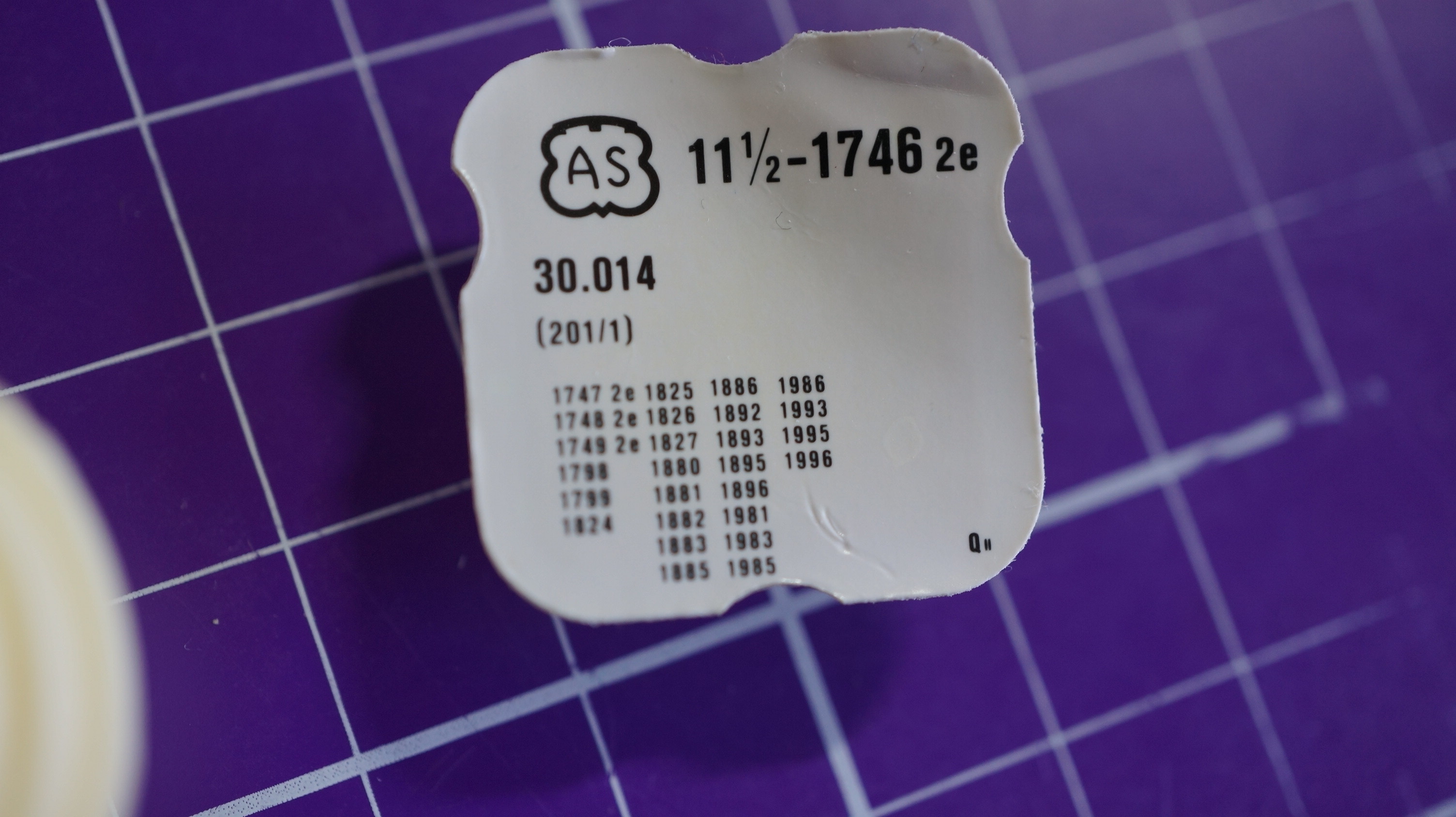

Wonder if you can tell me the difference between this two movements. Need a friction pinion for a AS1883 . Have an old  package where there has been a pinion in. says 17462e on this. But when searching cousinsuk it says friction pinion for intermidiate wheel AS1746. Just out of curiosity in wonder what is the difference between a AS 1746 and a 17462e movement? Can't find any info on google about the 17462e movement.

Ranfft only has the 1746 listed and no reference to "e"
http://www.ranfft.de/cgi-bin/bidfun-db.cgi?12&1archimedeshop&be0&2uswk&AS_1746

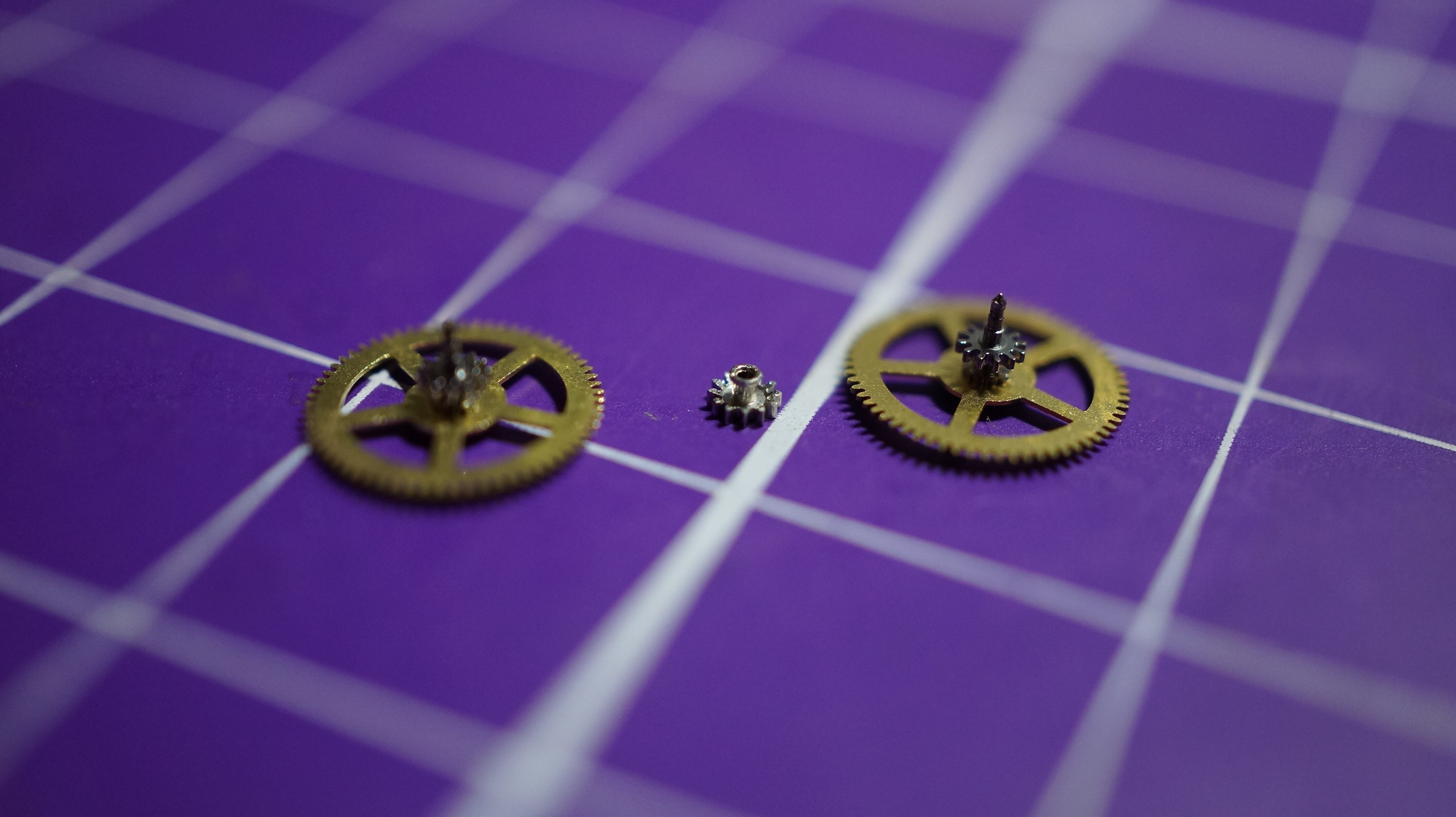

That is probably just the second edition they mean on the package . This is the wheels i have. Took a real close look in the microscope. Nothing i could see in the loupe. I could see they where worn. So have ordered a new set of wheels. The middle wheel you could call a cannon pinion? But is a friction pinion that do the same as a cannon minute pinion fitted in the middle . DSC09554.thumb.JPG.b80477b1a5b7dd94db64cb9c000658c0.JPGThis is the box for the intermidiate friction wheel. As you see it says 1746 2e  on it. But as far as i can see the 1746 has the same wheels. DSC09585.thumb.JPG.dd02eb877ddb229a9b251c535c863b3b.JPG
