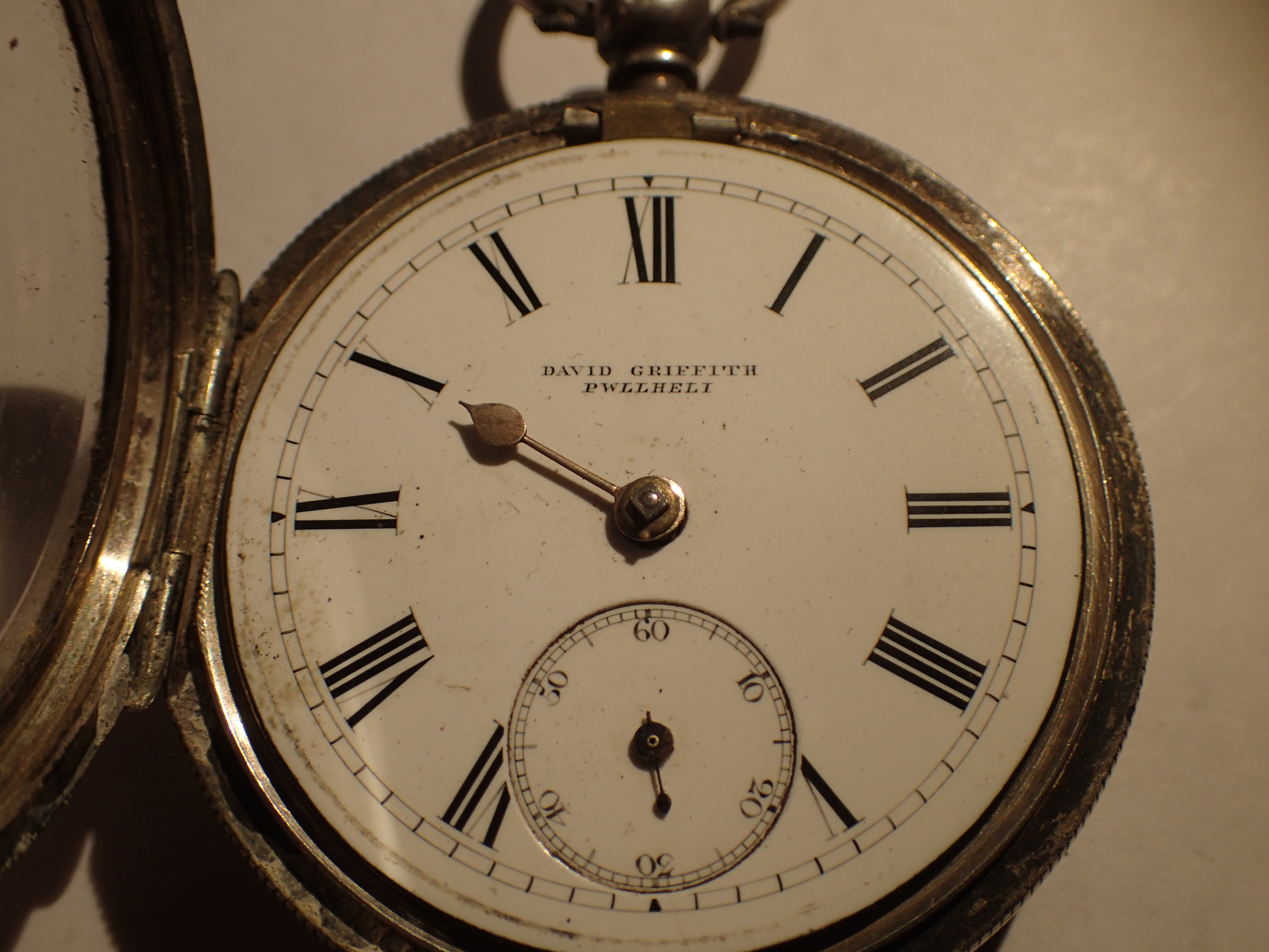

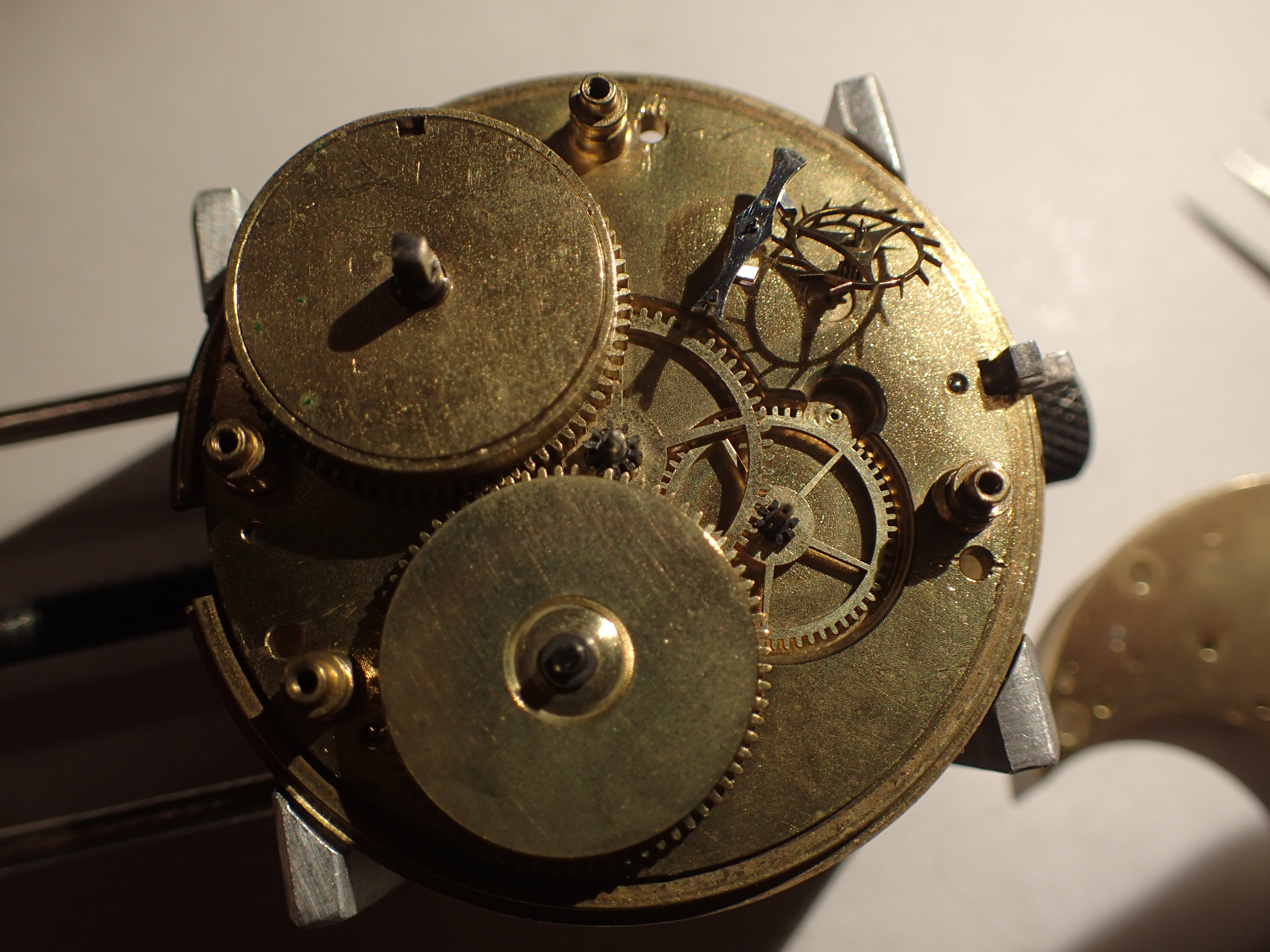

Bottom feeding of fleabay picked up what looked to be a fusee movement but isn't - where the fusee would be there is just a solid barrel. Did they ever convert fusee's or is this just one made from from old parts when the new technology appeared?
Anyhow, the mainspring was broken so stripped, cleaned and replaced the spring. Got it all back together with no sign of the fairy so I must be getting better (just jinxed myself but hey...)

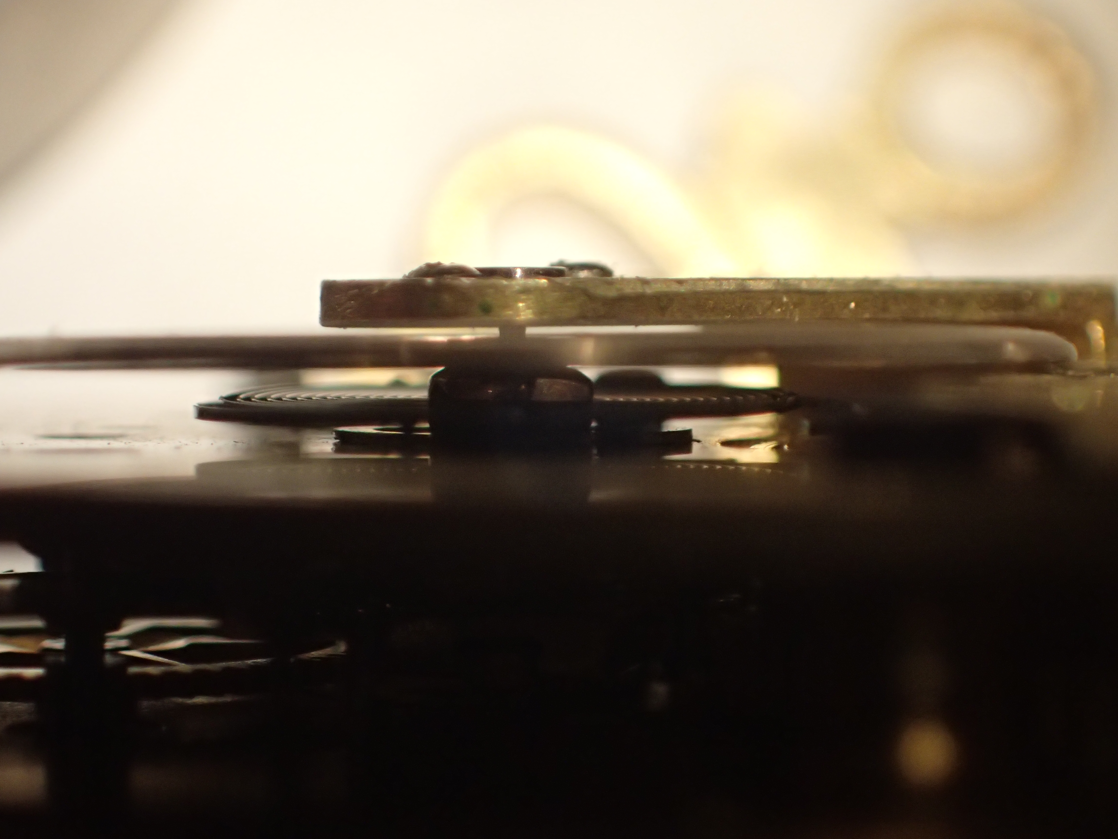

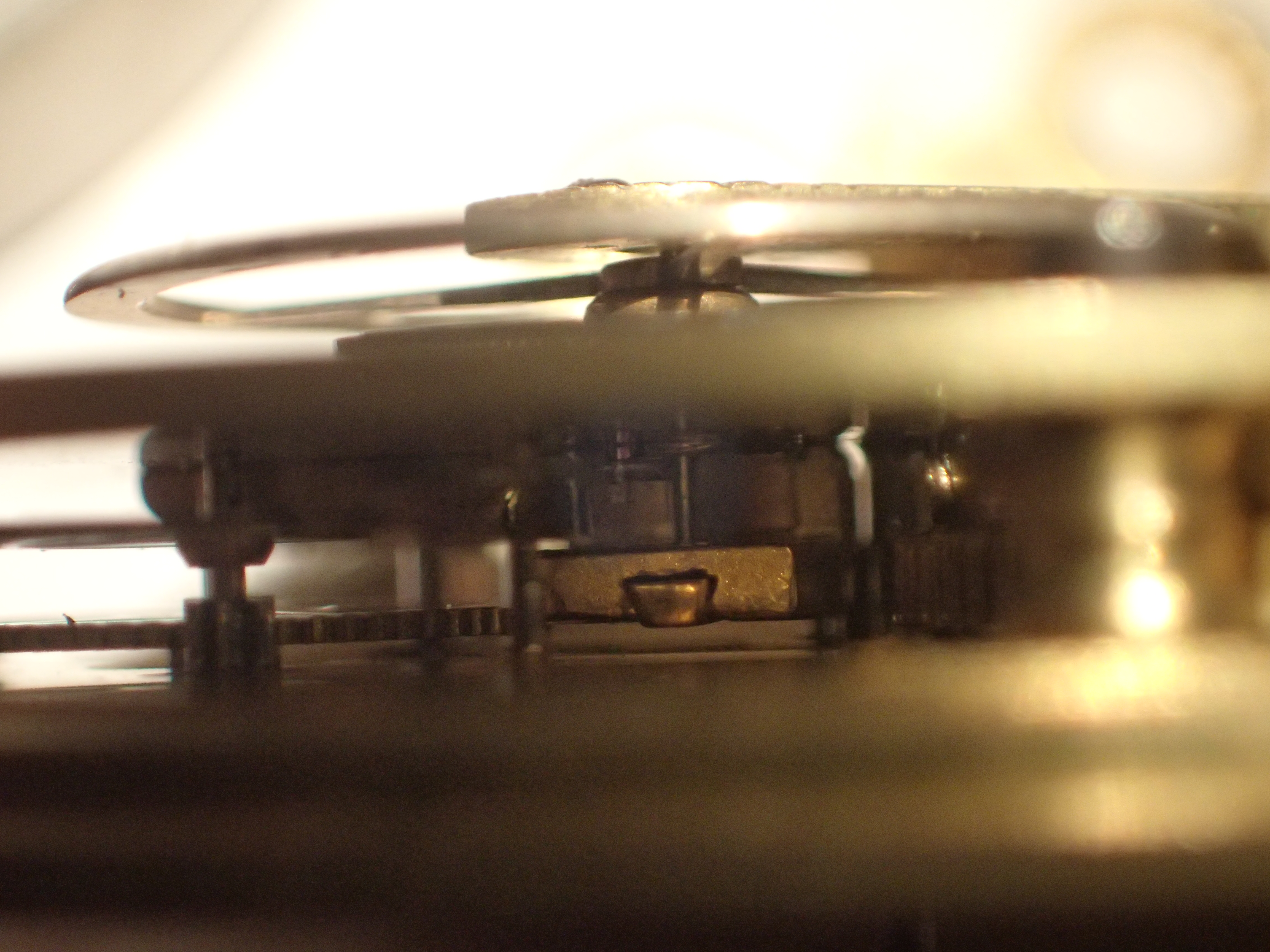

There's a problem with the balance, it seems to keep jamming. To me, it looks like the roller table is too low and fouling the escape lever, but before I wade in with the angle grinder I wanted to check and see what you all though? Is there something I'm missing?
Tried to photo it, but with that level of zoom I can't get the image stable enough, well lit enough or in focus to show the problem properly.
The hairspring is straight and not catching
That took a fair bit of manipulation to get right!
Here is a video of the problem
Will add a link to google photo when the whole bucket have uploaded...
Looking at the video, to me it looks like the balance is stiff and might not have enough end shake. Check all the jewels making sure there is no old oil still there. Check, all the pivots on the escapement for rough spots, they need to be spotless and burnished. Make sure the pallet stones are correct and not lose and clean. The roller pin needs to be smooth and not have rough edges and secure in the roller. Does the pallet fork look right? If you have removed and jewels make sure you have put them back right.

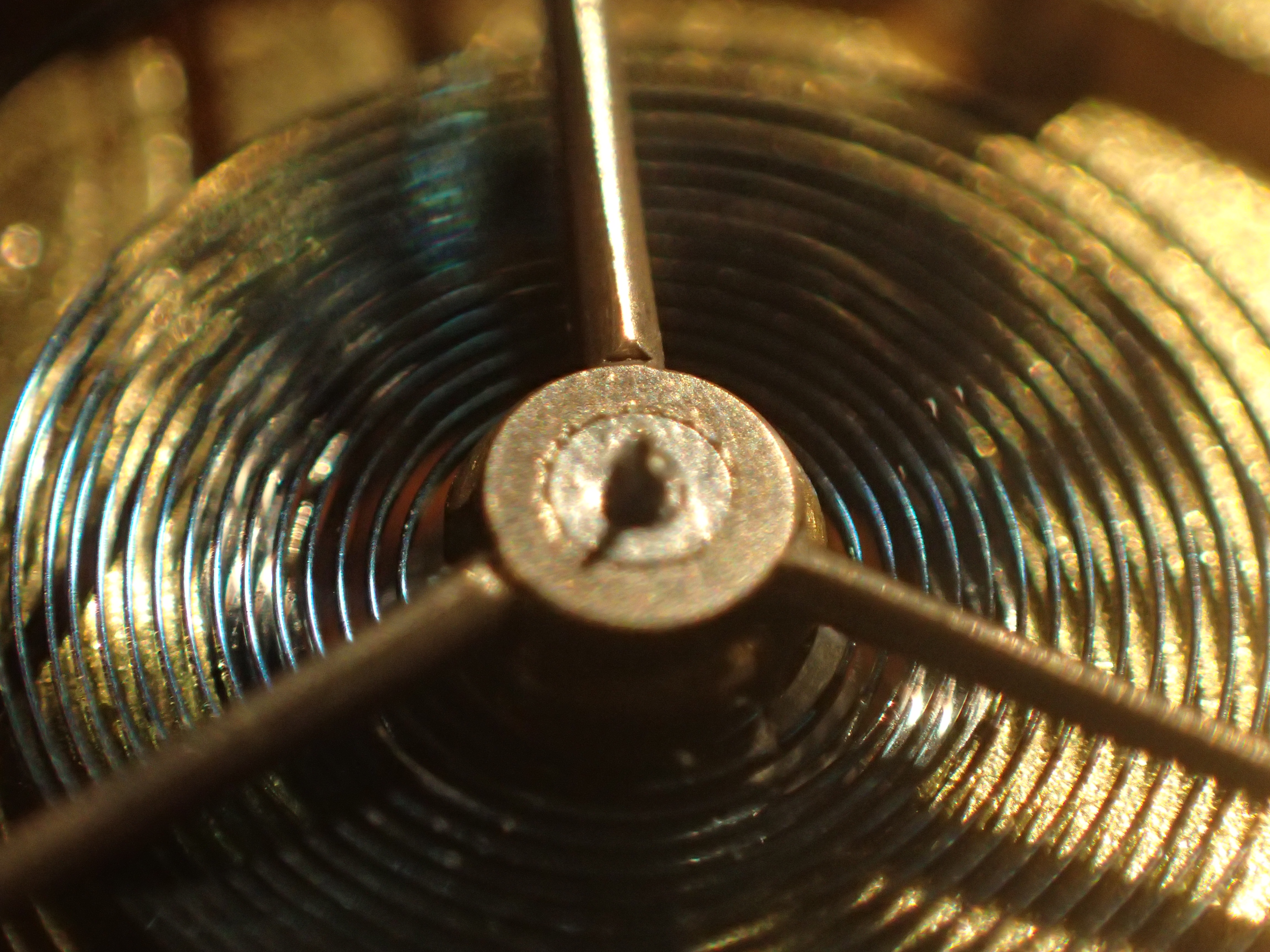

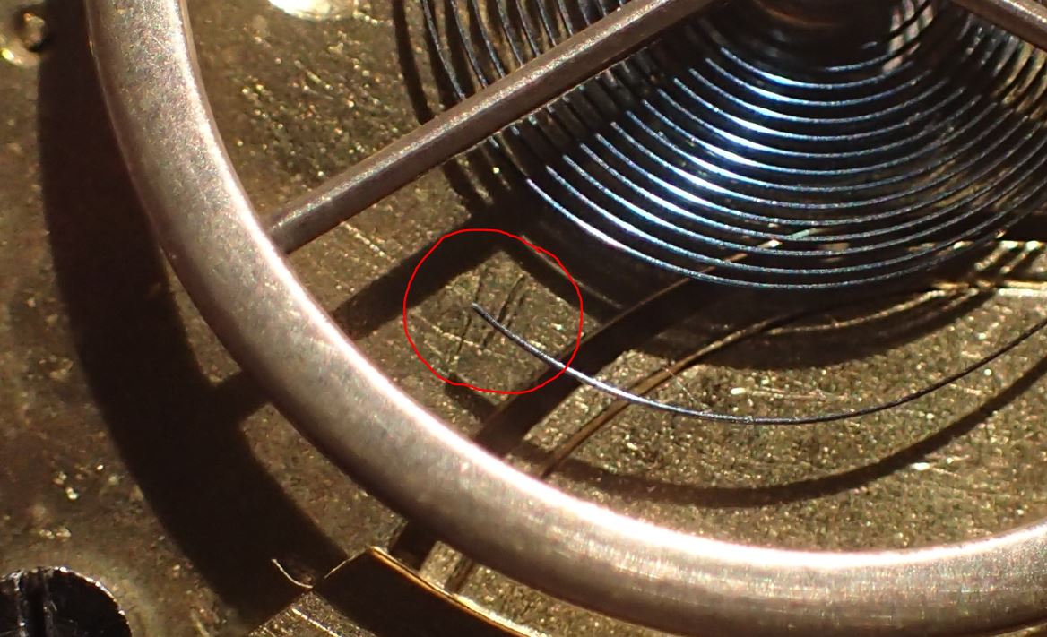

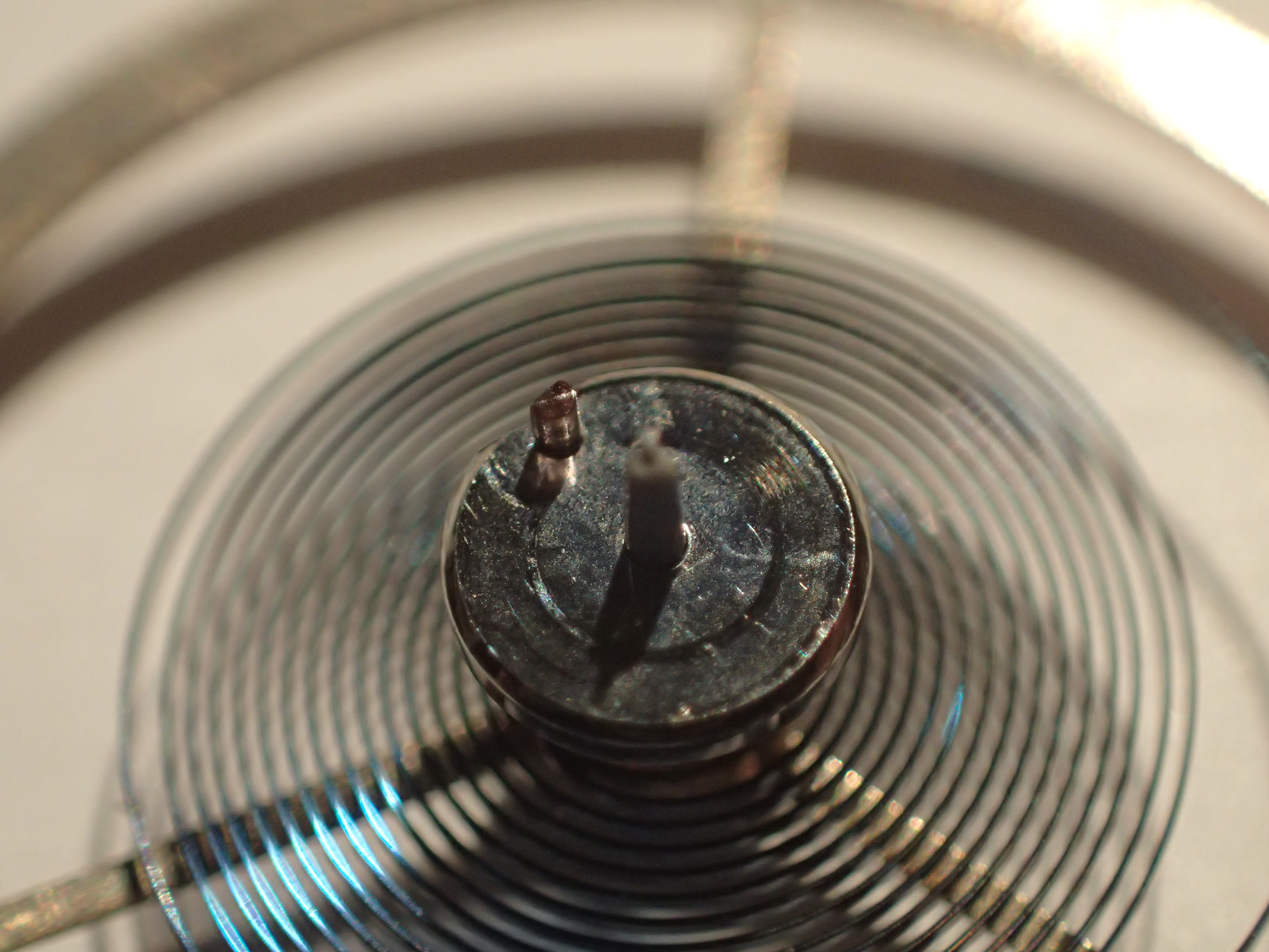

The wheel was definitely jamming - it would lock at a certain point. I realised in the end that the balance jewel was pointing in the wrong direction. The balance spring on this one is very long and held by a pin, so the rotation of the balance depends on where you pin the hairspring. Looking back at the photos I took I noticed these marks that aligned with the original position of the hairspring...
So I realigned the hairspring to match these. The balance jewel was almost aligned within the banking pins. A minor adjustment and bingo - aligned and no longer jamming.

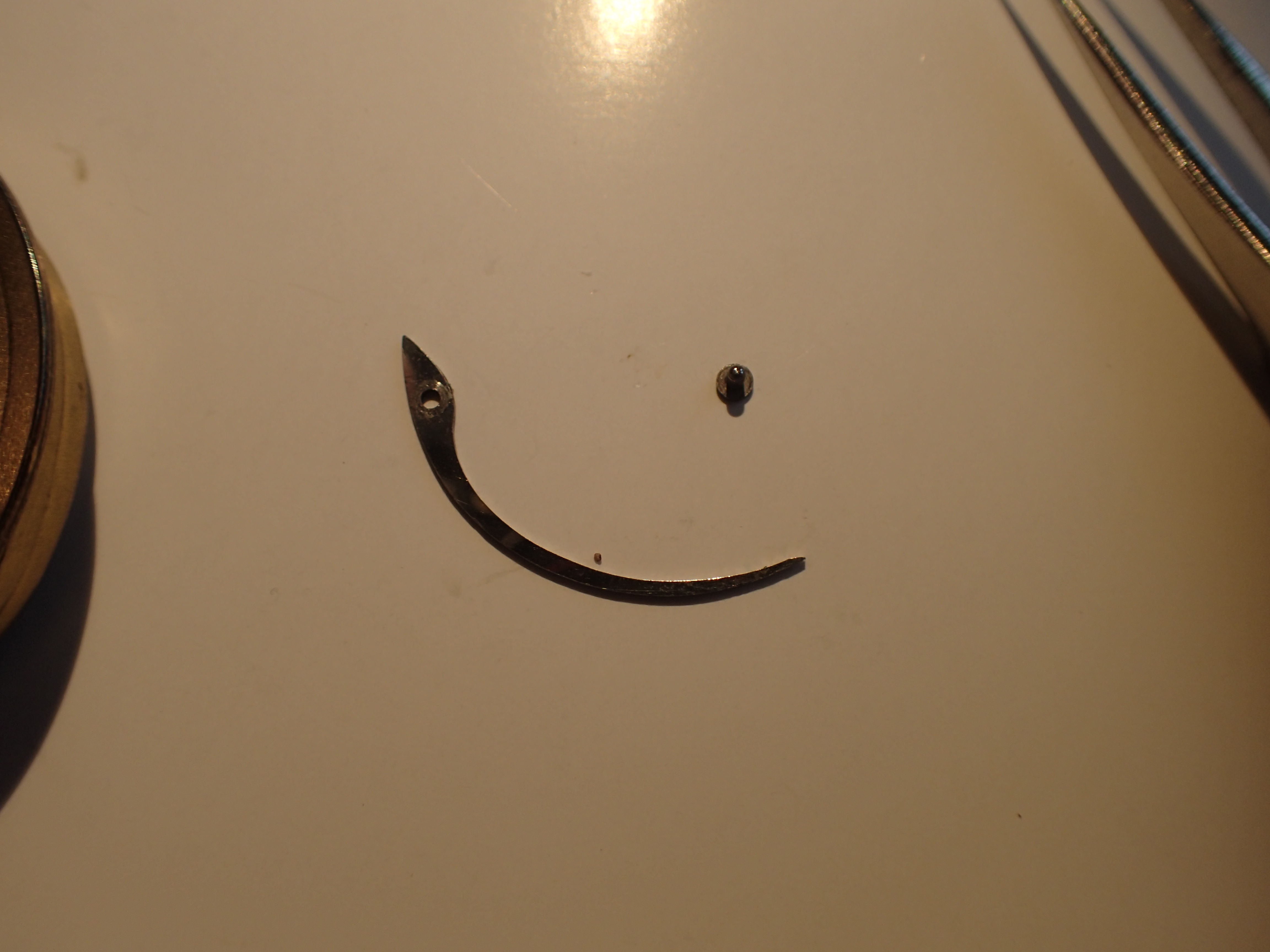

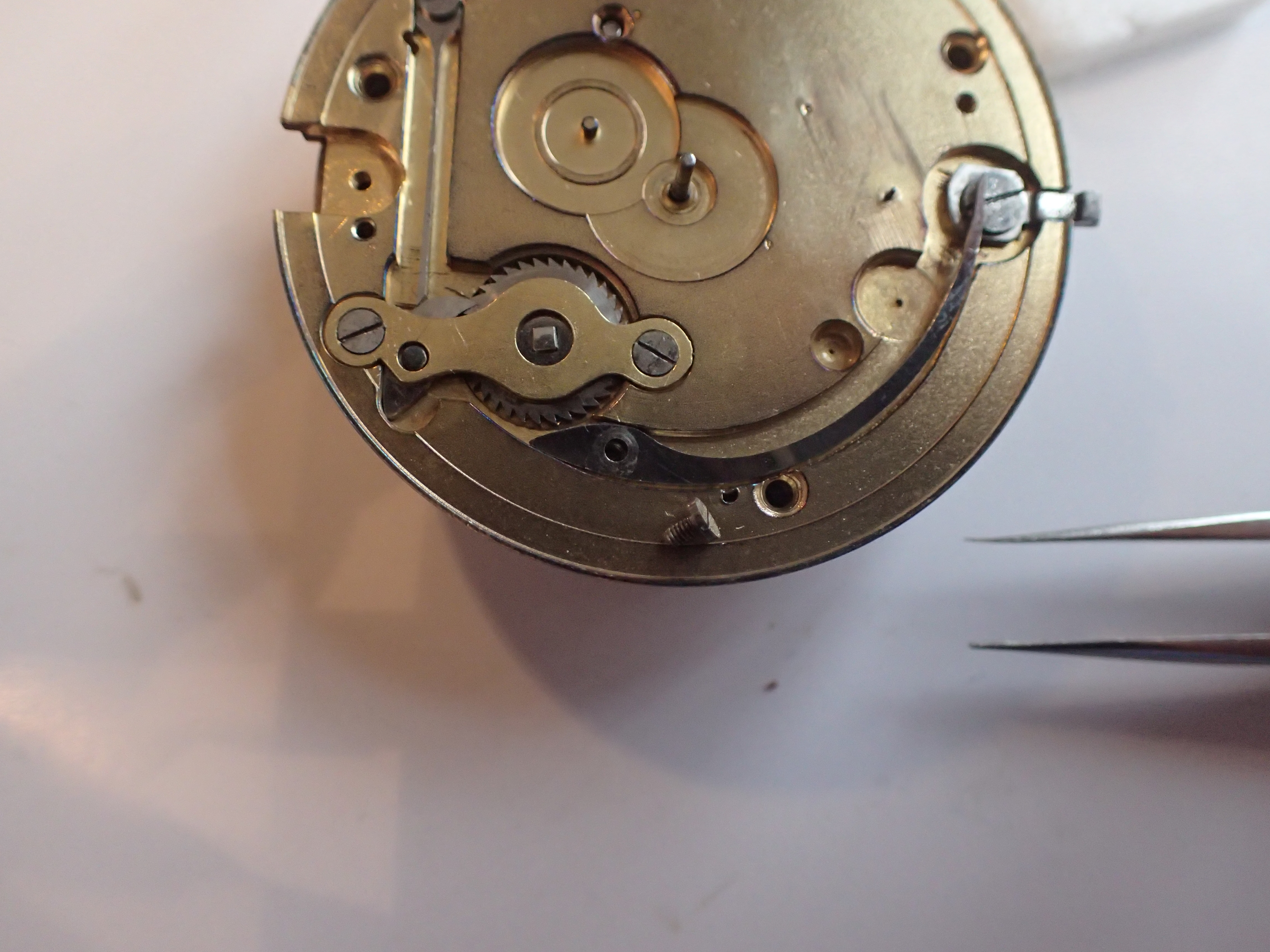

Now the only problem left is a frelling screw that doesn't fit.
It's the last one (I keep screws from the front separate from the rear). All the others are in correct but this one does not fit the hole that's left. Bloody watch is cursed!
Sigh. Not sure what to do now. I don't want to force the screw. I can't see where it would have been mixed up with. The two holding the click wheel have tapered heads and the on holding the other spring is identical to this one!
