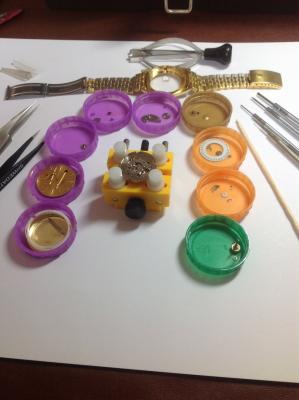

Ok it was a copy and bought in Spain or Greece for the equivalent of about £10.00.  It does (did) work however, but the date would not turn either with the winder or at the end of the day so he gave it to me to fix (?).  I thought I would inspect it at length and the wise heads always say start with something of little value so here it is. Have not been able to decide why the date would not turn so started trawling through Marks videos and stripping it down at the same time seemed like it would be fun so what the hell.  Took pictures before and after each bit came off so heres hoping.

The relevance of the different coloured trays is Semi Skimmed, One Percent and Skimmed - cost nowt and works for me.

Finished with the fake Rolex. Stripped down, cleaned, broken bits for the calendar change replaced from another broken fake which seems to have been a just about identical movement, oiled and greased and to my amazement it worked.  Can't help but wish it was a decent watch considering all the work but it was my first mechanical auto movement and I did learn quite a bit from the exercise.
It was astonishing how poor the workmanship  was. Inside there were metal shavings all over the place and yet it worked when bought.  There was next to no lubrication in the watch and it appears it could have been put together dry.  No identifying marks but I am pretty sure it was a Chinese ST6 type used in loads of fakes as I was able to find a tear down of one used in a fake Omega.

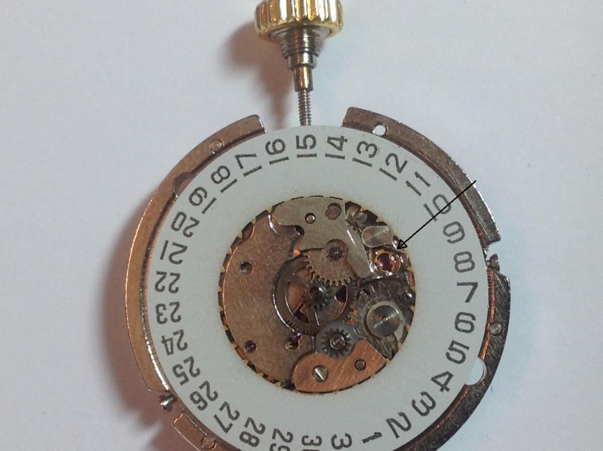

One thing that puzzled me was the spring I have arrowed from step 10.  It was not in the watch I worked on and I could not see where it came from in the dismantling process either.  Needless to say it is not in the watch that is still ticking away after 24 hours on its first wind so I must assume the watch in the guidance was slightly different to the fake rolex movement I worked on.  I am curious however, so if you come across it can you advise me what its from.  The one next to it is from the calendar wheel.  It may be a spring for the lever if so it is definitely different from mine which was the more traditional U shape.

I know what you mean but the spring at its right in that pic is the date jump I have arrowed it in the pic below and you can just make out the flag shape at the top end which I was fiddling about with to get it to locate in the groove behind the screw. I finally gave up and took the calendar wheel off then located the flag end before putting the calendar back on then the other end of the spring was much easier to put into the calendar teeth - I won't make that mistake again.  I have looked around for the lever spring the same U shape as the one I fitted without success so by default thats my best guess - odd though as all other parts are identical to the two watches I had.

Hi Vich, it is definitely a date spring as Geo and frenchie said. On a lighter side, to explain the guide's contradiction, I started to think it was a fake ST6 made by Rolex to pretend it was a Chinese fake...no I haven't had too many beers yet! :)
