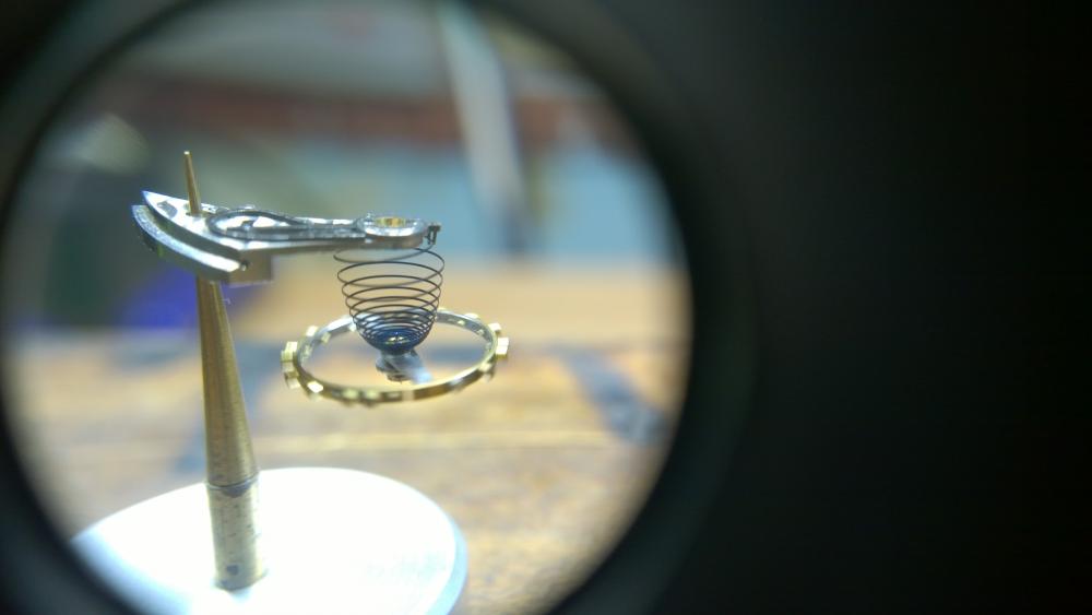

Hi all, I'm a bit confused as to why the beat error is so far out when the pallet fork is dead center to the banking pins and the balance is at rest under no tension, can someone please explain.
thanks kaz
Ps I can't seem to regulate the rate neither,I have demagnetize it three times and the hair spring isn't touching the cock neither.

That overcoil is a bit strange. Can You please make a new picture  from a drifferent angle?
what 90 deg

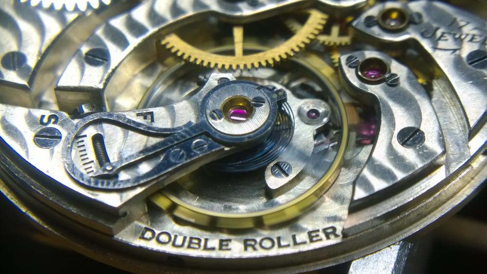

I think beat error is your least problem at the moment. 5ms can be better, but is not an issue.
No wonder regulating is difficult: your hairspring is not concentric in the pins area, and it has a kink at the regulator pins. Also the pins are too wide apart, space must be minimal here (unfortunately this will speed up the rate).
Yes, as mentioned before, amplitude is much too low (which esc. angle did you choose?)

Hi,
the kink I see in your 2nd picture, maybe I am wrong.
Pins are better, but still not close enough - and they should be parallel. Difficult with these rather thick pins, I know. But these are subtleties that you can fix later.
Main issue is the low amplitude.
52° is ok for nearly all wrist watches. Pocket watches have smaller angles, about 40°. Bad news: Your amplitude is probably 20% lower than your display shows, as the esc. angle was set too high.

The beat error on your watch will have to be adjusted by moving the hairspring collet & Mark has a vid on this. The rate is adjusted buy in effect shortening or lengthening the hairspring. This works by the spring vibrating in-between the regulating pins so if the rate is not changing then the spring is not in-between the pins. It is worth noting that at rest the hairspring should be in the middle of the regulating pins & not touching them.
PS. Looking at your pics there does not seem a lot wrong with the hairspring shape. Another thought is it a new hairspring fitted ? if so it could be too short.

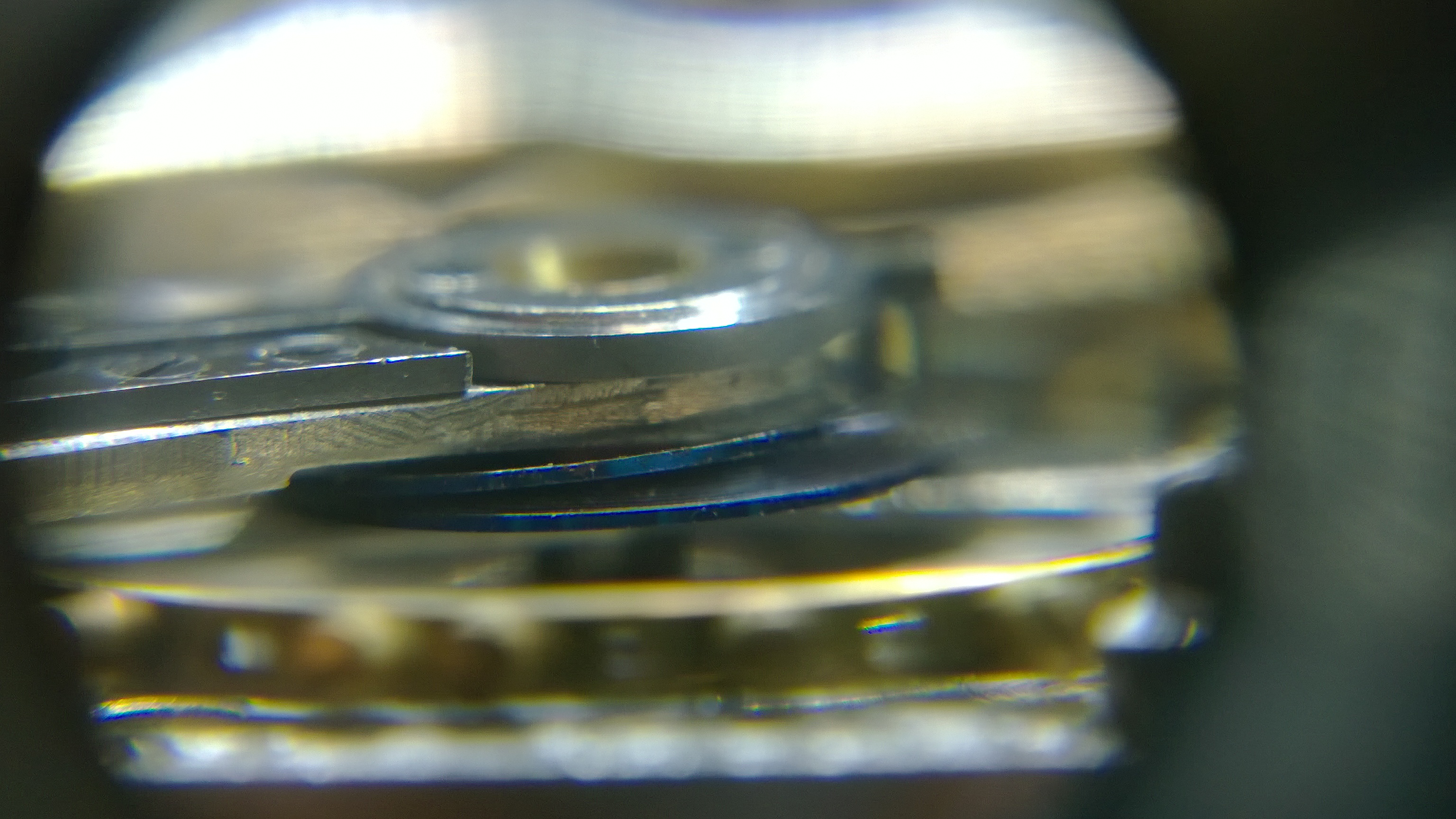

It seemed to me that the overcoil is higher at the regulating pins than the stud. This wont allow the overcoil to wobble between the pins and bend the hairspring. Try to elevate the stud a bit.
Check also again that the overcoil is not touching the cock. Just twist the balance to ~300 deg. amplitude with a toothpick. This is suspicious, since YOu have both low amplitude and beat error despite the properly positioned impulse jewel.

you are correct changing the lift angle made absolutely no effect but what I have done is closed the pins in a bit more and I had the train bridge to tight so slackened it off and the amplitude has now shot up.
also I straightened up the spring from the pins to the stud so I am now thinking how to get the rate down and I is definitely not touching the cock, but it is getting better and it is still the original hairspring.

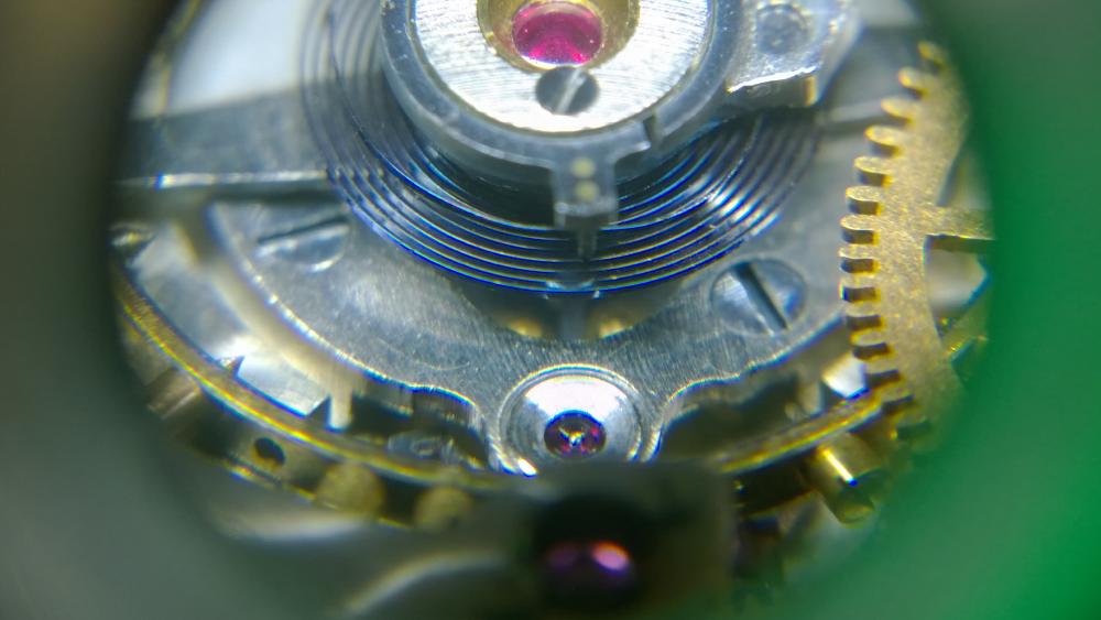

I think I have found the problem, if you look at the hairspring at three o'clock the spring is touching what do you think.

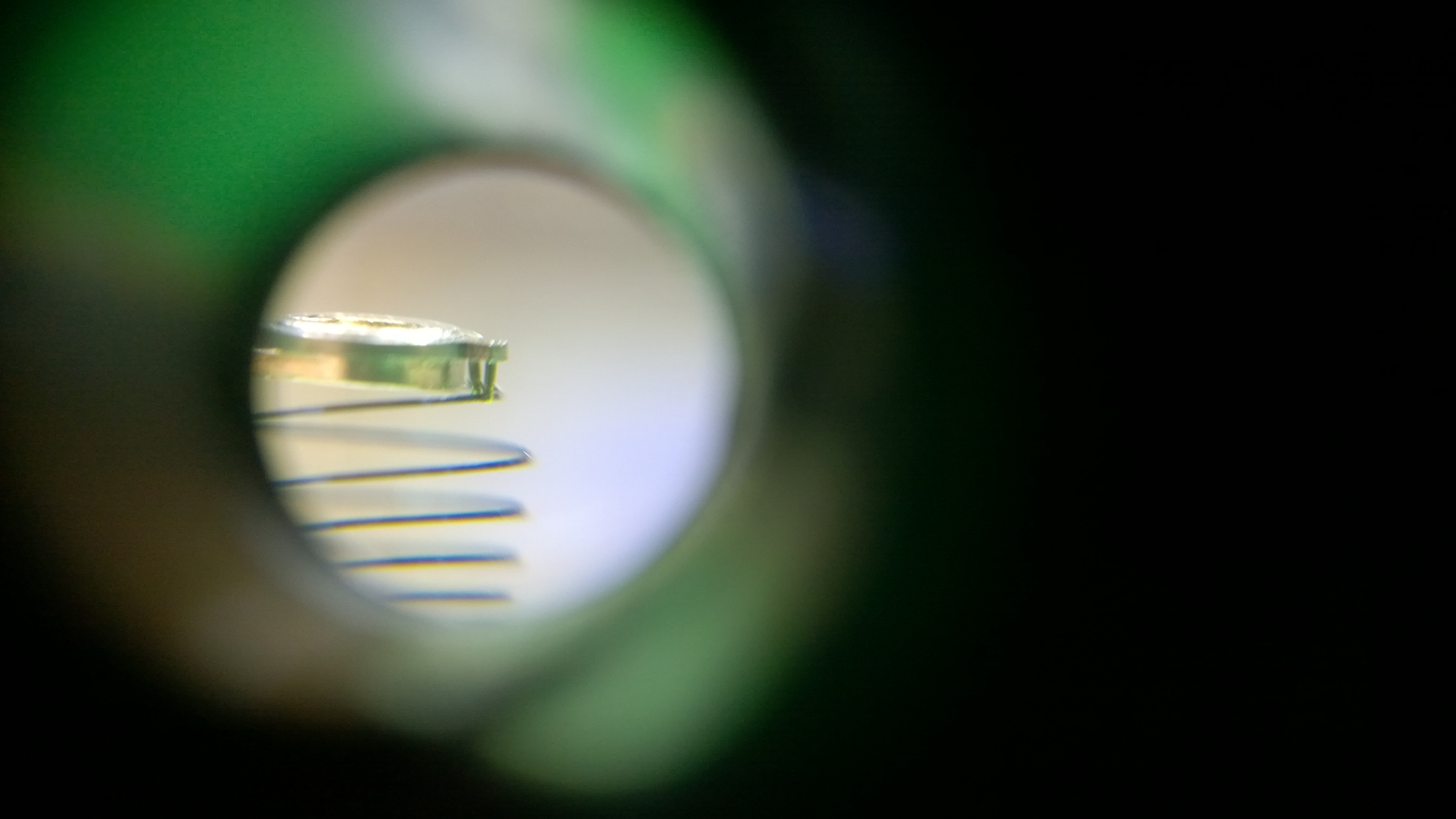

here is a bit better pic look at the overcoil at 12 o'clock looks a bit flat and not concentric.
