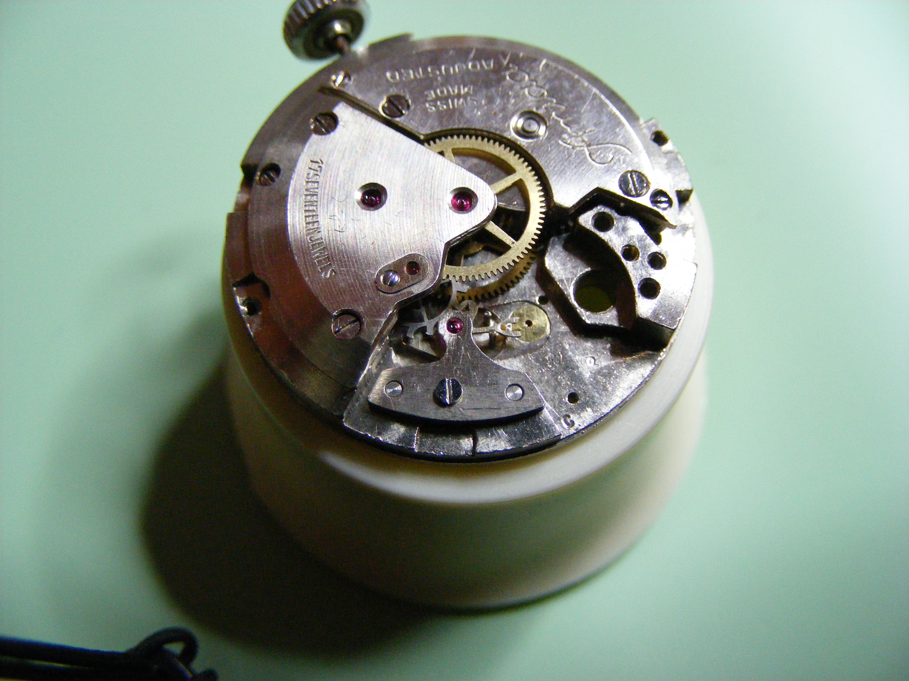

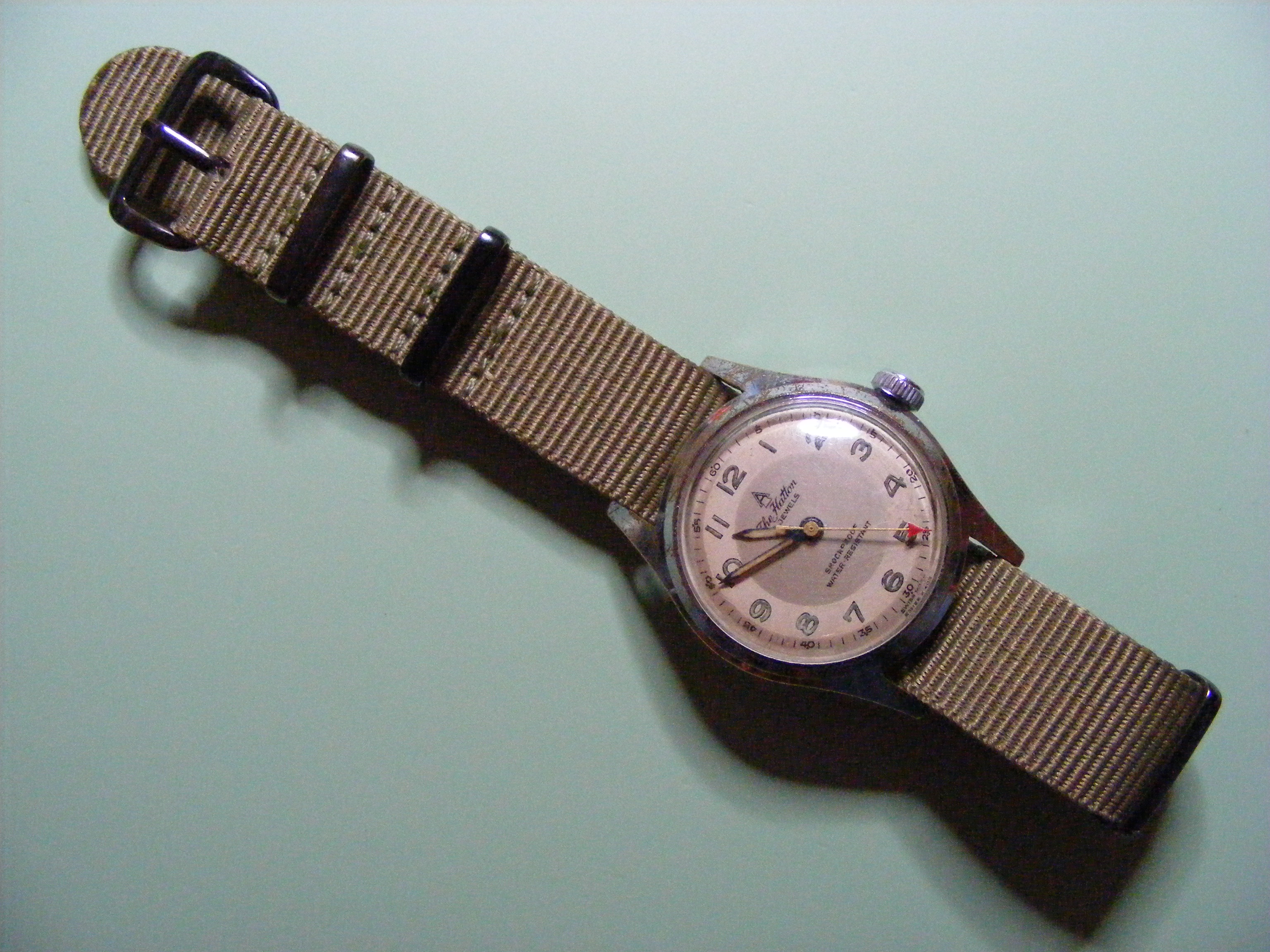

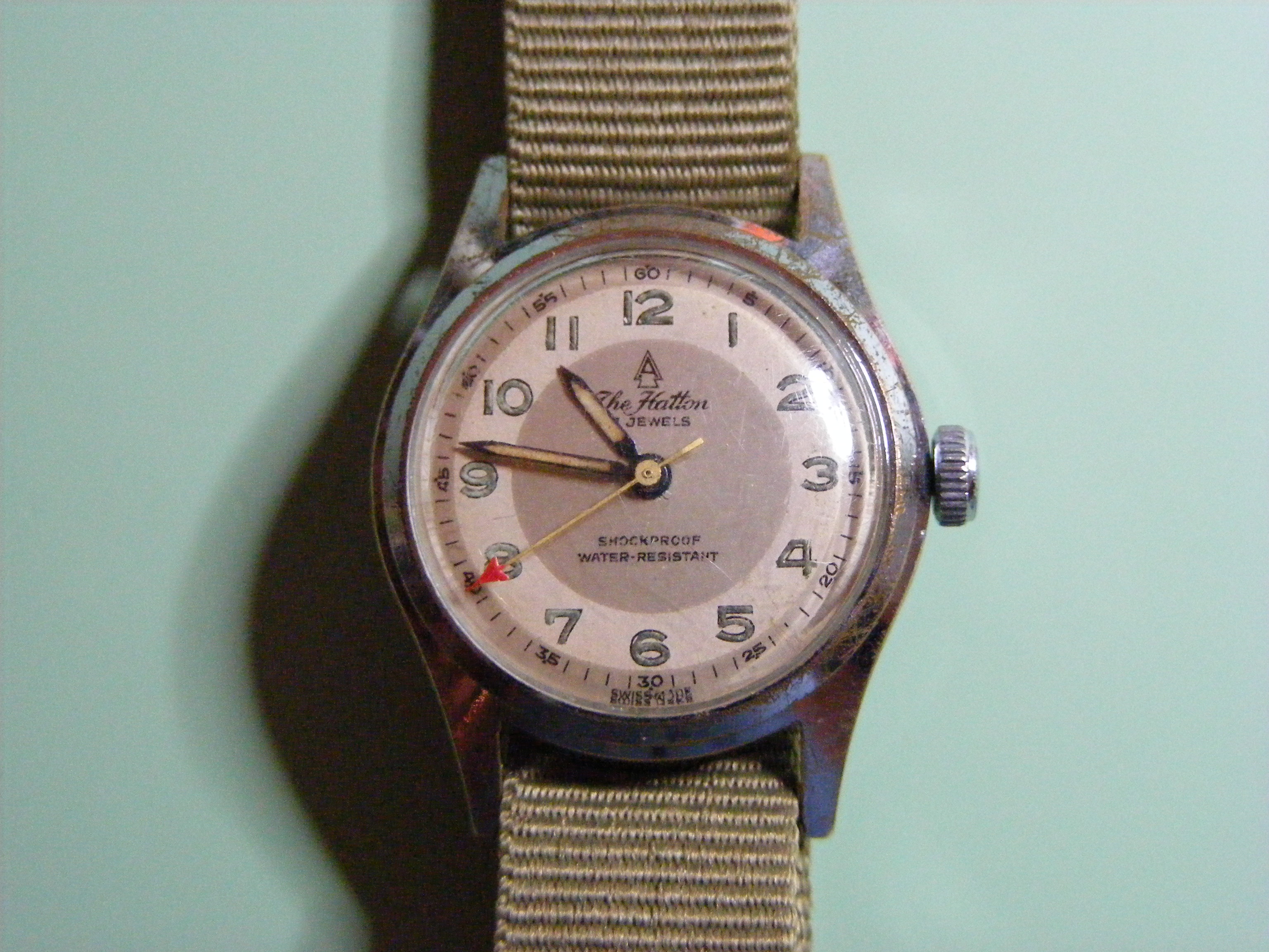

I bought this on ebay a few weeks ago £3.10   '' not running spares or repair ''DSCF5203.JPG

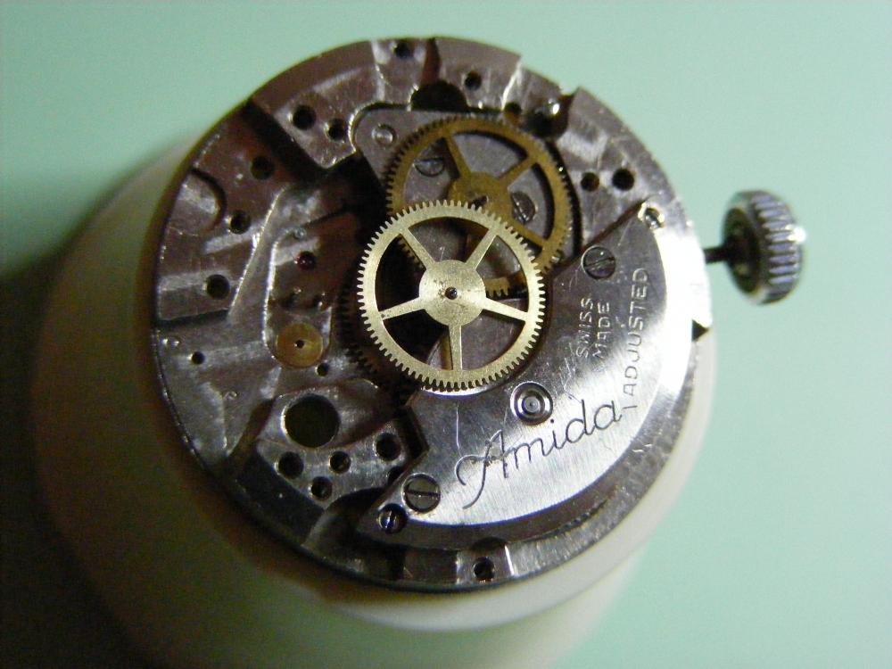

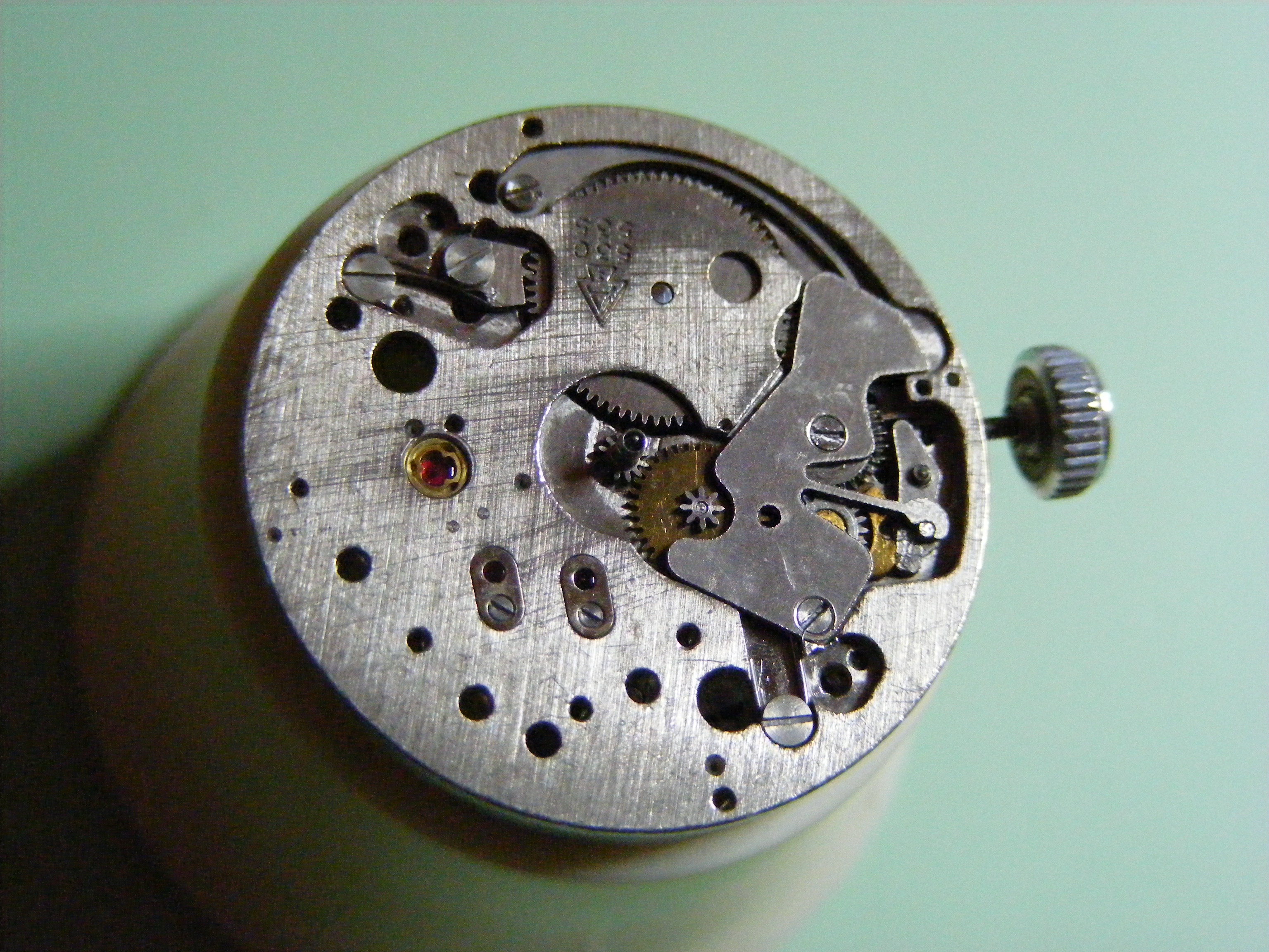

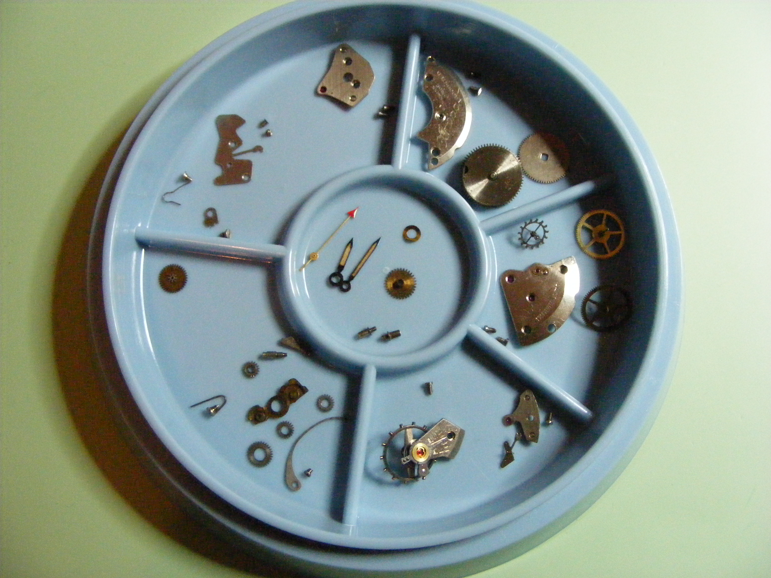

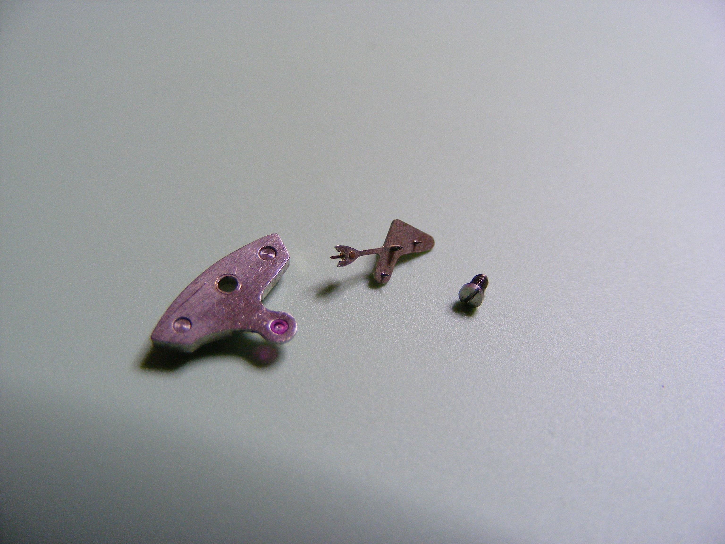

I got a bit engrossed and forgot to take photo's of the interesting bits but there were a few potential flyers on this side !DSCF5392.JPGDSCF5394.JPGDSCF5396.JPGDSCF5397.JPG
    There were some previous repair dates scratched inside the back, difficult to read them all but one was dated 1956.

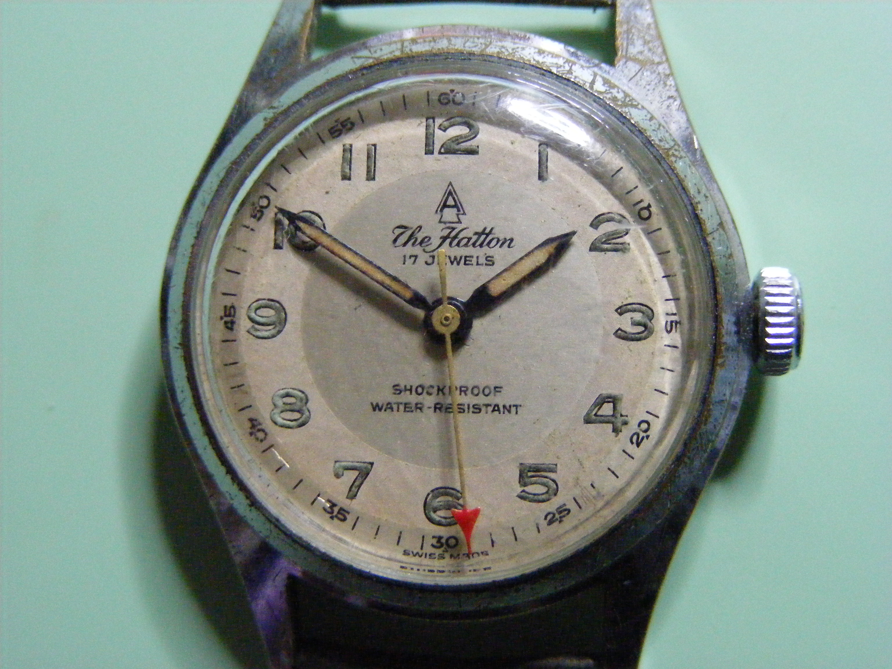

  Running nicely now, it's been my watch of the day today  : )
What an interesting piece!  A seventeen jewel pin pallet movement.  That's something you won't see everyday.  I think it's fantastic.  :)
