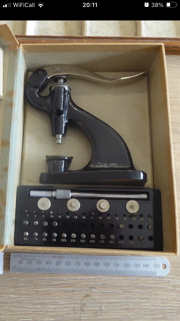

I have no info on it, although I have seen a few online in historical auction sales. I’ve not purchased one of these for restoration work yet. Looks like a really nice and solid set.  Would be fun to bring it back to life and fill it up the way it was new.

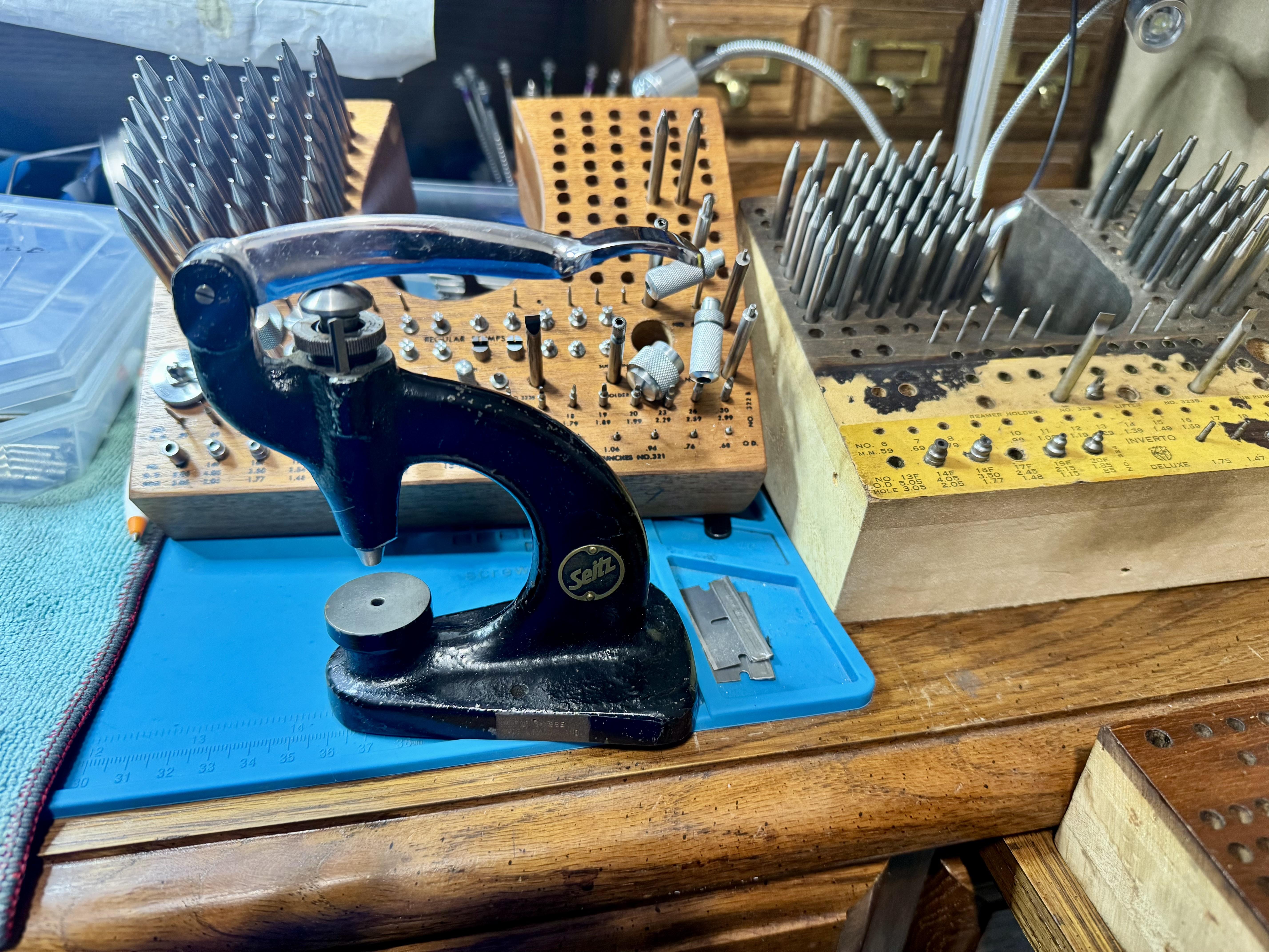

  I wonder if it’s made by Hugo Maihak the German engineer ? Reminds me of one of my older Seitz Jeweling set anvils.
Also makes me wonder if the Seitz parts will fit that set ? I have several of the 3mm and 4mm models
  Nice find for sure
  Nice find for sure
It does look similar, as far as I can tell it’s German I think probably Hugo Maihak as well. I am really hoping it does fit Seitz. Otherwise I’ve got another project 😂
17 minutes ago, AndyGSi said:
clone of the Seitz
It actually looks like one of the earliest versions where it's made out of cast iron in other words it's very heavy. Versus the later generation that was made out of some other material and hollow.
I guess you assume they have a standard?
C they do have a standard either three or 4 mm. Fortunately I think all the reamers are of one size and that's the most likely thing to break so that won't be an issue.
I was watching that one, but noticed quite a few pieces missing.
I decided to give it a go. With the hope I can replace the missing pieces. Fingers crossed 🤞
