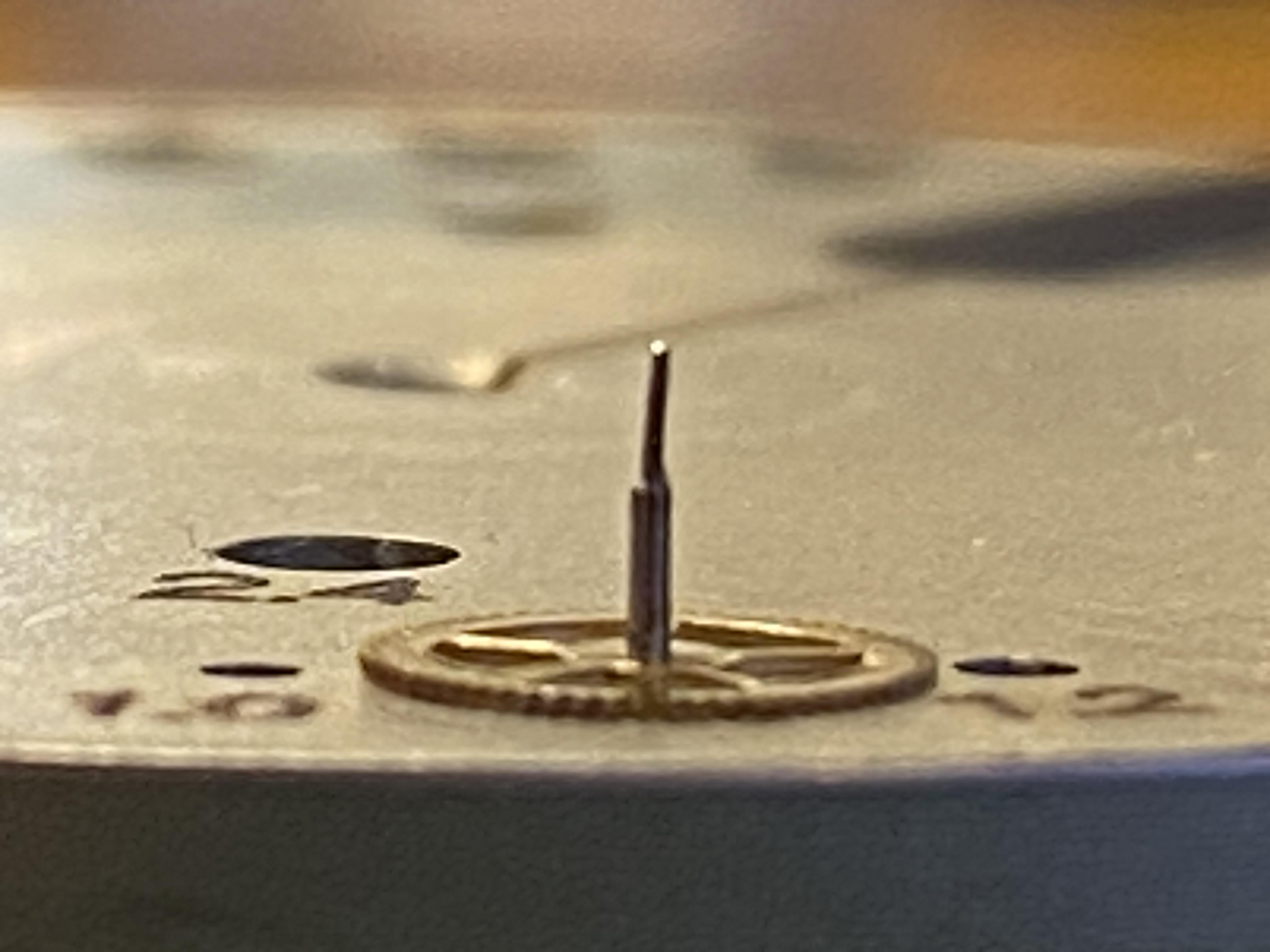

The pivot on this fourth wheel is bent and I was wondering if there is any way to straighten it?
Full disclosure - I think I did this taking it apart when I caught it on the movement holder when turning the movement over 😢
The movement does run, and it is possible to fit the seconds hand, but I imagine this is going to create all kinds of friction in the movement.
The fourth wheel is not jewelled on this movement.

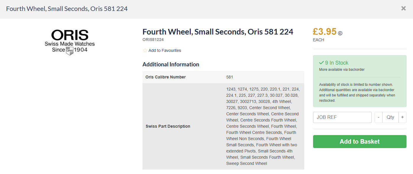

First question would be could you get a replacement if it snapped?
Yes you should be able to straighten it but need to be careful.
I've found the best way is with a long piece of tube having a similar I/D to the O/D of the pivot.

Probably - the movement is an old Oris 581 kif, so not rare or valuable, but I must say don’t see many of these on eBay. I see lots of other vintage oris calibres but I don’t know if any of the parts would be compatible.
Is it possible to look up which Oris movements might have a compatible fourth wheel anywhere?
Thanks I think it’s worth a try. Can you suggest what type of tube might be useful for doing this?  I thought about trying a pin vice but that seems a bit clumsy.
Its risky but sometimes do-able.
I showed a technique in one of my old videos...
Go to 0:46 (46 seconds in)..
Be very careful
Hope that helps.
They're available from Cousins but appear to be a one movement only part.
I've got a selection of stainless steel tube.
You'll also need to support the other part of the shaft to make sure you're only bending the pinion.
