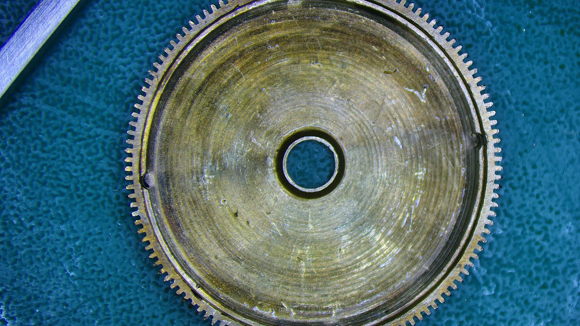

Looking at the picture below of the barrel and the hook on the end of the spring, has it been fitted with the wrong spring, or is somthing missing.
What should the end look like so I know what to look for in a replacement.

You have a Roskopf type movement. Though cheap, they are not the best choice for beginners, as they differ in many details from normal (i.e. better quality) movements.
Your mainspring is meant to slip, from notch to notch in the wall. I doubt however, the spring end is correct.

Some old pin pallet movements used a sort of precursor to the slipping bridle in automatic watches. I guess as a remedy for overzealous winding- these tend to have unusually long and strong springs. There should be another piece that the end of your spring catches, it would be about 3x the barrel diameter in length. Most likely lost by the person who put the spring in upside down.
A regular spring should catch in one of the notches and work, trick is finding one long and strong enough. Sometimes with these you have to settle for reduced power reserve from a shorter spring.

The teeth on the barrel appear to be damaged - could that be part of the problem?
Can you post photos of the full movement?
Its not as bad as it looks in the photo, only the very edge is missing, forming a slight shamfore, 90% of the teeth is still there.
Sorry can't post pictures of the full movement or the keyless side as its currently back in bits to get the barrel out again.
Thanks for the replies, so looks like this first one is destined for the junk pile as I have little to no chance of finding the missing bit.
