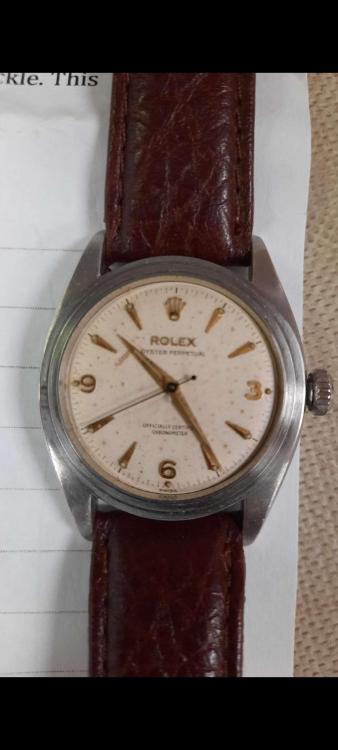

I received the watch today.  My first step was to make measurements.  Here they are.
Here is an image of this model watch retrieved from ebay
Here is my sketch of the bezel profile that I need to make.  No dimensions yet as I am pondering that.
Question:
Should the bezel grip the crystal?  The crystal is already gripping a lip of the case.
Here is a prototype I 3d printed just to get a sense of what i am dealing with
Edited by LittleWatchShop
My drawings are not to scale, BTW.
Here is the FreeCAD illustration of what was printed. It has been very helpful to hold the printed bezel in my hand to get a sense of scale.
My plan over the next few days is to get some fender washers. They come in a nearly ideal thickness and and OD that is close to what I want.
I will make a precision arbor to hold the washer in my lathe to turn the outside dimension.
Still pondering the best strategy for the inside cut.

I have pondered such a plan. The unfortunate aspect of my 3d printing is accuracy. Not so great. So if I print something that works, I am almost guaranteed that the dimensions are not what was drawn. My purpose, even if inaccurate, was just to get a feel for the fit.
I will look in to these service providers, though.
Bear in mind, however, that part of the joy (if not all of it) is solving this myself. Otherwise, I just go mow the lawn or split wood or some other mundane task.
