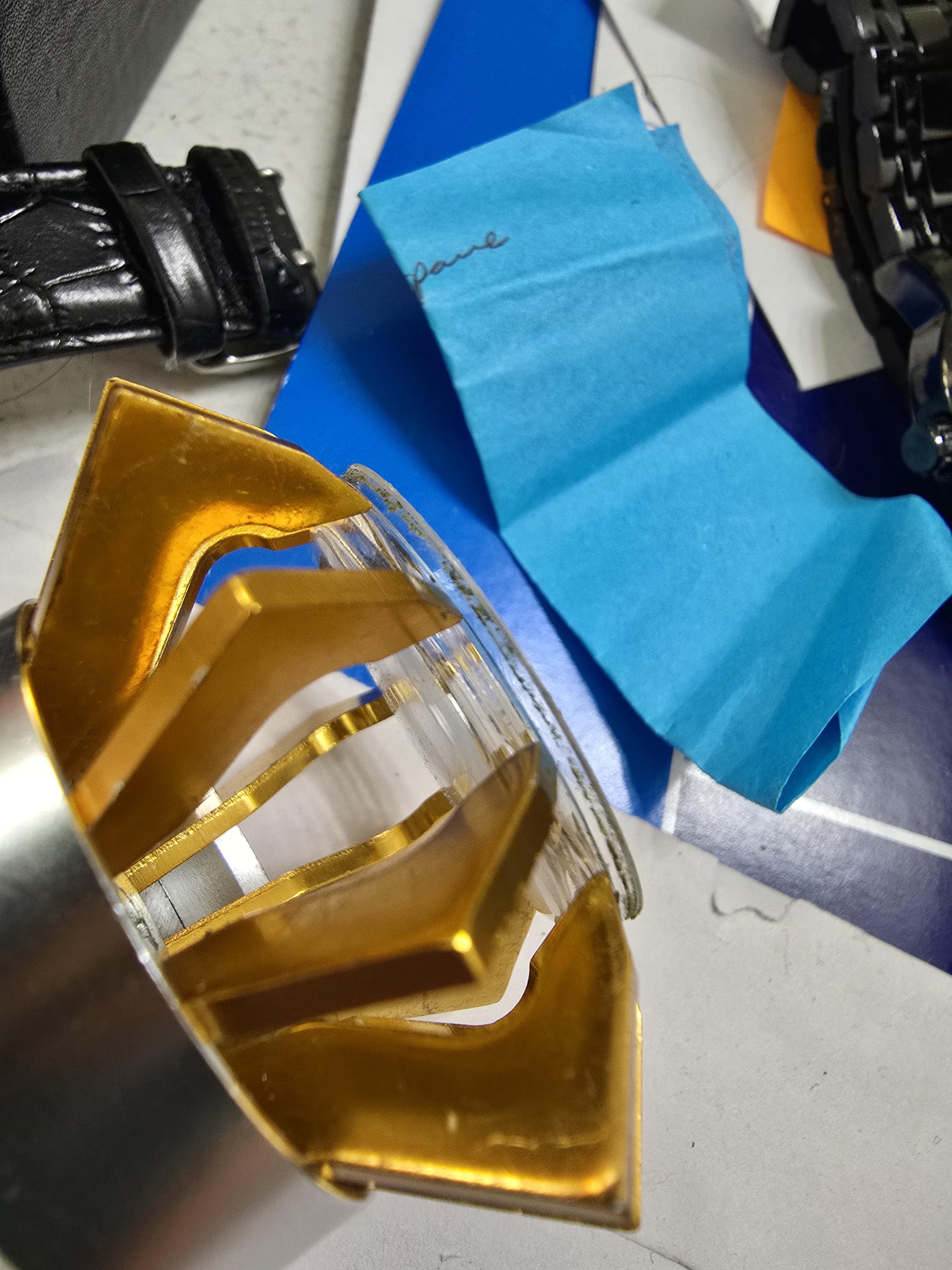

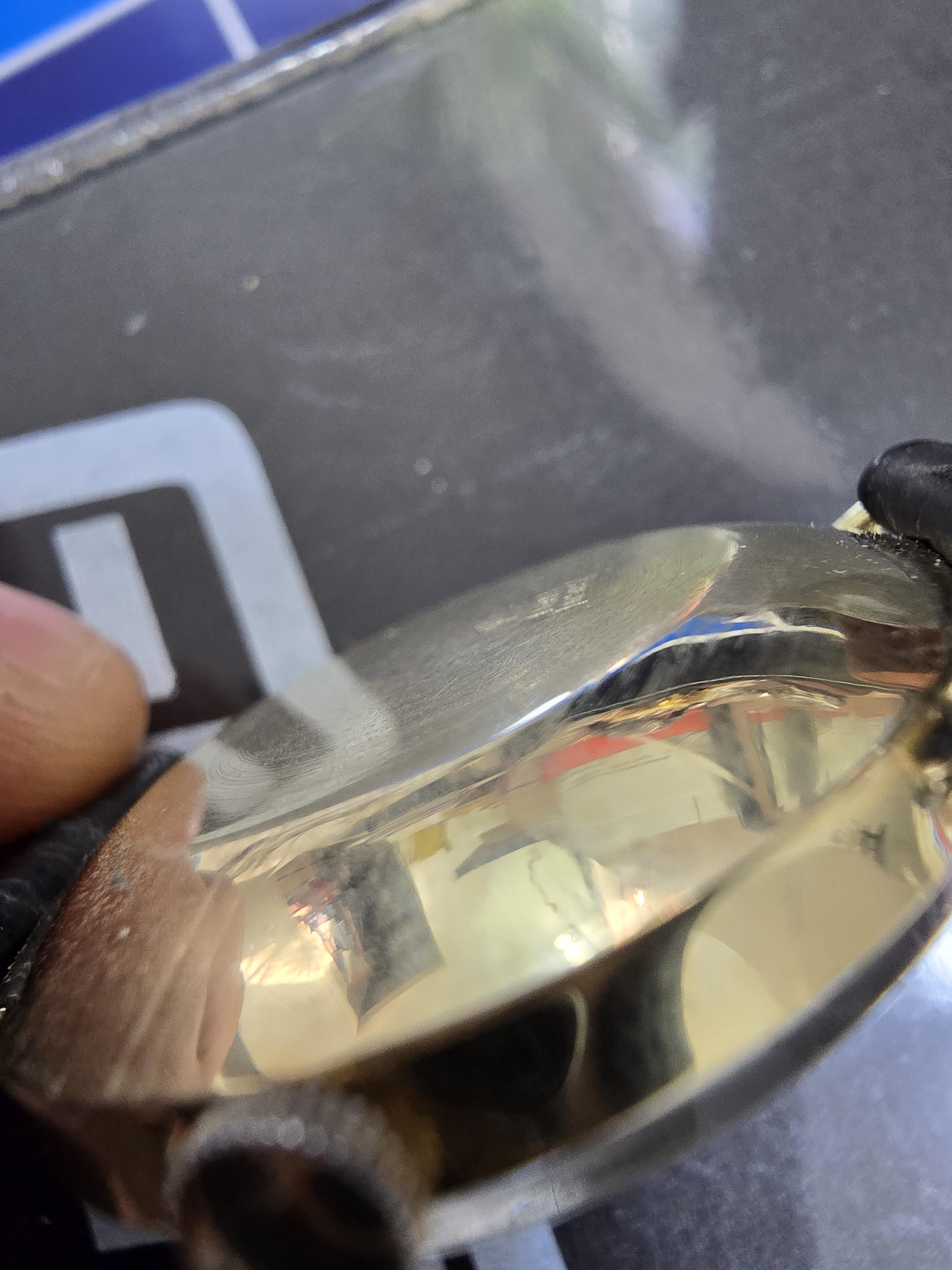

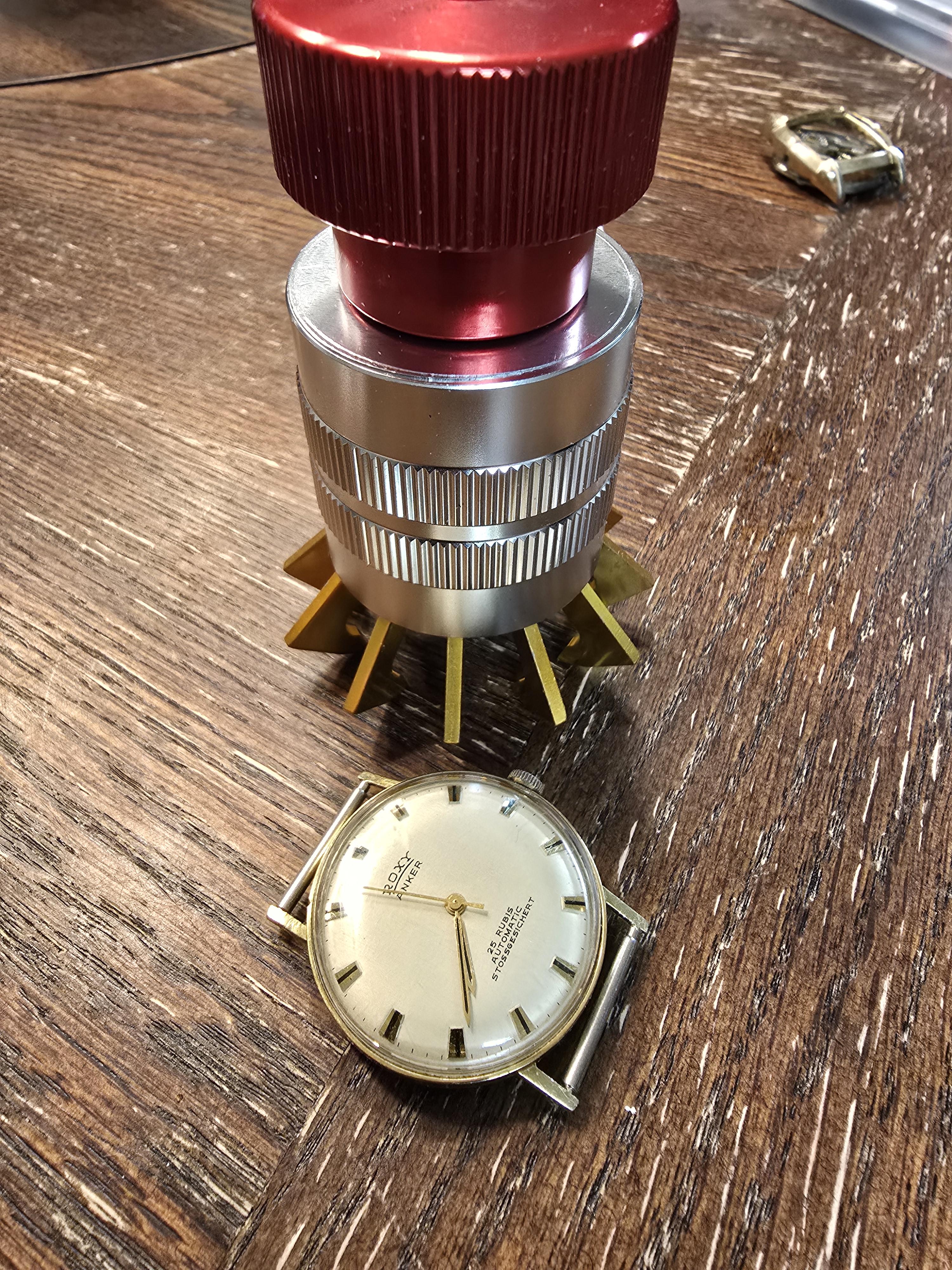

I'm a failure.  I can't get the glass off.  I thought the acrylic had a inward lip, it doesn't.  I get the grabber on it, and it just slips right off. I tightened it down to frightening levels, and can't bring myself to go any more.  I would love to clean and inspect the automatic movement.  BUT in the meantime it's keeping great time and has a strap for the first time in a while.
4 minutes ago, AndyGSi said:
Only got a cheap lift myself and never had any problems.
Are you gripping it as close to the case as you can?
I am.  There's a tiny step on the crystal, I'll try to take a better picture after work. Both the step and the part before the dome are perfectly perpendicular to the case.  I clamp down the little step before the dome, right against the case, pull up, and it just slides right off, of the step.  A little tighter, same thing, even tighter and I start to get nervous about breaking the crystal.  I'm paranoid if I break the crystal, I won't be able to get a replacement due to how obscure this thing is.
Older crystals can lose flexibility, so sometimes you do need to tighten down very firmly in order to allow the tool to decrease the diameter of the crystal as much as is needed for removal. Stiff, aged crystals can also become more likely to crack at that point, but there is good news. When it comes to a round crystal with no date window and a fairly generic profile, you should be able to find a suitable replacement by measuring without worrying that you need to find a part specifically matched to that particular watch model.
Of course if it isn’t a front-loading style crystal, then it may not come out (in one piece...) with a lift no matter how firmly you tighten, but you seem to have eliminated other possibilities.
hmmm…this one’s stubborn, innit?
You don't describe your technique- if you didn’t do this, try the following: set the lift on it’s end- that’s why it’s shaped that way! Next, opening the jaws all the way sometimes evens out the teeth. Then close so the teeth are slightly narrower than the crystal, carefully place the watch on top and slowly open the jaws until the crystal drops in the jaws while the case edge rests on top of them. Make sure the watch is flat and carefully tighten the jaws. Yes, it may become very tight and you may break the crystal. One of the few things that’s replaceable and considered a consumable in most cases…
Clamp here, the short step won't have enough size for the clamp to hold onto. When the clamp has some good purchase on the crystal start to turn it slowly, to see if the crystal is moving with it. When that happens the crystal is nearly ready to lift off, another nip up and it should pop up, turn and pull.

I'm convinced it's a front loader.  There are no seams whatsoever on the back. I've been wrong before though...
Here's where I am, loosened the clamp 100%, then brought it back to the second step on the glass.  The watch dropped down, as you said.  I then examined that it was uniformly even around the glass.  Tightened it to one hand tight.  Tried a pull and could see the clamp slip.  Then tightened to uncomfortable tight with two hands.  I begin to be nervous.  Pull at the clamp, and same thing, the clamp slips of the glass (not all the way, I'm using small movements).  Tighten a little more, now I can rotate the glass...  Just a little...  Risk tightening further?
Your trick did it!!!  It's off.

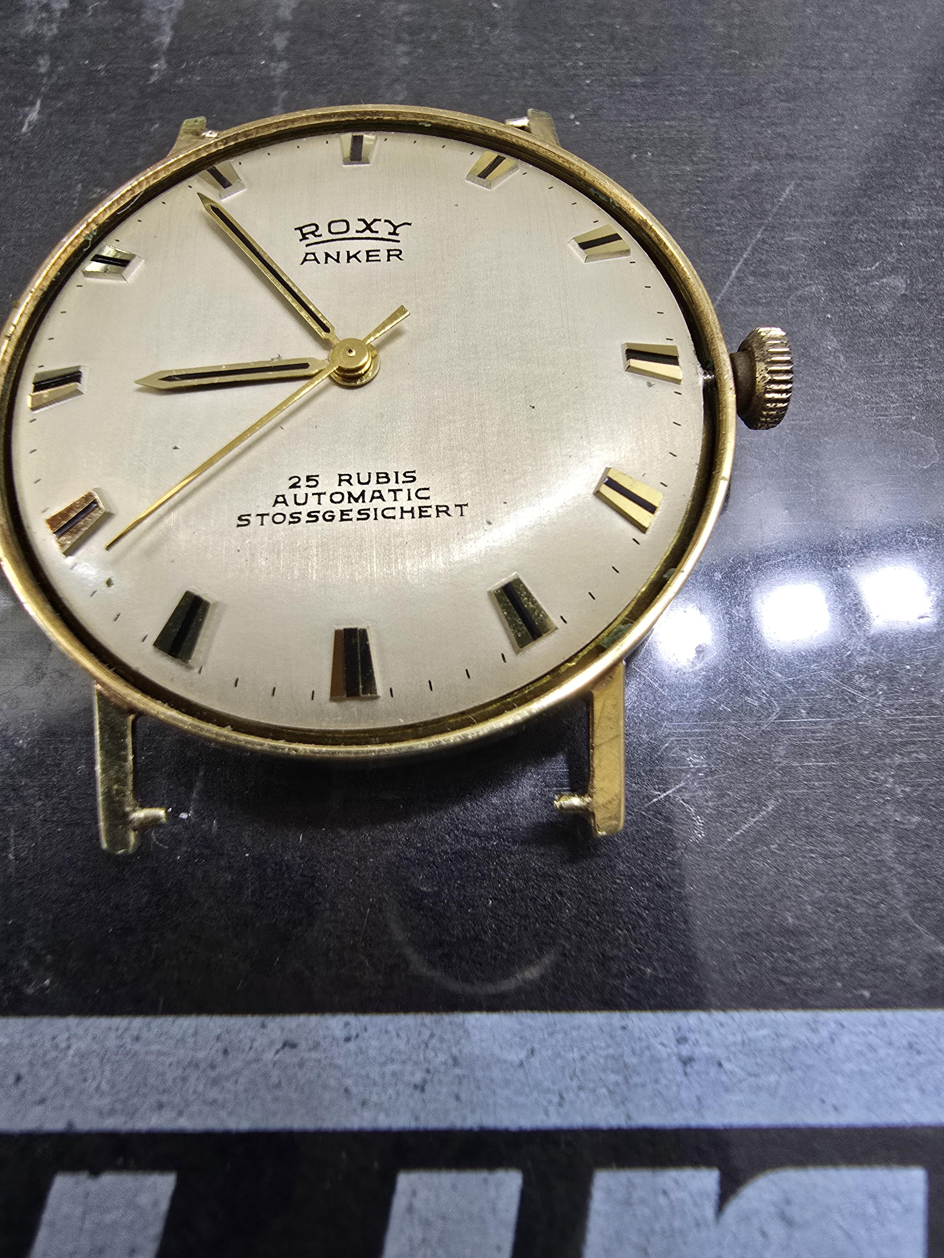

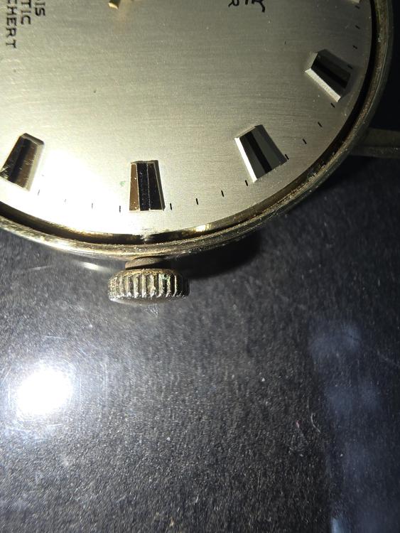

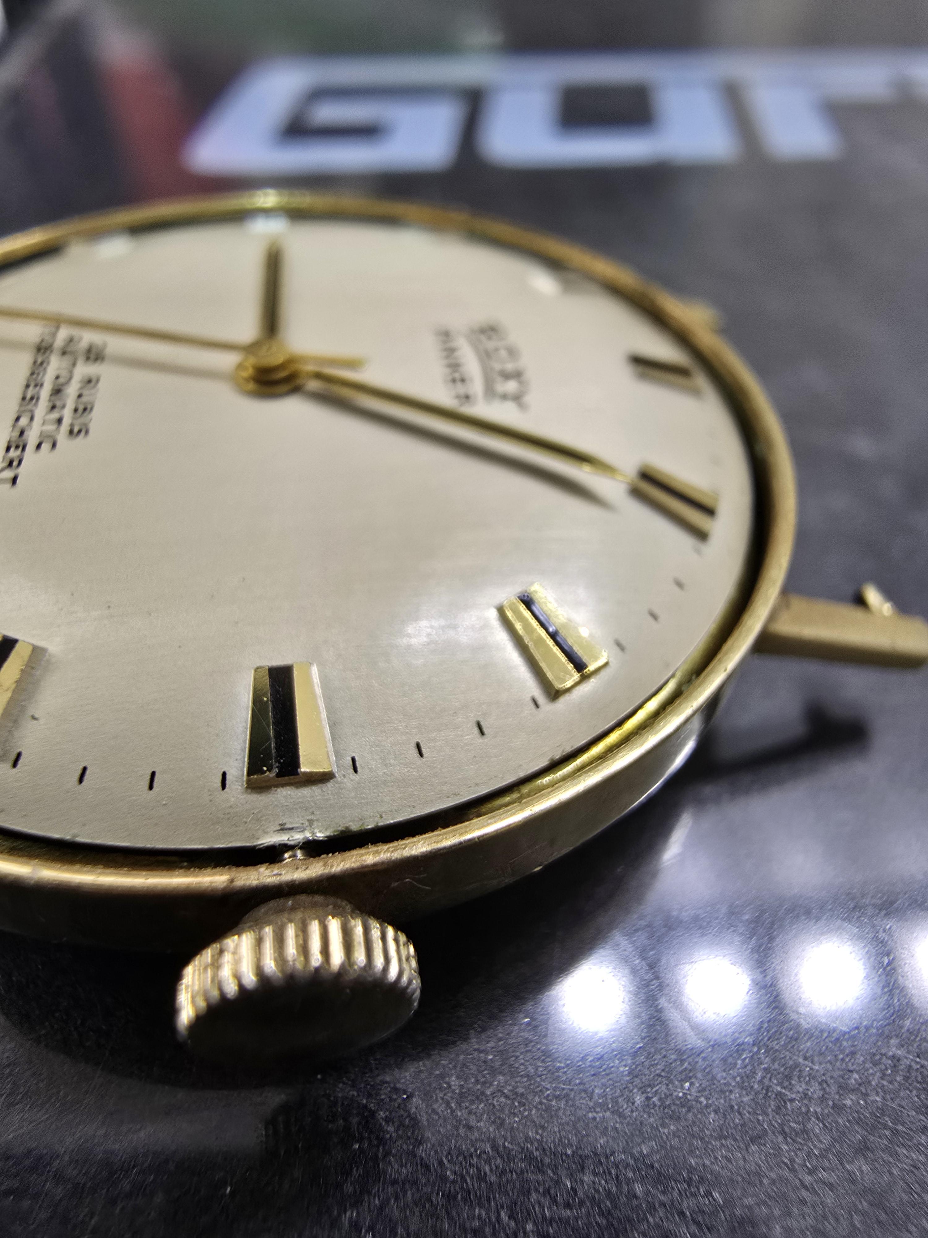

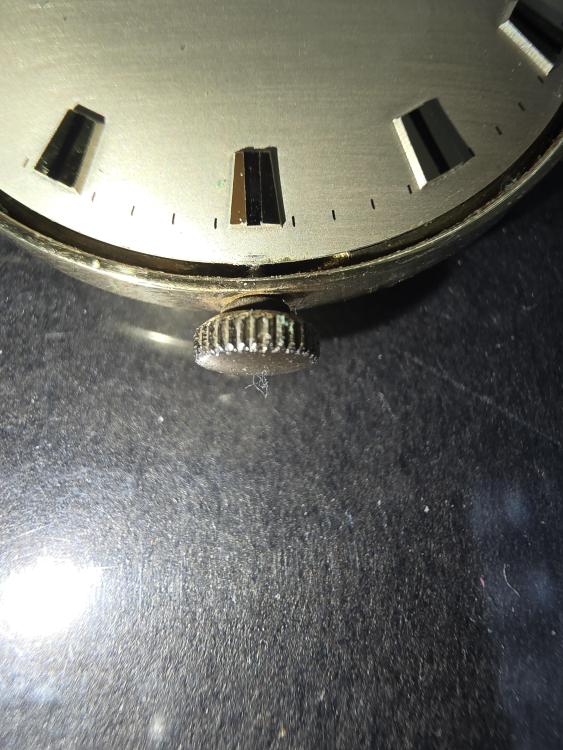

Ok, I examined around the dial, looking for something that might indicate how to get the stem off and the movement out.  I see no lever.  What I observe is damage to the dial right next to the stem, no where else.  It looks like tweezers pressed up against that dial, causing the indentation.  My thought is the crown needs to be removed?
Does anything appear when you pull the crown to the setting position?
Maybe it was a split stem that was damaged and someone's replaced it and the marks on the dial are where they held the stem while screwing the crown on?
The pictures are of the watch with the stem in setting position, and no, even at an angle, I haven't been able to discover anything.  I hadn't considered that it may have been a split and now it's solid.  I'm going to have to find some tiny pliers...
When the crystal starts to rotate you know that you are on your way. Always rotate it, just pulling it upwards rarely works unless the crystal is a slight fit. With each little nip on the clamp the rotation gets a bit easier. I have cranked down hard on the clamp sometimes and was convinced the crystal would shatter. Like most materials,you push them to their limits in one attempt and they are liable to break, but small increments of pressure allows them to acclimatise to a situation.
