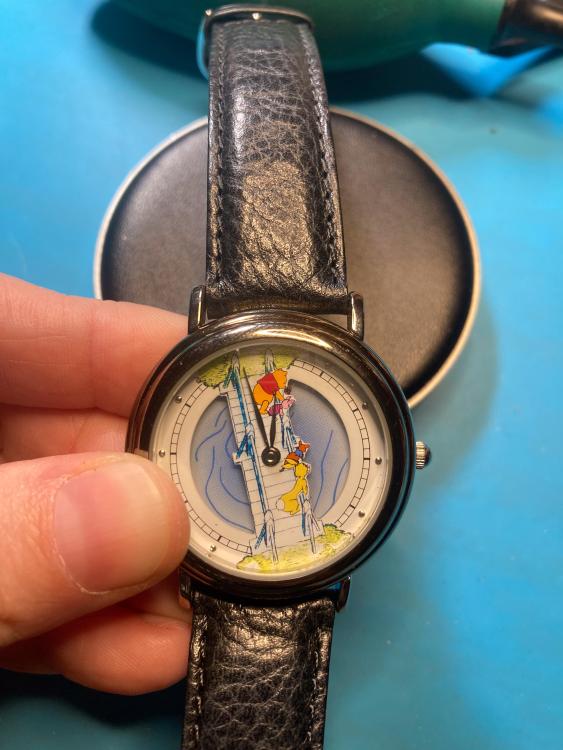

I have this Disney watch where Eeyore in the water is the seconds hand. I was able to remove the dial easily enough, but the seconds hand is tricky. It is made of a thin plastic material so I don't want to bend or tear it. I have tried lifting it off from the cannon pinion with no success. I am wondering if I should gently pry it off by separating the black plastic it is encased in from the movement itself since the new movement does not have this piece, but since this watch is not mine I want to be careful not to damage it. Any ideas are appreciated very much! If you need more pictures of other angles, just let me know. (the photo I have of the side view still has the dial)
Thanks again!

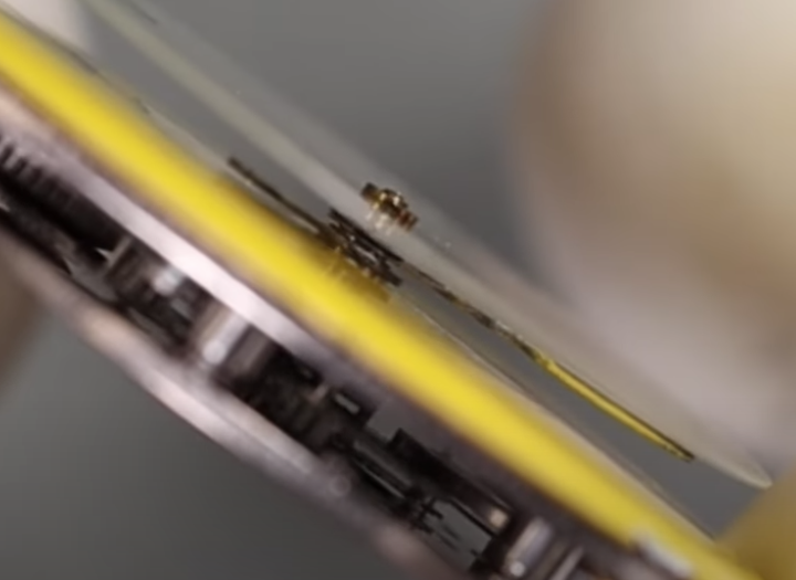

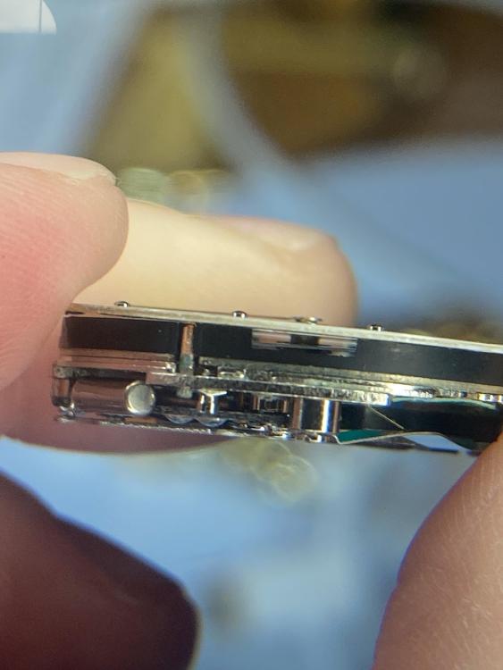

The disk looks to be fitted under or trapped within the hour wheel.  Be careful of any springs underneath it. Can we see the other side of the movement melissa
As requested a side view without the dial .  I take it that eyoreticks round for the seconds, yes. I would suspect it is a friction fit , needs a little more investigation.

AndyGSi, I have tried a canon pinion removal tool, albeit not a very good one, and some good tweezers. Another watch guy looked at it before I got it and said he wouldn't mess with it, but it appears like he tried to separate the black plastic from the movement since it is lifted in one spot.
If it is friction fit, watchweasol, then maybe I should not even mess with it. Yes, eeyore swims around as the seconds hand.
I worry if I force it too much, it might not go back on. I will just admit defeat for this one.

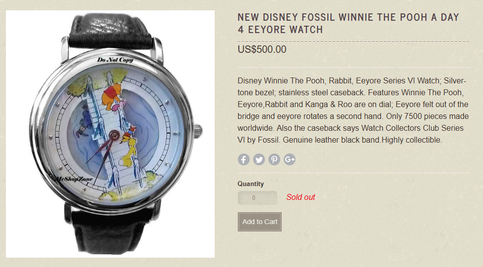

I'm really confused by this watch. The minute/hour hands are conventional, while the bridge with Pooh and gang doesn't move, and is actually the dial?
So, how does the second hand pivot power the Eeyore disk? It this a specially customized movement for Disney?
Would a replacement movement be found easily?

I started to think it had some kind of jump hour mechanism for the disk.
It’s probably an indirect drive from the center wheel under the moving disc. Problem is how to remove the disc to find out. Likley designed as a throw away watch not to be dismantled. I would assume rightly or wrongly that the disc is a friction fit but where to get a purchase on it to remove it is puzzling.

Just had another look and difficult to tell but to me it looks like it could be keyed and twisted on.
I thought the hour hand was fitted to the shoulder and the seconds disk moved independently of it, it must have the hour wheel on the backside of the disk. And the center piece is just the cannon pinion.
https://www.esslinger.com/isa-3-hand-quartz-watch-movement-isa1198-106-small-second-hand-at-12-00-overall-height-5-5mm/
Here is the link to the movement. It says the seconds hand is at the 12. Not sure how that would rotate eeyore.

So there is probably a pinion pressed onto the sub seconds pivot that drives a geared wheel on the seconds disk.
I worked on a couple of Zodiac watches with. seconds disks before.
I used 2 very thin dental cement spatulas as levers to remove the date disks. But even with utmost care, the seconds pivot got bent. Luckily it didn't break and I managed to straighten it.
Perhaps a similar technique could be used to remove this disk.
