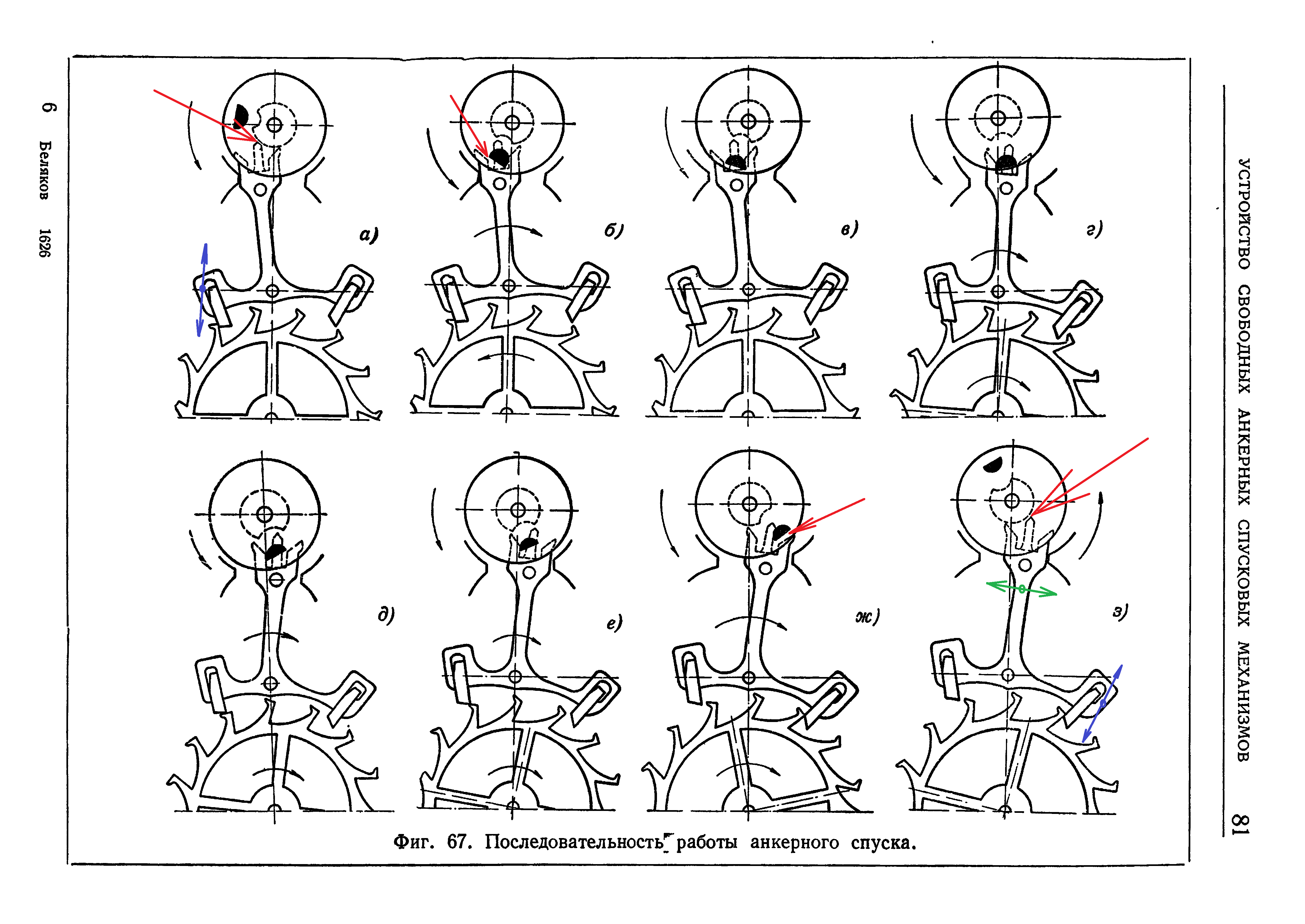

Here I have better drawing to show what checks is needed to do.
The red arrows show where the clearance or free play must be present. If You look at downside right part, the green arrows show how the fork must be free to make some movement between banking and the roller. This movement, thou small, must exist enough to ensure no friction allowing balance to rotate free outside limits of lift angle. As the fork is hard to be accessed due presence of the balance wheel and hairspring, much easier is to reach the part with the stone, so the blue arrows show where it is convenient to check for presence of the free play. This is not obligatory, but more convenient to remove all other parts from the movement for the checks. The balance should be turned to different positions in both directions and hold there while the free play checked.
