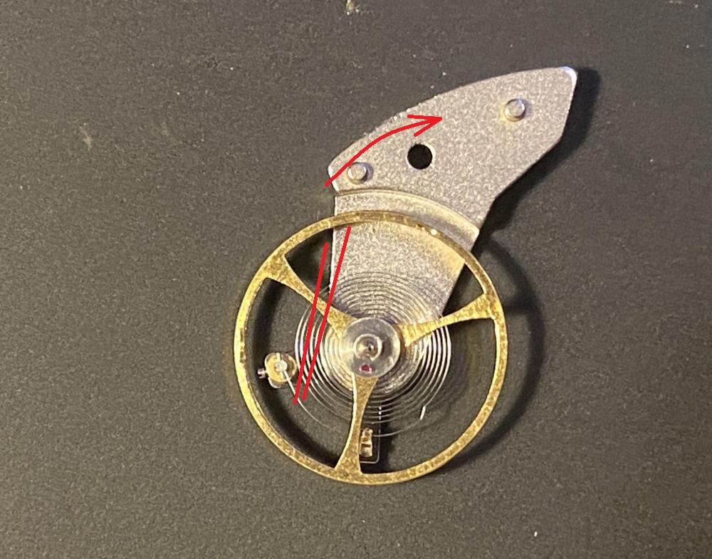

OP, probably the spring is touching the balance cock where the arrow shows, or may be under the circle near the arrow. But we still need good pictures from the side (this side). IMG_7280.thumb.jpeg.69fa15f37b0a1d29bd5b7fc8e7beb77d.thumb.jpeg.3b71777578d782f4463305872a135e57.jpeg
To repair such spring touching, you need to slightly twist the spring near the stud like I have shown in similar case, just the arrow is in the opposite direction as there the spring was touching the balance arm
IMG_9556.thumb.jpeg.f6f87495380c4d98b16fb5b6a732943c.thumb.jpeg.8494d516888c1e37d29e337196e51f29.jpeg
Another thing, though it is not so critical. The spring is not well centered and needs some tweaking where shown. Put sharp needle there between the coils and press a little in direction shown
