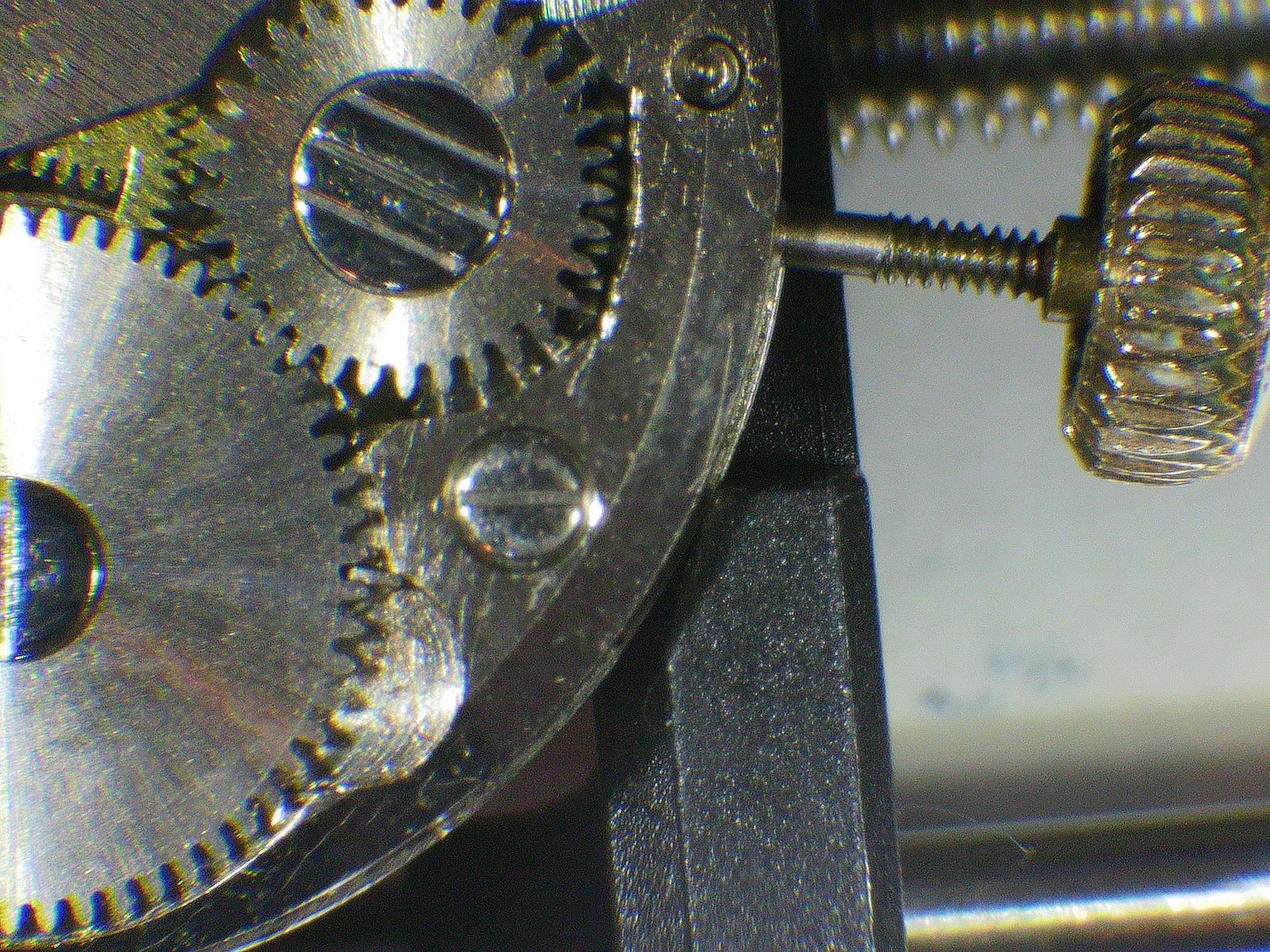

Before I do more troubleshooting, I need to learn how to let down the mainspring. This click spring is buried under the ratchet wheel. I don't know how to move the little nub out of the way to let down the spring. Any ideas?

if you start to wind the watch the click spring will move and when it moves you should be able to hold it out of the way and release your power.

As @RichardHarris123 has pointed out the spring must already have been let down to remove the ratchet wheel.
Either that or it just unwound and spun when it was removed.
The picture underneath shows the ratchet and transmission wheel in postion. What rph is asking...... is for future reference of how to learn to power down by disengaging the click.....so not in this particular incidence where he's already managed it.

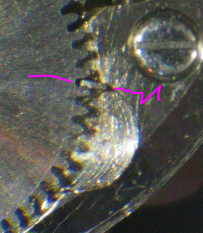

This click spring design is not my favorite. Grabbing that nub and pulling down on it is tricky. Being under the ratchet wheel is not good. Here's a side view of the movement.
Well on this picture it is clearly seen the hairspring is bent up. Probably the other side goes down and rests on the balance arm. The other thing to check is if there is some axial free play of the balance.

I checked out the hairspring and it sure looks like it was drooping. I unscrewed the hairspring stud and pressed it down and it was maybe a tiny bit out of position. I think that was causing the hairspring to drag.
