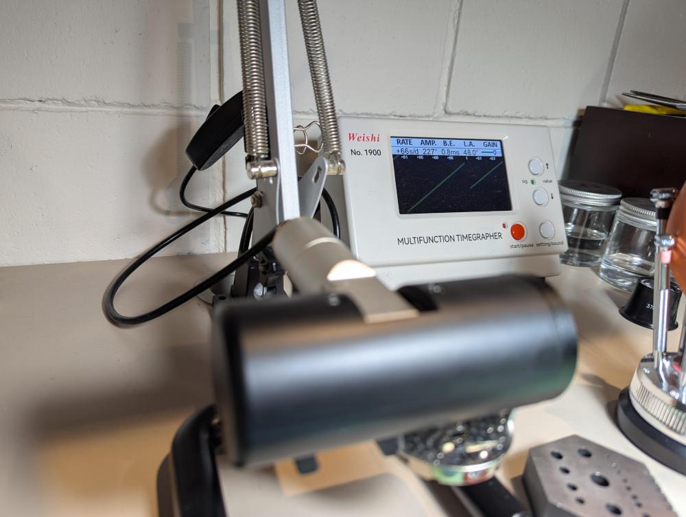

Yesterday I checked over the whole train and cleaned all jewels (except not balance yet). I found an issue with the interaction between 3rd & 4th wheels where I could hear a ragged, scratchy sound when they were at high spin. I polished the 4th wheel pinion leaves with rouge & pegwood and that eliminated the scratchy sound. Before that, the train had just a little bit of backspin and afterward it has tremendous backspin.
But absolutely no change in the performance. Exactly the same DU/DD amplitudes as before so something is off with the escapement. Tonight I'll clean the balance jewels again but one thing I noticed about the pallet fork is it is very hard to seat. While I had the jewels out for cleaning, I found I could not easily place the loose lower pallet hole jewel over its pivot and it is hard to seat it in the pivot hole. It makes me wonder if it is the wrong size jewel which would be binding on the pallet arbor. I do have a spare 992 mainplate with that jewel intact so I will try that one out. Of course if it was a replacement arbor with the wrong pivot sizes that isn't gong to solve it either.

Okay interesting progress. I took out the balance jewels to relubricate and found them dry. The lower had a small dry smudge where oil had been, the upper had nothing. I am guessing the I originally over-oiled the jewels and as this watch sat it all ran out. I first cleaned and assembled it maybe a year or more ago and was not as good at getting the right amount of oil on endstones.
I just redid them and the DD/DU differences vanished. I get 225°-230° for both with delta 2-4s, and PU is about 200 but rate only 6s off DU.  Amplitude is not yet as high as I want but might climb overnight (and I'll have a stronger spring in a couple days if needed) and then I'll bring the beat back to zero where I had it before. It's acceptable but I'd like to get it narrower. PU amplitude was not 235 as pictured. I don't know why the tg is having a hard time reporting amp changes today.
PXL_20250114_031718927.thumb.jpg.a9b94c67e42ef7f62eba482e95b5c48e.jpgPXL_20250114_031822292.thumb.jpg.3347042efae4702f47a55c08d8d1fc4d.jpg
@JohnR725 I used the trick you described of sighting down the fork shaft and the escapement does seem incorrect. The exit stone is locking deeply and that's consistent with how much farther out the sight line is visually against the rim of the balance jewel. I'm not going to bother it yet but I did mark the positions of the eccentric screws so if I need to poke around later.

I decided to give it a shot with positive results. Marked the banking screws so I could undo it, I move the outside banking pin inward a tiny bit to adjust for the visual alignment difference of the fork shaft toward the balance jewel and lessen the lock on the exit stone. That little change put the watch back in beat (yay I don't have to mess with the collet again) and amplitude jumped from 220 to 255. Exactly what I needed. Adjustment to the mean time screws brings the rates down most of the way and I still want to finish a dynamic poising to bring PU closer to the horizontals.

I did check it last night visually at 180 and it was still consistent at 48° but now you mention it, I was not feeling confident it was running as high as 255 because it looked  more like around 240. And a change to the banking could be responsible. I didn't verify where 180 landed exactly but I will do that. Realize I have to think through which way it would go; I narrowed the banking so would the LA might get smaller.
But even if the measurement is inaccurate, the balance is oscillating much more vigorously than before the banking adjustment.
