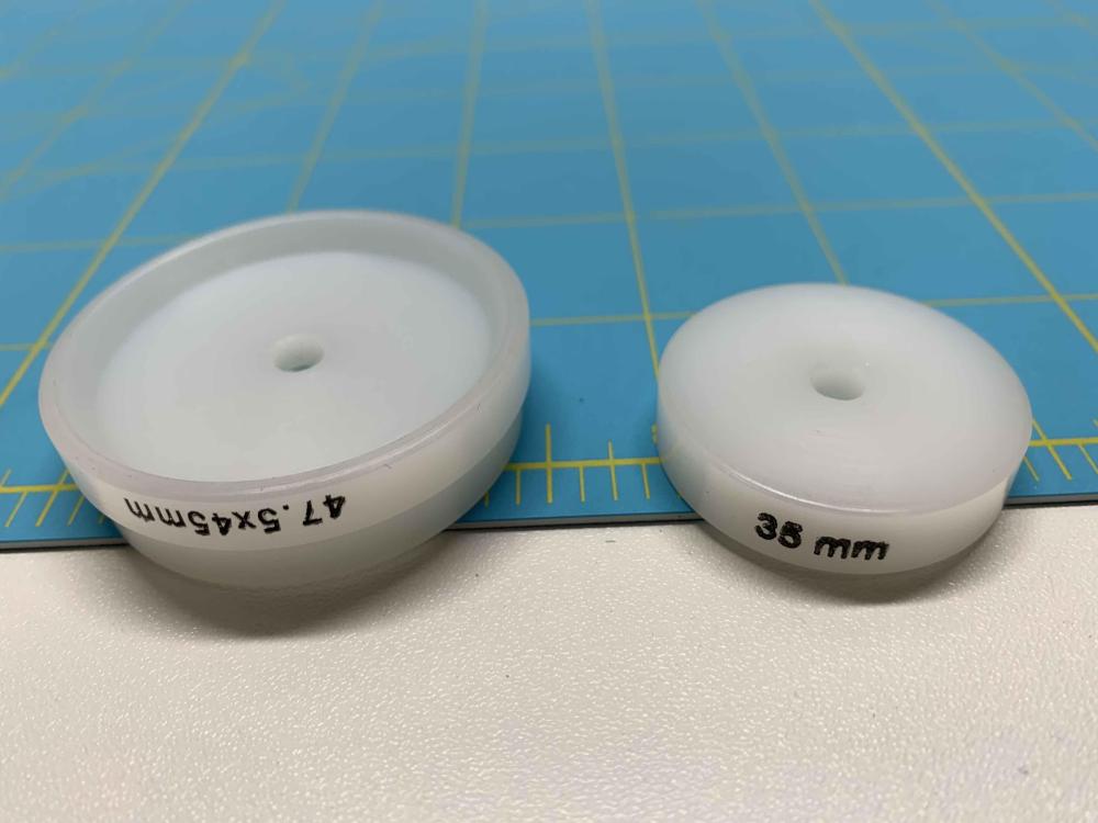

Then I try to pop the case back on. Nope. No way with my all my strength is this thing popping back in place. No problem I tell my friend, happens all the time. That's why I have a little hand press for case backs and crystals. Heck, I've even installed a case back on one of my old grumpy watches using the bench vise in the garage once...  So I choose a flat die for the case back and a concave die that will touch only the watch case and not the crystal.
So far so good. Get everything lined up and give it a squeeze. Nothing. Take a deep breath and squeeze harder. Still nothing. Recheck everything is aligned the way I like and try again with all my strength. Nothing. Grumble.
My friend (who has bigger hands than I do) offers to give it a try. I give him the press with the watch in place all lined up and tell him to give it a go. He does and we hear a satisfying little 'pop,' which I assume is the case back snapping into place. Great! He hands the whole thing back to me and I extract the watch from between the dies.

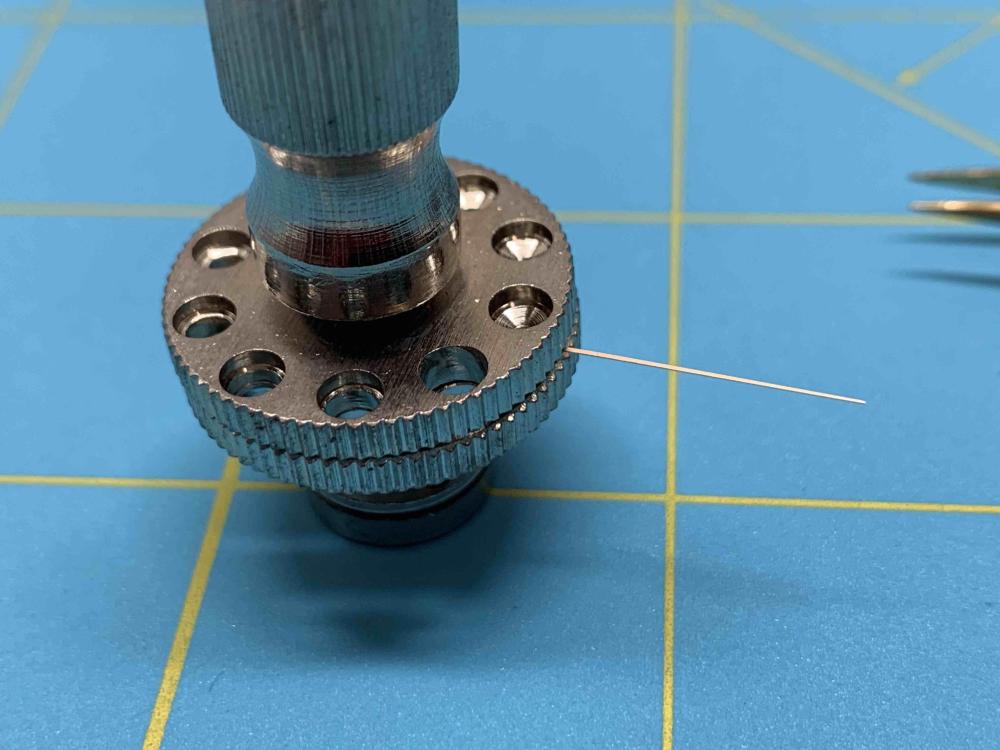

Oops... Looks like the die on the dial side flexed so much that the centre pin the die sits on breached the crystal. Adding insult to injury, the case back still had not seated. Good grief!
But it was worse than just the broken crystal (and my damaged ego). Two of the hands were bent and some glass must have worked its way into the movement which was now seized. Deep breath. Sent my friend home with no watch.
Lucky for me the movement was relatively easy to get and not very expensive. Same with the crystal.
Hands came back to shape well enough, and things went together well.
