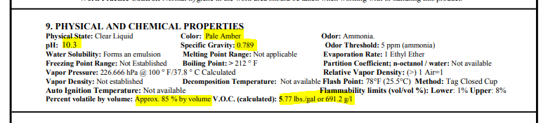

I've put the cleaning recipe on hold for the time being, and I'm using #111 currently. Just too many repairs and services to have time to tinker much with the formula.
Heres the differences I found between #111 and the Extra Fine:
#111
Extra Fine
