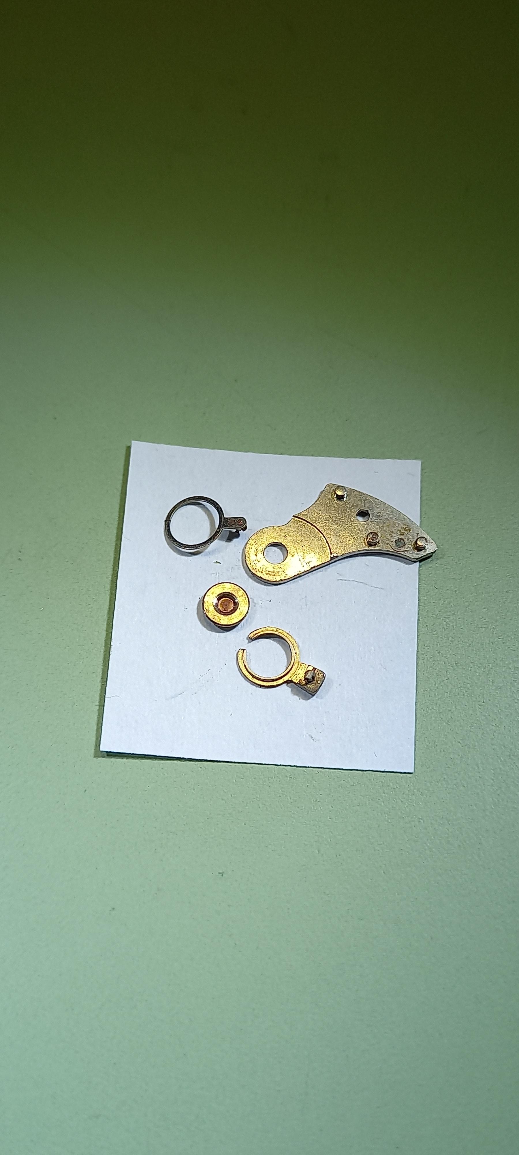

It is the first time I have come into contact with a balance cock that is not screwed together or inca block type of jewel attachment.
Is the balance/jewel/adjustment pressed together or is it threaded together?
Any tips are very welcome.
Thanks in advanced.
(oh my, how I had hoped to find two small screws on the underside of the cock)
There appears to be three notches on the underside of the balance cock around the jewel.  My guess is that a KIF tool might fit that, and it would screw/twist off.
Yes, the ultrasonic is your best friend in this situation. Whatever you do, DO NOT peg that hole.
Thls is a non-removable jewel setting. The 3 notches are to allow the cleaning fluid to penetrate and wash out any debris.
This is the first time I've seen it being used for a balance jewel. It does not offer any shock resistance to the balance pivots. It's normally used for the escape wheel and pallet fork jewels.
I have some ordinary balance jewel settings like this I'll pull one apart, it was fitted together somehow.
Ok so i found some to play with.....because I'm kind of awesome like that, shall we have a look to see if they come apart ?........easily without the use of the equaliser ?
I think Nev should make me this from a crushed car engine......... to go with my spandex outfit.
Before i start, I'll point out that i agree with hector about solutions flowing through the setting, not so obvious in your photo but my first victim has 3 finer slots in the top , i think i can see yours also has these.

If it's non removable how would you replace the regulator?
So if you really want to you can break the cock and jewel setting down to these 4 pieces, the regulator arms remove quite easily with a sharp knife under the beat arm then the setting can also be prised out from the cock with the same sharp knife. Thats about as far as you'll get and tbh i dont think you need to go any further the US should flush it out, so I'll  try that. But for interest there does look like a fine seam that will split the jewels holder in two and yes the jewels are seperate....a holed and a cap...the cap is a tad wider as usual. Lets give it a blast in the US and see how it comes out...this one is grubby as hell and the jewel hole is block...so a little poking around is required to free up the crap. To summarise....dont bother stripping it down even to the 4 parts unless you're really fussed about it, just blast it in a USM. Let us know about your outcome with it please.

Yes it comes apart Andy..... to 4 pieces
I'll flush it, and then try split the jewel holder, 99.9 % sure it wont survive, the equaliser is ready and waiting to take over when it goes pear shaped 🤣

Thanks a ton for the disassembly test. Very value information. I will now put it into my USM and lubricate it with an automatic oiler.

I only disassembled that one, but the rest of the examples seemed pretty much the same setup. The jewel holder itself will not split without some specialist tools. It cleaned out ok, you might need to swish it out a few times to get it really clean, uou could try  injection with solutions....like a mini jet wash 😅
