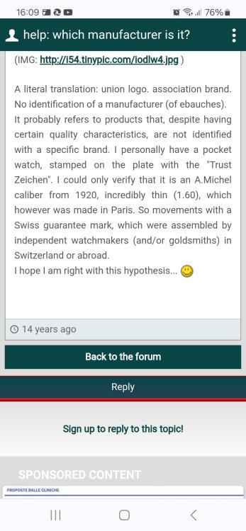

My late grandfather's watch. I can't identify the movement. On the bridge it says 'Swiss Made 15 jewels' and the logo is on the dial side. Case is gold, British made and says 'Stolkace' or something similar. Can't quite make it out.
