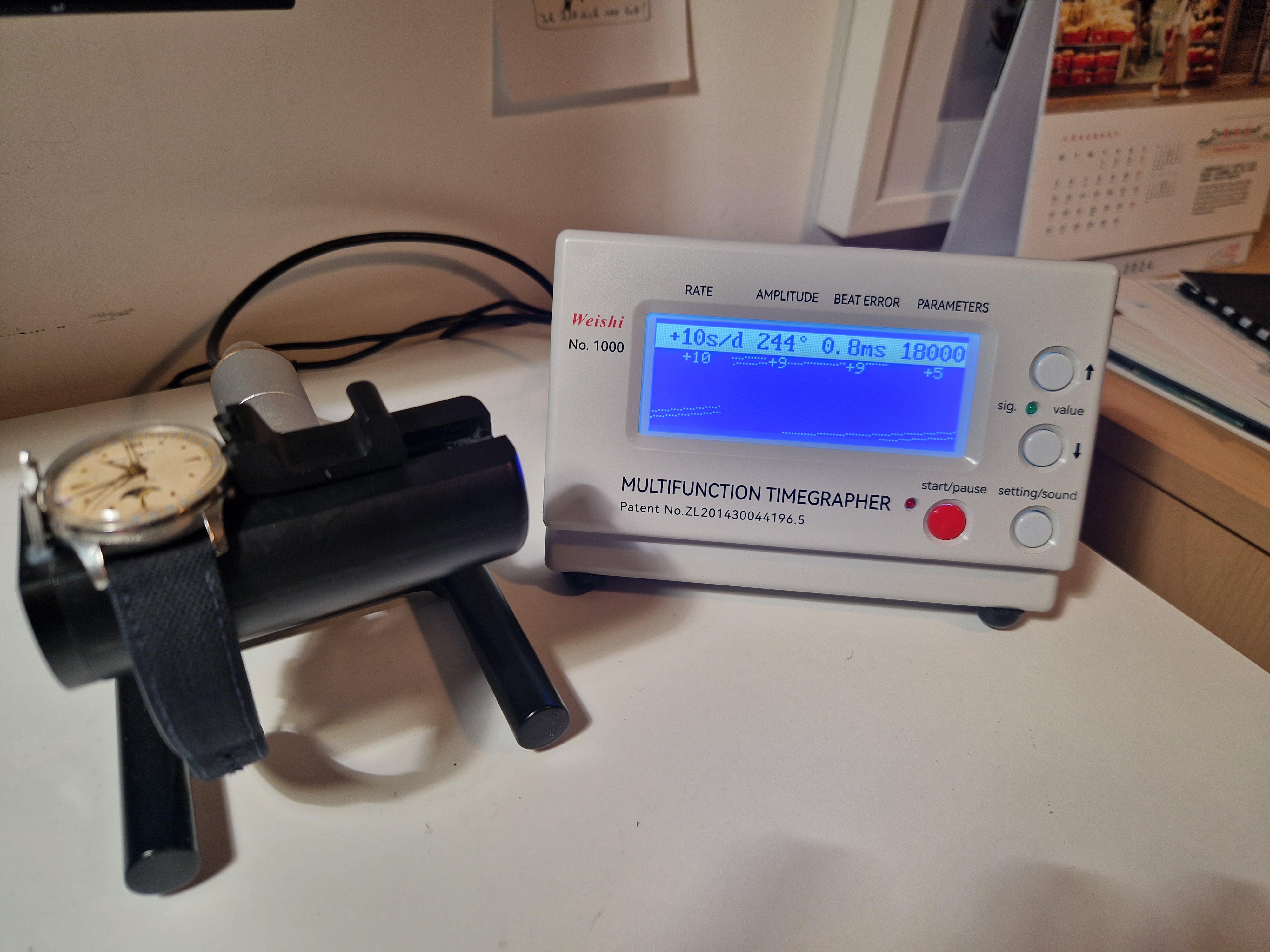

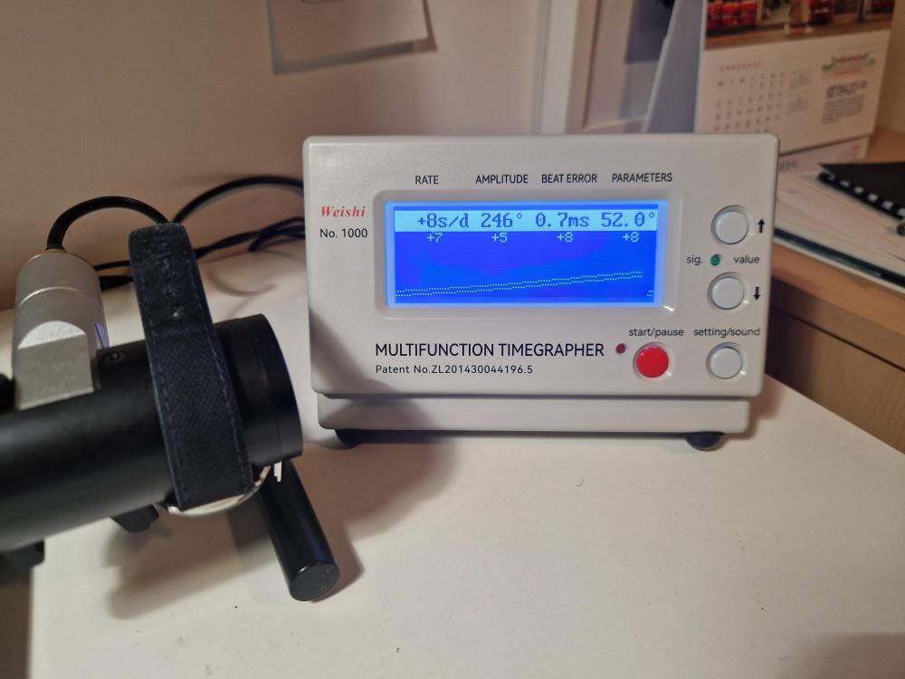

Hello everyone!!
I finally managed to finish the assembly and to upload all the photos!
It took longer than expected and I had a few issues that took a fair bit of fault-finding and troubleshooting. Great learning opportunitiy.
Well, but now step-by-step.
