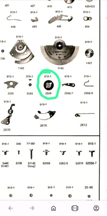

A little update, the movement is in a great condition but the date change wheel is missing so I'm on the look out for one.

Is it Part No. 2556 that you're looking for?
Yes, Thant's exactly what I'm looking for.

Yes, these sometimes break. That's why it's a popular part, hence the inflated prices.  I've seen posts where people make a new spring (the bit that breaks). If you find one, take note how you place it, otherwise the date change won't work properly.

Making a new part is way above my skill and tolls level, I'd like to get there one day though.
What do you mean about placing the part? does it have a specific way to install? do you mean that I have to hook the leaver under it in the hole of tha is on the wheel plate?

Just the orientation of the part. If you have it and place it, you'll see how it works. At one point, part of the wheel is turned so a spring is pushed out. That in turn pushes the date ring. You'll have to place the wheel so the timing for that works. There might be some timing marks on the wheel driving it. There should be some Certina tech sheets out there explaining it better then I do. They used the same system on a lot of there movements, like the 25-651.

Thank you very much, I didn't know that I'll be careful when I get the part.
Checked cousins UK and is listing as discontinued, and they are pretty good about crossing over to bestfit if there is another caliber or another  manufacture's caliber part that would work...but might be worth a look anyway...
