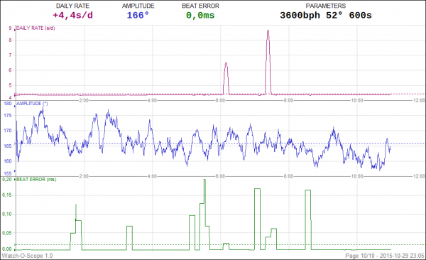

Leaving aside the calibrated with a * .wav. I have a problem. my quartz watch with which to gauge desire WOS, I did a test. for a month. The resusltado is to come forward 10 seconds in a month. Which means that only 0.3 seconds a day ahead.
However when analyzed with WOS, this is the result.  The "Rate Correction" was set to "0".
Think WOS analysis, it is affected by the inhibition.

Hi Guido:
The result indicates that you must set the rate correction to -4.1, because 4.4 - 4.1 = 0.3.
Since you ran your test for about 11 hours, inhibition will not affect it. The inhibition interval of most watches is very short.
Those large spikes at just after 6:00 and 7:00 were probably caused by a loud noise, either in the room, or in the movement (for example, the date changing). But as you can see, they had a very tiny effect on the average.

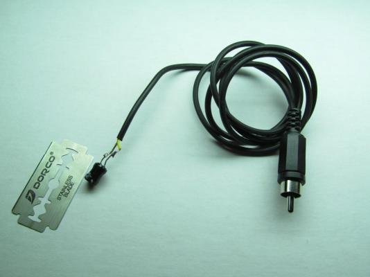

The model number of the sensor is BM15015-06HC
I am going to order some of these to experiment with. Allied gave me a lead time of 2-3 weeks, so that's pretty reasonable.
I was looking at the datasheet for this sensor, and one of the applications they list is "phono cartridges". That makes me wonder if a phono cartridge might be usable as a watch sensor. I'm going to try placing a watch on my old turntable (not turning of course), and place the needle on the crown to see if it will "hear" the watch.
On the sensor. I tried the turntable about 25 years ago ..... did not work and I think there are two types. magnetic pickup and the crystal .... I remember is the crystal. But they still need a pre-amplifier with very high gain.

Jamez361, I just received notification from Allied that my vibration sensors have shipped! Hopefully I'll have some time over the holidays to incorporate one into a new design for a microphone (and perhaps low-gain amplifier).

I managed to get my hands on a bimorph sensors and I just put it in the old circuit (the one with the piezo sensor).
What I can say is that I was expecting more. There is a slight improvement but I didn't have the time to play with it.
