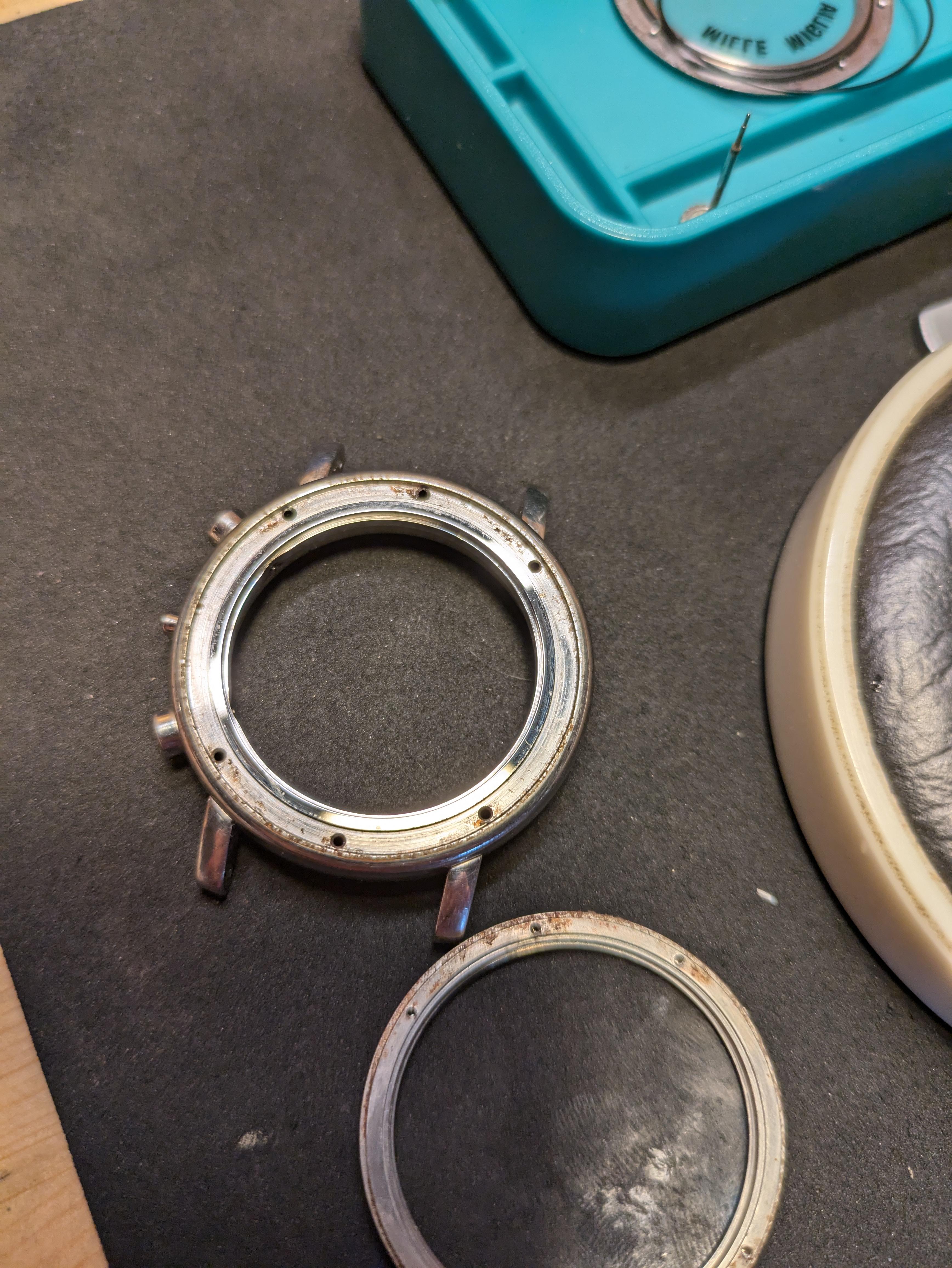

I have a Chopard Mile Miglia 8331 chrono on be bench, ETA with a DD chronograph module. Has anyone worked on one of these before, specifically, it looks like the movement may drop in from the front of the case? Bezel appears to be removable.
Movement clamps and stem removed and the movement will rotate in the case, but no signs of dropping out?
Any clues? Many thanks, Lawrence

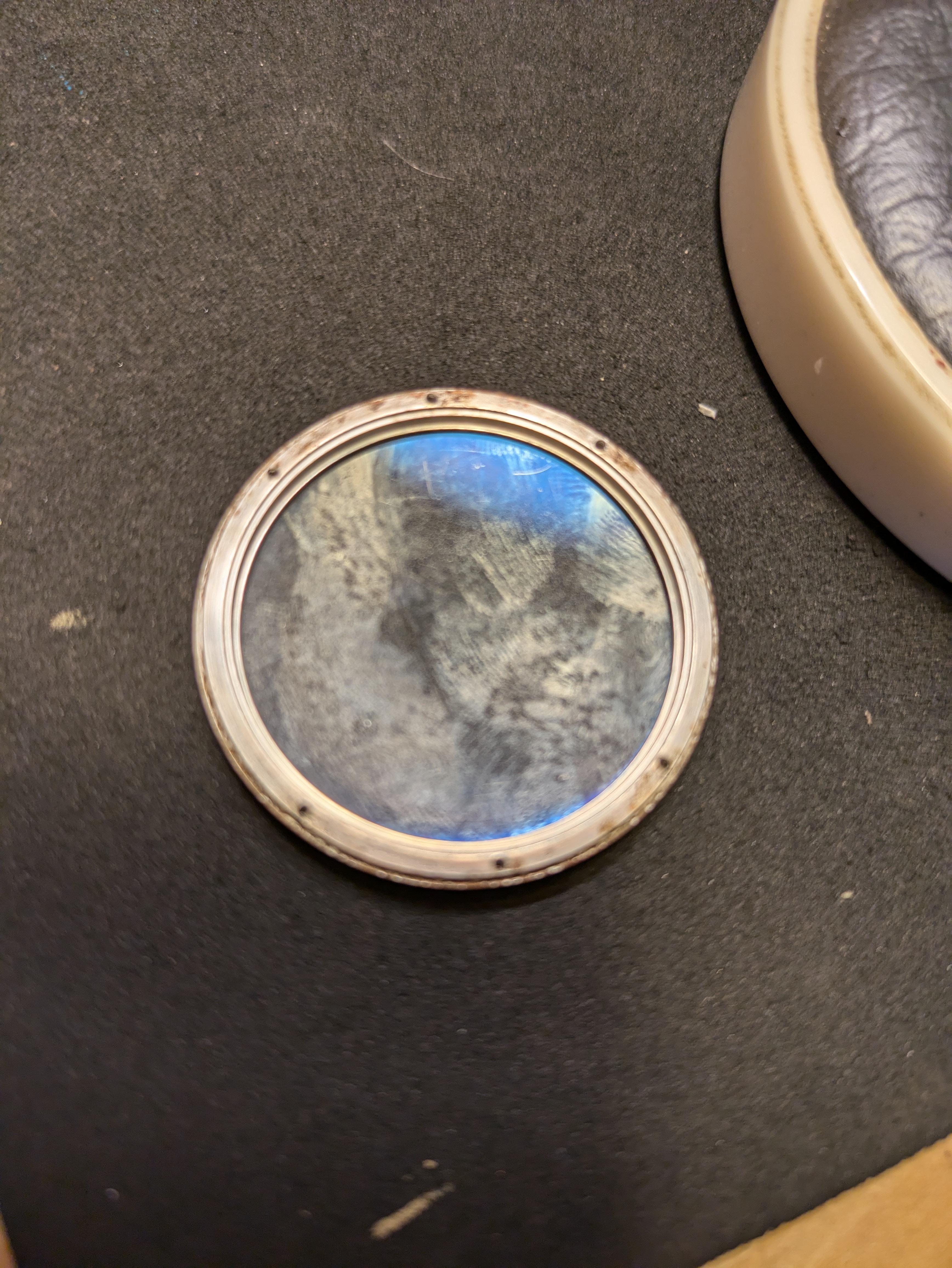

Ok, figured it out. Six cunningly hidden screws on the rear of the case, securing the bezel. Once removed, it all dropped out of the front.

For reference for anyone else working with one of these.
