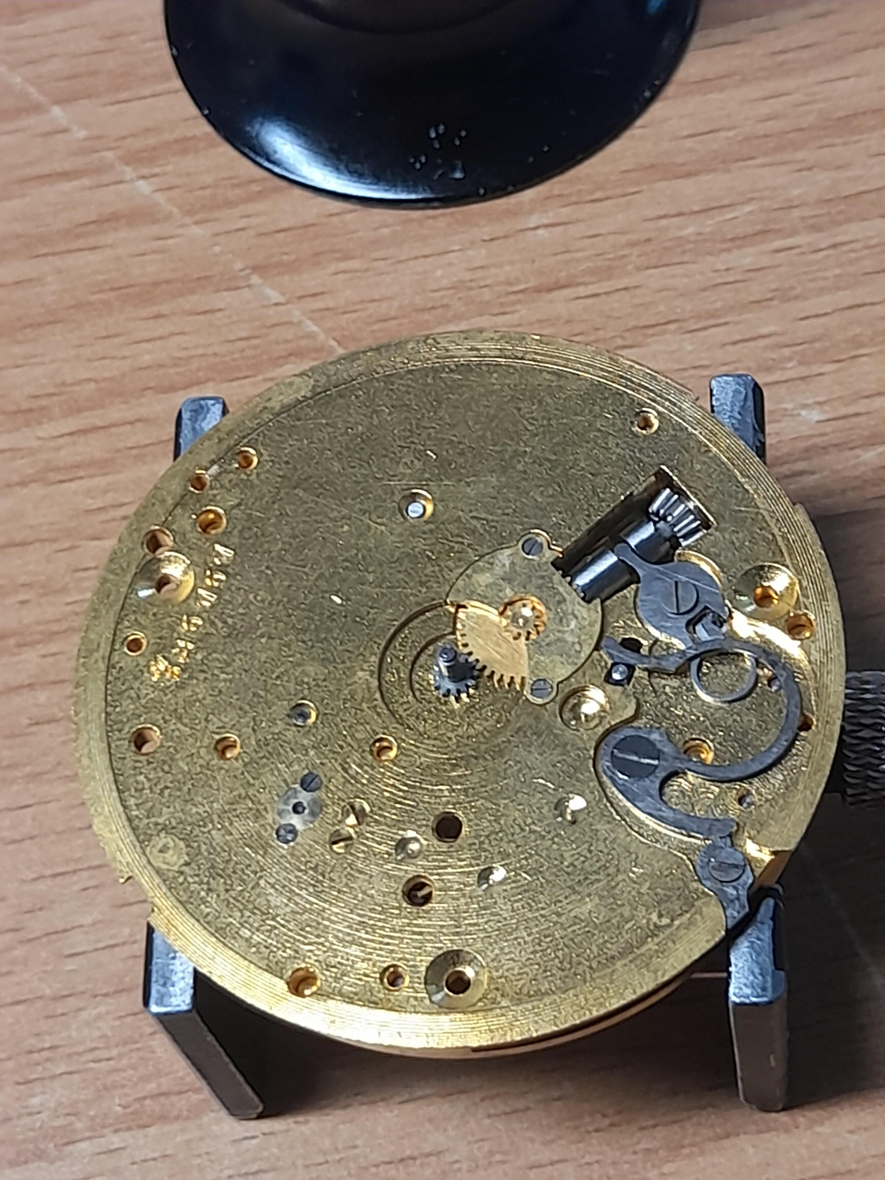

You could get one 3D printed in stainless or titanium? Add the rest of the original detail to your existing model and proof check it comes out OK in plastic, then have it done by JLC, Shapeways etc. Not cheap, but you could get a lot closer the original appearance? -

Again, EDTA solution as I mentioned above, or Evaporust. They attack oxides but not good metal. After some hours, all the rust should have gone.
