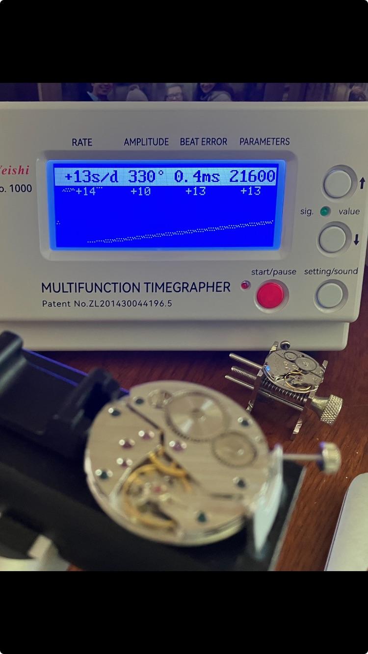

Timegrapher as a diagnostic tool.  Noted.  I have a log now of my 11DP.  First, I am working on patience as I await my ST36 for practice.  The 11DP is small.  As much as I want to start its tear down to clean, I am waiting for the ST36.  Lacking patience I had taken the crown out and also the lever setting spring which had broken.  As I flipped the watch over all the keyless works fell out.  Rookie!  Finding and putting all that back together was a fun test.  I succeeded and sinned by putting a drop of Kroil on the balance wheel pivot.  I know, wrong stuff!  It is a $20 eBay watch that needs a clean so I figure adding the wrong stuff was not irreversible.
Dial Down all night last night and still running after a full wind.
15 minutes after full wind and dial down move:
rate +40, Amp 161, BE 1.2  8 hours later, +45, 176, 1.2.
Dial Up.  Watch stops.  Yesterday and today.  Return to dial down and I must help the balance and have a snow storm for some time.
My newb thoughts are:  Typical results of a watch from '70s that has never been serviced?  Or, does the complete stop of balance when dial up suggest internal damage like a bent pivot?
Alas I wait for my ST36.

Sea-Gull has landed.  Runs even better DU.  +13s/d, 324 amp, 0.1ms BE.  Crazy.  And the goal is for a newb to improve on that?   I get it.  Take apart, put back together, test and repeat.  Certainly larger than the 11DP.
Tools.  Quality Horotech .60 to 1.4mm, Dumont #5A, Dumont #A.  The later is stainless but has become magnetized.  I have not purchased a $12 blue box to solve that.  4040 holder.  Full set of Loupes now in hand.  Two part sorting boxes.  Bergeron hand pushers..I can see I need more sizes. Pithwood, pegwood, rodico, 9010 mobius, junky oilers.  I will use iPhone for helping me get it back together.  That is the current tool list.  No dial holders yet.  No work cushion.  Cleaning...no plan yet, no US.  What I read, ST36 just take apart and put together, skip cleaning.  If my watch passion continues...one needs time.
I think you need to set the lift angle to 44°. Amplitude will read quite a bit lower, but still good.
