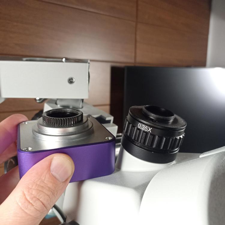

 I hoped to manage by myself but after a week and multiple adapter buys I haven’t managed to connect a camera to my microscope.

As you can see it has some kind of camera adapter with a focus adjustment  which came with it. But the top is not threaded it is just a metal tube and I expect you are supposed to have a camera which just slides in.
That drop in tube can be unscrewed as shown in this picture  the inner diameter of the female threaded part is 25.3mm
The whole optics for the camera can also be unscrewed that female threaded part is 27mmimage.thumb.jpg.8107135a9bf657e87927aad6ee1b24f2.jpg

My problem is the following:
 can thread either of the SZM adapters into the microscope 27mm screw hole (what is left when I remove the camera optic which came with the microscope) I can also screw the other side of either adapters into the camera with or without the C to CS spacers which fit between the camera and the adapter (not between camera and microscope)
however when I use any of this combinations I cannot have an in focus image from the camera the focusing adjustments from the adapters seem to be just not enough.
On the other hand if I just hold manually the camera above the built in optic I have a beautiful picture but no way to attach it that way.
Does any of you know of a solution. Maybe yet another adapter which would screw into the amers and drop into the tube. Or a replacement for the tube of the same length but threaded to thread into the camera?

I have an Eakins microscope which looks pretty similar to yours. The only thing I needed was a C-mount adapter. I got mine on ebay, it looks like the one below (but is a 0.35X, not 0.5X) That just drops into the trinoc port and is held in place with a grub screw and then the camera screws onto the top part. I also use a 0.5 Barlow.
This is my setup. There's some spacer ring attached to the camera, maybe C to CS? I can't find info anywhere. Then an adjustable 0.35x c mount adapter.

In addition you will need a c to cs adapter which is just a 5mm ring to bring the camera at the right distance.

I had the same issue. C to CS adapter:
