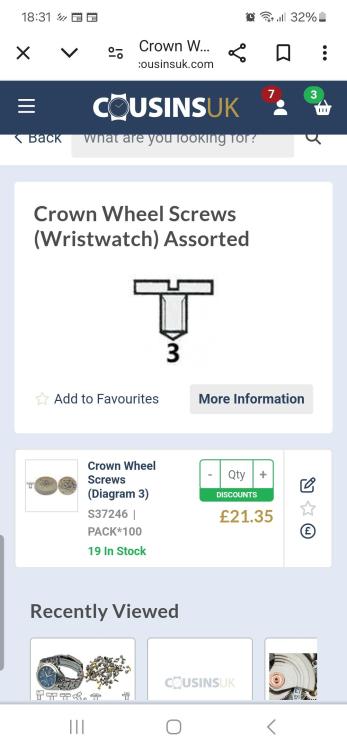

Apologies for imposing further but any views on the practicality of finding a replacement barrel (Ratchet?) wheel screw?

Yes, Chajka (Чайка)1301 . The click spring can be made of spring steel wire. No annealing needed for such steel. Such wire are the springs for violin and guitar, but this spring is thinner than the thinnest violin string. Spring from another movement can be reshaped, as suggested.
Such movement can be obtained for less than 50 p in Russia, but I am not sure if this is an option now.
The broken piece of the barrel screw can be unscrewed with hard sharp pointed tool. The screw is not tightened now, as the head is not there, so it should unscrew without resistence.

Thanks for the info, Nev. I'd got the barrel screw out straight away: it was indeed quite loose.
