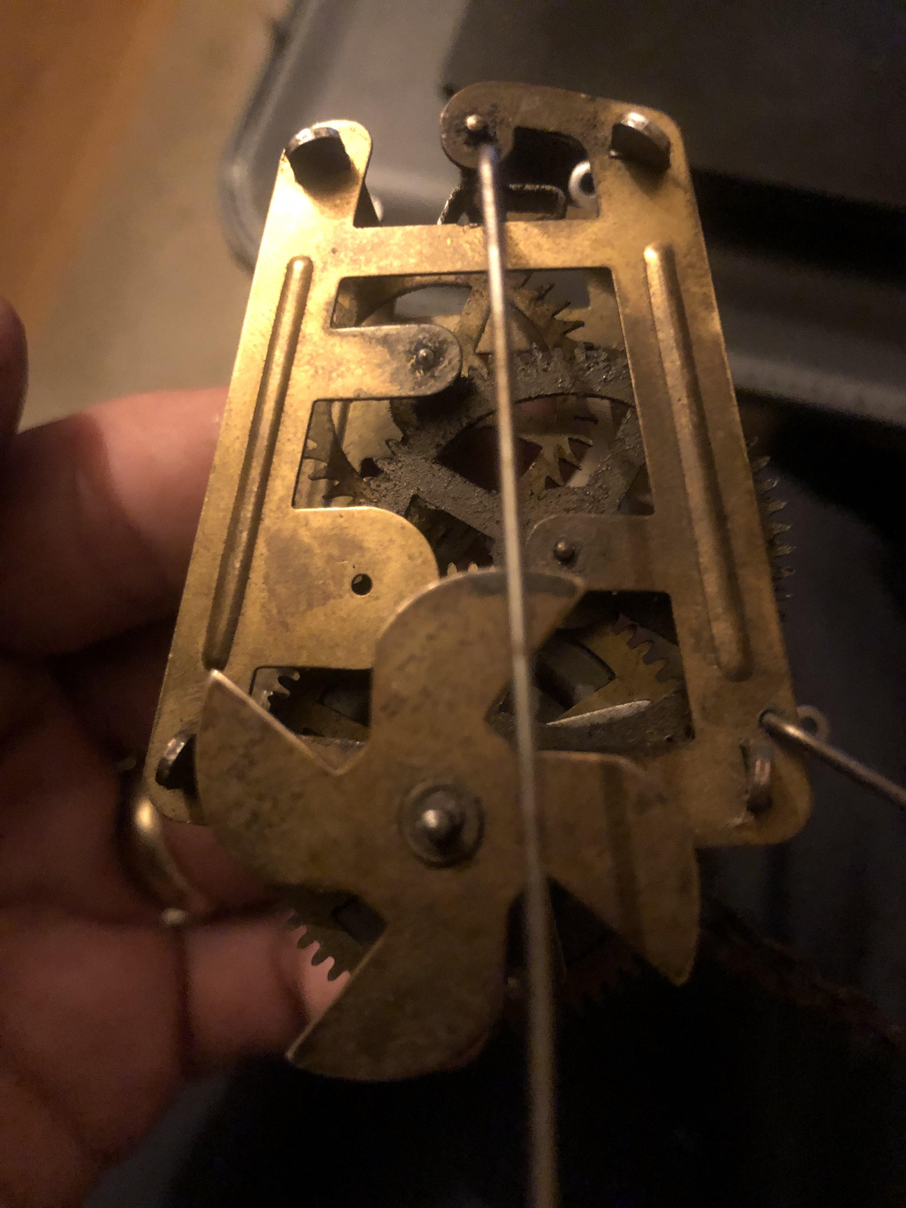

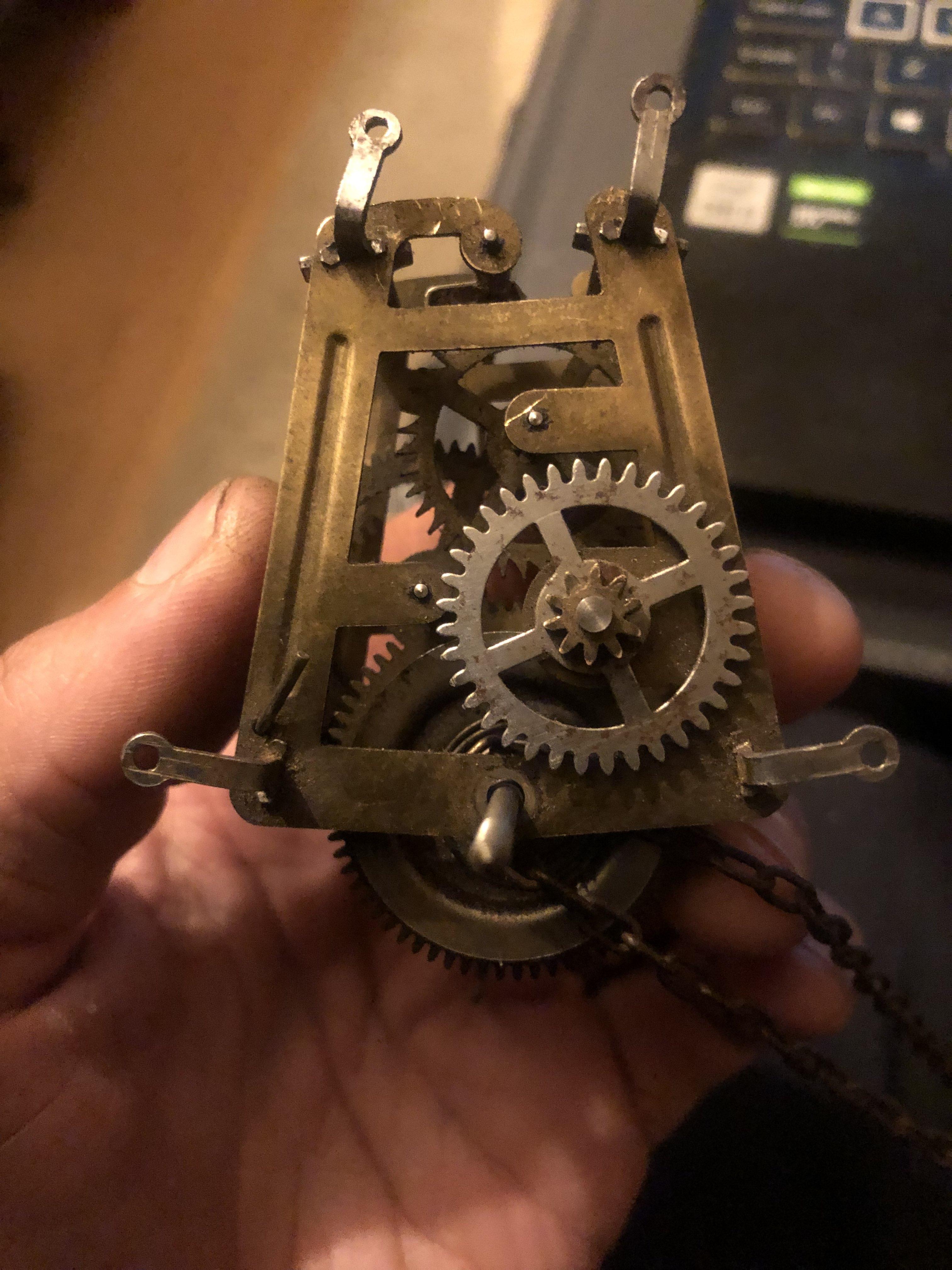

With this type of movement it will only cuckoo once on the hour, that big wheel with 4 parts lift a lever so the cuckoo works. I have marked the wheel.
There is normally a piece of metal sticking out to lift the tail of the bird. The long piece at the back try putting it under the nail it should lift the other bellow. Look for holes or splits in the bellow if they don't sound right.
Don't bend it that much so the bellows doesn't close it is a trial and error when it comes to sorting out the sound. To help you could put tiny drops of oil on the wires where they touch.
