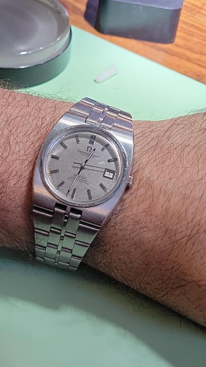

Love the integrated bracelet and round dial. I found an advertisement from the time period somewhere touting the high beat and the first of its kind integrated bracelet of this watch. I have the square dial version and the case has 4 screws and much harder to do simple rate adjustments without taking it completely out of the case.
