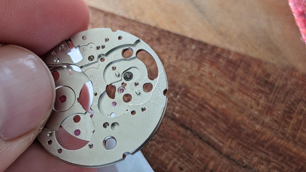

I have an old ETA 2842 which I use to test the process and the cleaning in general works pretty good...but I found one strange thing during one run I did yesterday.
After the 10min wash cycle in Elma Red 1:9, the bright silver balance shock jewel metal housing colored black.
Do you have an idea what happened here?

I use the same liquids but in a vintage Elma watch cleaning machine and have never experienced anything like that. What happens if you rub the housing with a piece of peg wood? Does the black colour come off?
Elma Red 1:9 is ammonia-based. I wonder if ETA perhaps used some special alloy in this particular case that would react with the ammonia. Maybe the 58°C has something to do with it? I only use room temperature which of course is less efficient. Darkening of steel usually happens when subjected to the acid for de-rusting. Well, I'm just guessing.
If you rub it with peg wood, it is possible to rub it off...but not easily and not completely - so it's definitely some surface reaction/coating. You can easily scratch it with tweezers.

The only reaction I can think of offhand where a silver (and non-ferrous) metal rapidly turns black without extreme heat is with actual silver?
If there was any sulphur based material in the liquid, that could possibly produce black silver sulphide/
>google<
OK, looking at the Elma Red safety data sheet, it contains sodium cumenesulphonate and potassium cumenesulphonate.
The silver reaction seems a possibility?
If it is that, it can be converted back to silver by bubbling hydrogen over it; hold it over some shredded aluminium foil in a washing soda solution - as long as that will not harm any other part of the plate?
(That's an old trick to avoid taking the surface off tarnished silver or silver plated items when cleaning them).

1) if this is silver sulphide then the jewel housing must be made out of silver right?! Does anyone know for sure which material is used by ETA for this? It was very shiny before...so it would not surprise me. On the other hand....why would I use silver for that, when the pivot never touches this housing?! Would be a waste of money for me?!
2) if this is silver sulphide - do you think it's required to remove it...or can we live with it on the main plate/housing? Actually it's a shock jewel housing...so in my opinion it's only cosmetic and will not influence the performance of the balance?!
That's a really hot bath temperature. I don't recall ever seeing a watch-specific cleaning machine with heat available for the cleaning bath; however ones that have ultrasonic do warm the bath as a result of that. In my ultrasonic tank in which I use a similar product to the Elma, I set the heat to 35 (C), mostly because I don't tend to leave parts in long enough for it to heat from the ultrasonic action. A warm bath does tend to clean better or at least faster than a cold one.
I think the ammonia in the Elma has reacted with the plating on the setting at that high temp.

The setting could have been silver plated? I doubt it would be solid silver.
