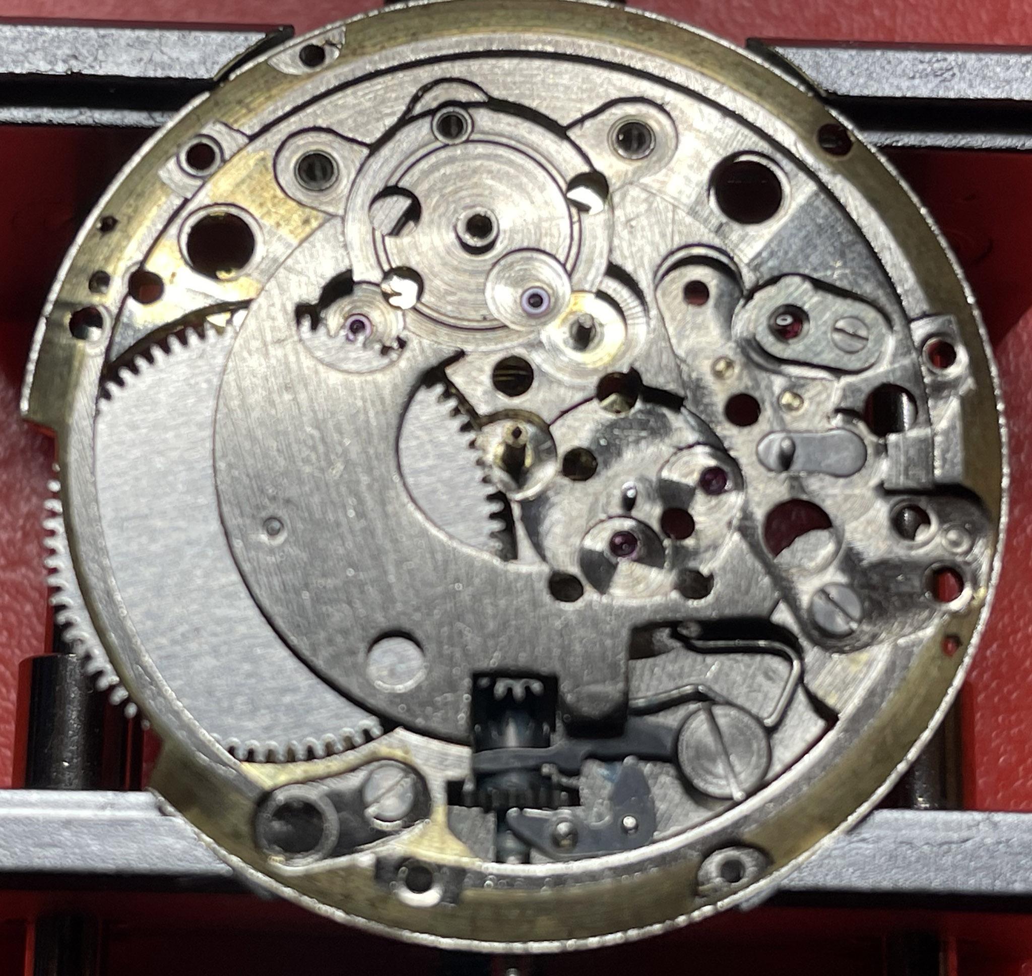

The movements for both the Borea and the Gruen Precision I posted in another thread are now assembled and running nicely.
The Borea has a very unusual (to me, at least) motion works - no canon pinion, but a free spinning brass pinion of similar dimensions running on a fixed sleeve, driven by a second (steel) wheel that's part of the barrel. That is mounted on its back (dial side) with some form of friction drive?
The keyless works switch between driving the crown wheel for winding, or the steel wheel side of the barrel for time setting.
This is part assembled, without the ratchet wheel etc.
And the dial side, without the pinion in place:
