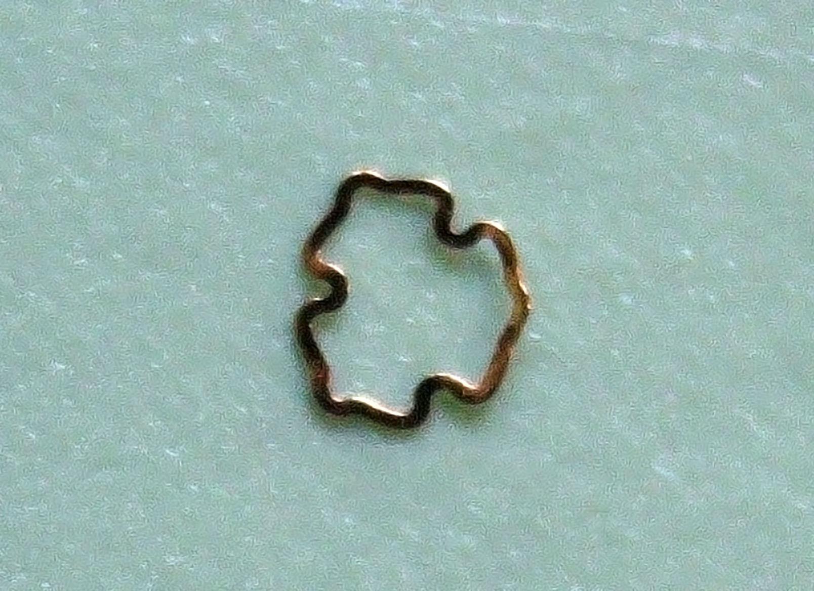

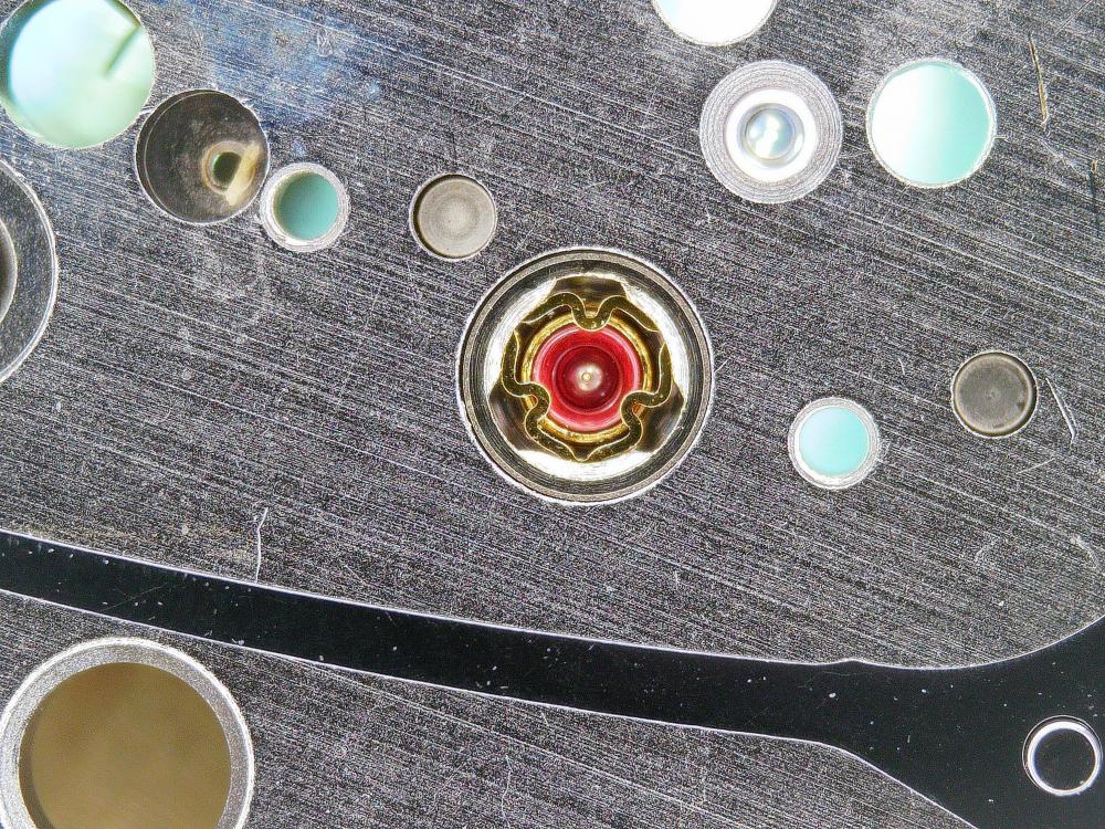

What I found initially when I began stripping the movement was a shock spring floating around inside and a missing cap jewel from the dial side of the balance.
It is clearly bent and I assume the watch took a pretty substantial impact to knock the jewel and spring out like that (never found the jewel - more on that later, too). The balance staff pivots looked in decent shape. But hey, proof of concept for shock settings, right? 😉 I was able to find a suitable cap jewel and I had a Novodiac spring on hand so before I had it in pieces I was able to replace them and the watch ran, so that was almost that.

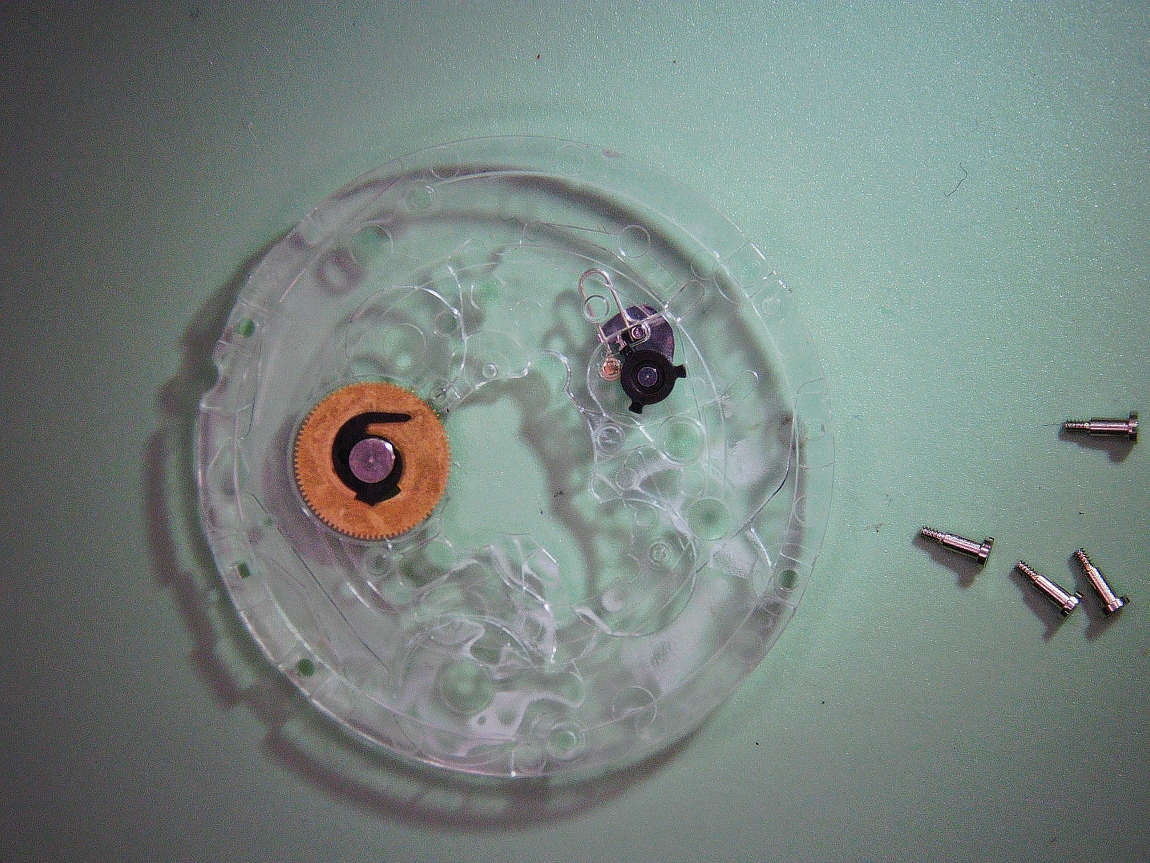

Beginning the rebuild.
The first thing that went together was the keyless works. This has to go in before the chronograph side because the plastic plate that holds most of the chrono levers in place covers most of the keyless. Oh, did I mention that the chronograph complication is on the dial side of the main plate? Nothing special with the keyless works. Pretty standard ETA stuff.
I suppose this is technically a column wheel chronograph, but to me it seems to incorporate a good bit of cam action as well with the column wheel attached to the main plate with a fixed stud rather than a screw.
Since the plastic plate that holds the minute and hour counter wheels in place also has the date jumper and date quickset attached with studs and cover the shock setting, now is the best time to clean and lubricate it. As JohnR725 pointed out, the Swatch group hates independent and hobbyist watchmakers by using the three notch version of the Novodiac setting.
The is a version of this setting that has one notch where you can insert one leg/dimple/bump, whatever they are called, of the spring under the lip and rotate it with two pair of tweezers, but NO, ETA had to use this one where even with three hands it would be difficult. You need a special tool to press the legs of the spring -- and ONLY the legs -- so you can simultaneously capture them under the lip of the setting. Great, another single purpose tool.  😉

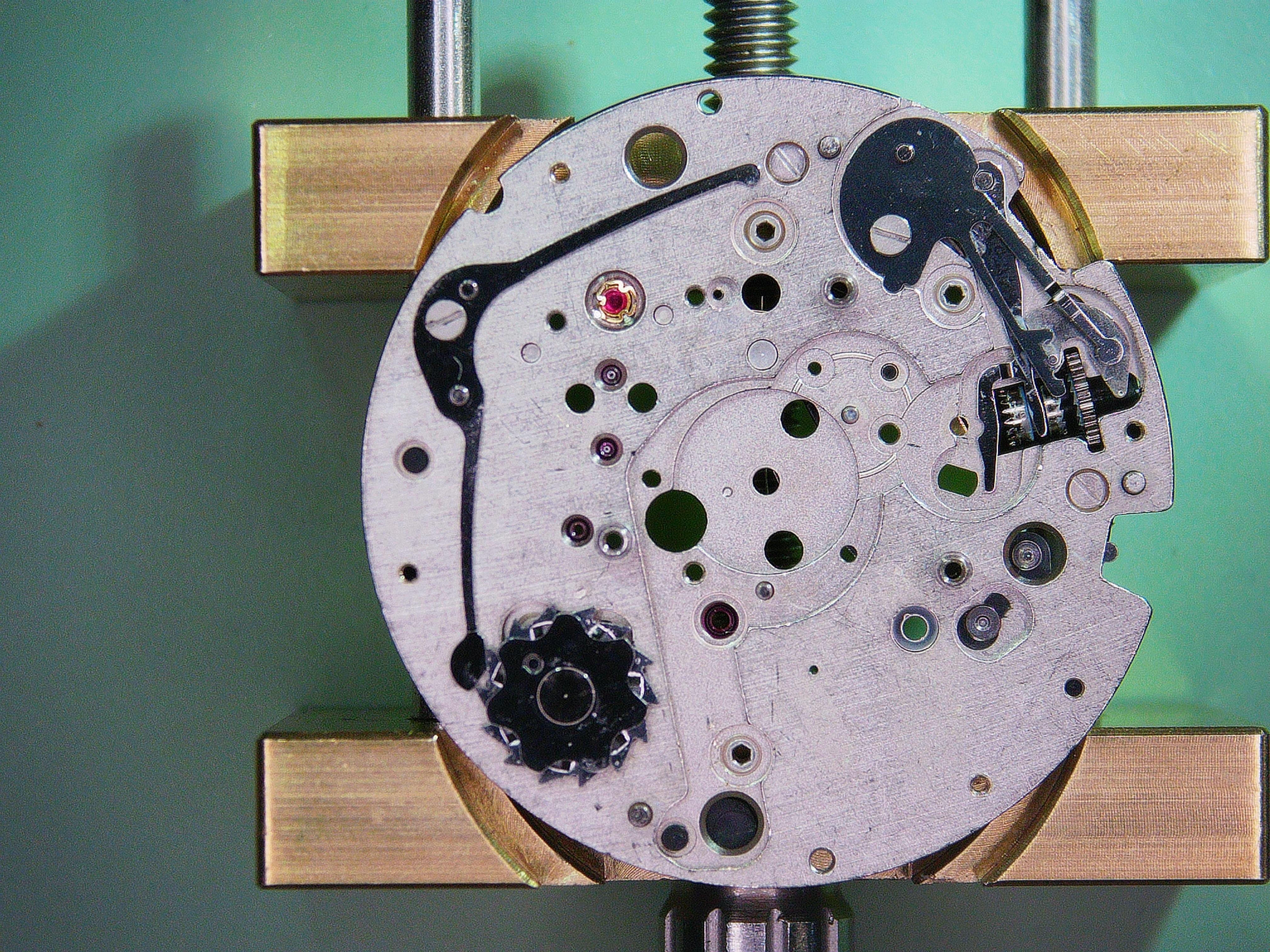

I found out the hard way that assembling the chronograph works makes assembling the train side much easier. The center plate/spring had a brass piece attached that is the pivot hole for the runner wheel, which is fit from the train side and makes it next to impossible to install the train bridge if this wheel isn't in its pivot. At this point the levers and wheels are in place simply by sitting on posts or with only one side in a hole. The minute and hour wheels have heart cams on the underside and are in contact with the levers, which are now under tension from the springs. One false move and it's watch-part Jenga! The plastic plate secures it all in place.
(sorry, I don't seem to have a shot of the plate without some of the motion works, but I am NOT going to strip the movement again just to get it. 😛 )

The main difficulty here isn't assembly, but holding it in the movement holder. The plastic plate on the dial side just doesn't get along with standard movement holders and even this heavy brass holder has some problems getting a grip. I thought about 3D printing something, but for a movement I'll probably not see again, I just struggled through.
There are two plastic "bridges" on the train side. The lower bridge shaped like a crescent just has two bosses that friction fit in the main plate. This is little more than a spacer. The upper plastic bridge covers the bottom of the keyless works and holds the click, the hack and parts of the automatic works. This attached with two screws from the dial side.
The ballet starts with placing the chronograph seconds runner on the correct side of the retention spring.  Then place the  fourth wheel, the escape wheel, intermediate wheel and the crown wheel and ratchet driving wheel on the plastic bridge. Top that off with that little brass plate over the crown wheel. Finally you have that monstrosity of the coupling runner and coupling yoke (That's what the Omega manual calls these parts). The yoke has three little tabs that have to slide into a slot on the runner while you position the pivot in the hole through the main plate, engage the escape, fourth, and intermediate wheels and the seconds runner while trying to keep the yoke upright. And (yes, there's more) you have to retract the seconds hammer or it will slide under the seconds runner and raise it just high enough for the train bridge not to settle into place.
Getting the train bridge to settle on all five pivots is akin to Sisyphus rolling his rock up the mountain. Everything slips out of their respective holes at least once for each pivot.  Finally you get the main plate situated and screwed down and breathe a sigh of relief knowing you didn't forget to place the hack again before tightening it all up (ask me how I know.)

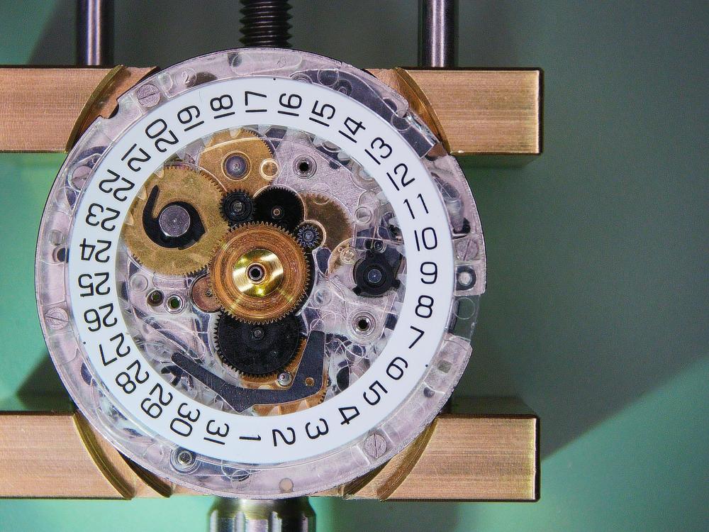

The canon pinion is trapped under the minute recorder bridge when the chrono works was assembled. Above the plastic plate are the minute wheel, minute running wheel, the hour runner and several intermediate wheels. The thing is that running wheels are driven by the minute heart, although it sets the hour runner as well. This is a two level wheel dropped over the canon pinion with the heart on the bottom and the hour runner (large black plastic wheel) in between the upper and lower wheel of the heart wheel combo. When you slide the heart cam wheel over the canon pinion, you have to hold it about halfway down to be able to slide in the hour runner or you won't be able to get the hour runner to drop on its post in under the upper wheel of the heart wheel. And you then have to retract the hammer so the heart wheel will drop all the way down or the other wheels won't mesh properly. I'm sure the engineers at the Swatch group were chuckling when they thought about someone struggling without a service manual. I should at least get a piece of cheese at the end of this labyrinth. 🤨
The one (and only one) thing they did to make assembly easier is to not have to but the day jumper spring in until the cover plate was on. When you put on the hour wheel and cover plate, the spring just drops into position in the plate through the slot. Maybe that's my reward for getting this far.

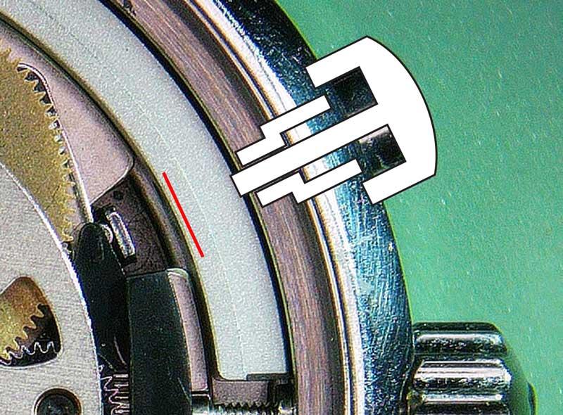

To wrap things up, all that's left is the dial, hands and recasing the movement ... at least you'd think that. And you'd be wrong. First, you have to put the movement ring in the movement BEFORE you put the dial and hands on (ask me how I know that, too) And then you clean the inside of the crystal, blow off the dust from the dial and ... wonder why the chronograph doesn't run. The pusher doesn't reach the operating lever.
Wha? The illustration shows the watch how I received it. The pushers were in good shape and looked original but they were much too short with this movement ring. The red line illustrates the maximum depth the pushers travel. I could find nothing about this but the ring was beefy and had holes that looked like they could accommodate extensions, so I ended up buying a couple sets of varying diameters and lengths to get a proper fit. It does seem to work, but I have no idea if that's the way they watch shipped from the factory or if these are the original pushers or if I just missed something.
My theory is that the original owner dropped the watch, popping out the shock jewel and spring and took it to someone to repair. When the person opened the back and saw the movement they  threw their hands up and gave the watch back, unknowingly dropping two pusher extensions and one cap jewel on the floor. that's the only thing I can think of to account for the missing pieces.
