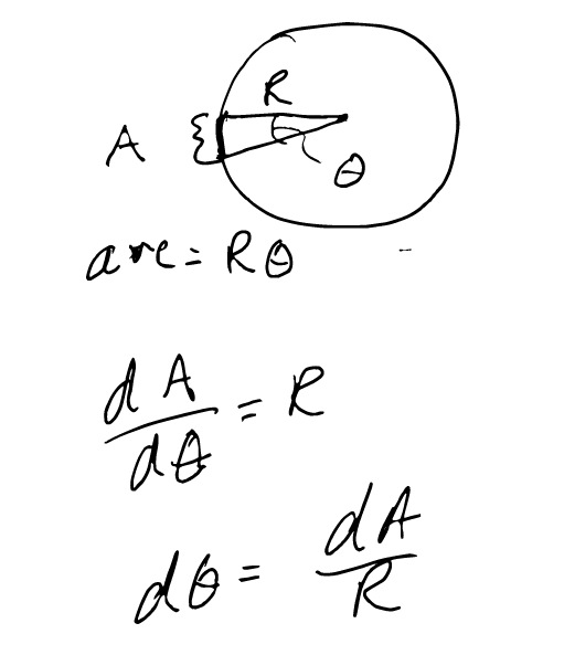

Question for members. Why mark the outer wheel relative to the stud. Why not at the centre where the collet gap is?
Excuse my ignorance for the question.
Not as accurate Ross and you would need to get under the hairspring to do that, so not a very safe option. But there might be instances when you could do that if you wanted to.
It is in the math.  What is important is the angle of the collet (pick the slot as the reference) with respect to the roller table. The sensitivity of the angle to the mark is inversely proportional to the radius.  Mark it on the rim of the balance wheel.
