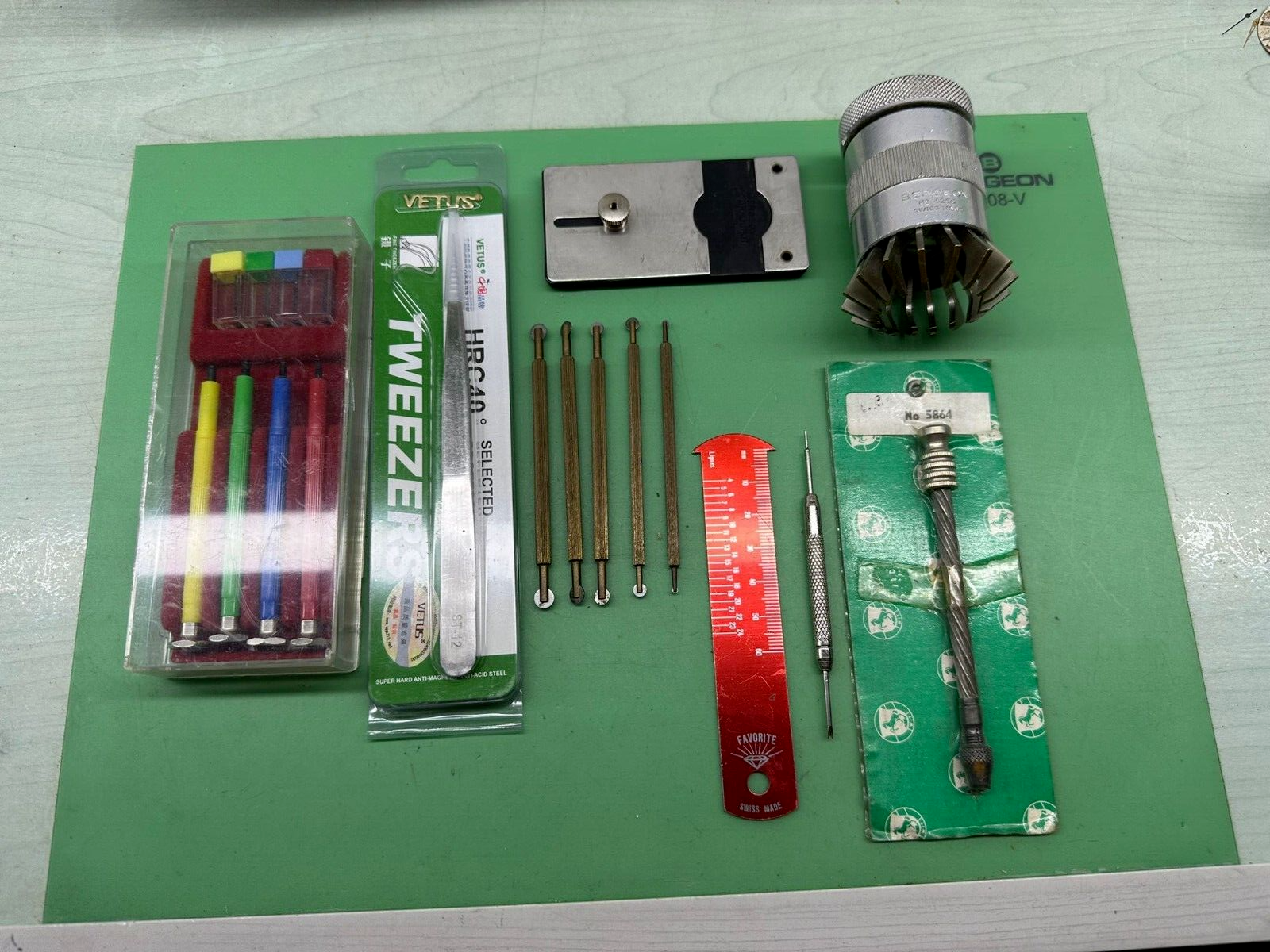

  On 9/10/2023 at 11:54 AM, RichardHarris123 said:
Hello all.  These are part of a job lot on ebay, the description states incabloc removal tool but I'm not sure.  I can't see how they would remove the shock spring or setting.
Expand
I cant see why you would need anything besides tweezers or a pointy implement to release the spring. Maybe in the plastic container is the pointy part. The driver style handle does suggest you are turning something. Sellers often gets tool uses wrong even the wrong trade use. Tom's link to cousins punches and stumps could be for adjusting the setting height.

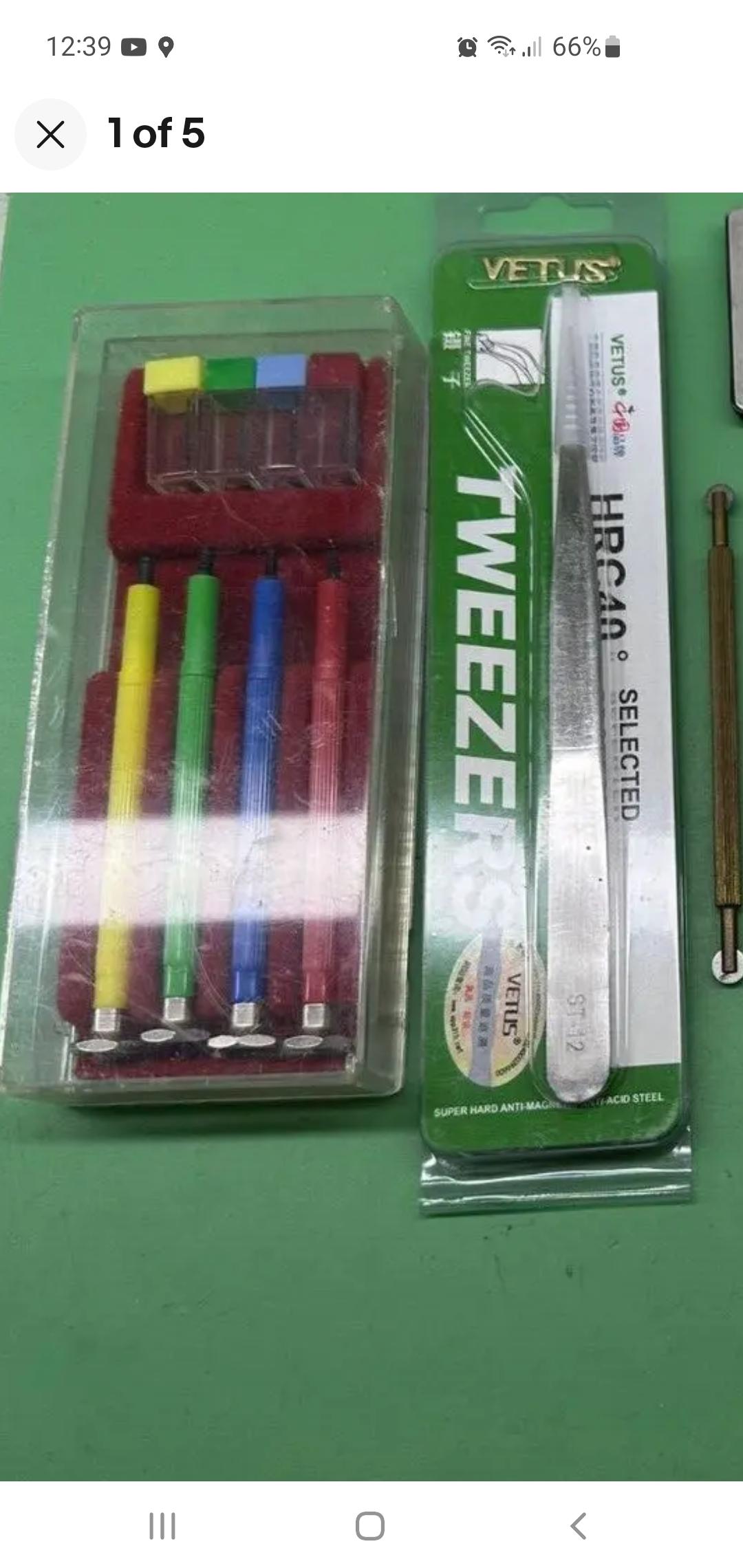

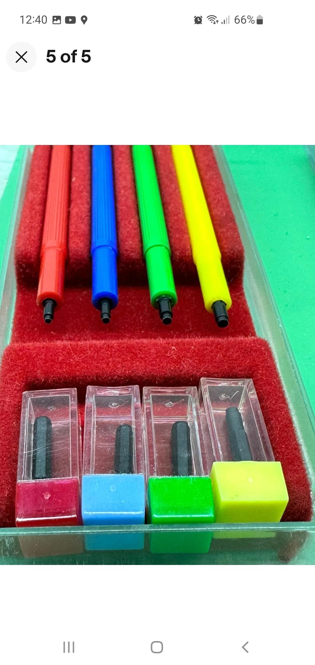

Oh it would probably help if we had a better picture
Why do we need a better picture well it would've been nice if the person photographing it done much much better picture but still we need the better picture like above and then we have an amusing problem well not a problem but the question

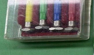

For instance if you only saw the image I have below what would you think these are
They look like screwdrivers to me? Then if you look at the other end they appear to be round and Anything I'm doing to enhance the image isn't working there is no detail in the tips themselves other than the physically round. They also come with replacement tips which none of this would be needed to work with the spring on a balance jewel.
So my best guess is there some sort of socket set probably for removing screws on a case back.
Oh and the problem with people selling watch tools are unless they know they will make guesses.
Then yes interesting assortment of tools notice the brass handle things in the middle those are actually quite useful. Not that everything else is useful but those are interesting.
Expand
They certainly are John, i have a set in fact 2 sets i think.  Would you call them deburring tools, oil sink tools, countersinks ? I have feeling there are two types , a type for cutting and a type for smoothing.
