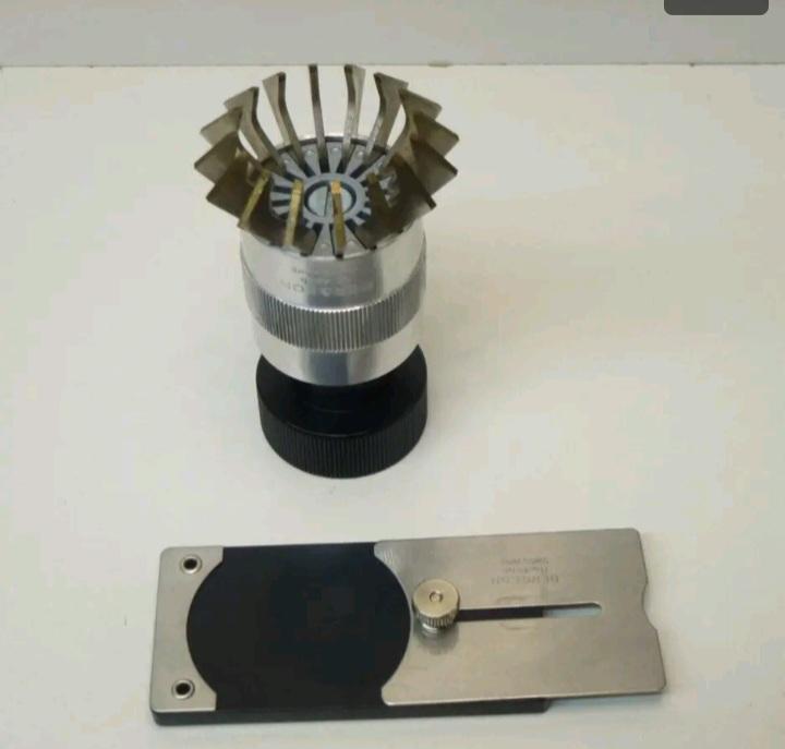

I have something from robur that works in a similar way to individual wrenches. It works really well. The other is a bergeon crystal lift for future reference for galilea and fjseal.

It's a fun rabbit hole to explore - many options have popped up over the years.  One thing I find interesting is the different ways toolmakers provided us with a means to load up a crystal for installation – it's important to get just the right depth of grip. The two terraced rings that are part of the Electro-Vice set (see below) tend to work better for me than the sliding tray shown above, but it isn't obvious that they go along with the crystal lift tool so you often see them being sold alone in watchmaker tool lots.
Nice selection, If you cant get a crystal off Geotex then no-one can.
