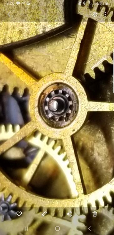

I noticed that if I turned the barrel the train would not turn even though the barrel did. I turned the large gear in the center of the movement by hand,,, the train would run smoothly down the line.
What it seems like is happening is that the smaller gear (small silver gear - red arrow) on that center wheel (first in the train off the barrel) turns while the larger gear does not. See photo. They are able to turn independently of one another though. Is that a thing?
Seems like energy stored in the spring can't make it into the train as the smaller gear turns but is not transferring the energy into the larger attached gear, on down the train. It just spins... Could this be?

Quite likely this suffered from a broken mainspring, with the mainspring wound quite a bit. The shock of that release of energy can actually break teeth on wheels and pinions. A lot of American stuff is marked "safety pinion", which is a center pinion that's threaded onto the center wheel; in a mainspring breakage the pinion unscrews, avoiding damage.
In your case it seems the shock stripped the rivetting between pinion and wheel. You might be able to re-stake the rivet with a staking tool, but will still be shaky. Try Dave's Watch Parts, a replacement center wheel is your best bet. You might need to email him with specifics. Other U.S. suppliers may have it too.
Actually, looking at it, something seems off, curious what others have to say, but this might be Swiss (back in the day they actually faked American watches)... in that case, re-staking might be the only option.

What you're describing above cannot possibly happen. As others have already described the purpose of the safety pinion is to unscrew if the mainspring breaks this is a prevent the energy from breaking the rest of the watch. If it unscrews none of the energy of the mainspring can get to the rest of the watch As they won't be any energy because the mainspring is broken. So if that is a safety pinion and it has come unscrewed you cannot wind the watch up and you would never be let the power off because would be no power

Sometimes confusion with what I say occurs because I'm using dictation software. But in this particular case the safety pinion found on the center wheel is supposed to unscrew if the mainspring is broken. So if that was why that part is loose that would mean the mainspring broke. If the mainspring is broken it cannot be wound up.
So as I comments you originally said you let the power off if you initially let the power off and you had a broken mainspring well that would be impossible
then the part that's broken we really need better views of that because you're right the solders not going to hold. It would be nice to know if it actually is unscrewed or whether it's somehow broken typically the pinion is not a separate component if it's not the safety version in other words entire steel shaft with gear is one component usually frictions or riveted very securely to the brass gear and if that came undone that's going to be an issue.

It probably is a safety pinion. The problem is there is lots and lots of variations I've had somewhere exactly which are describing of trying to get the stay threaded is the issue because sometimes the threads are not really the best. Other times was some watches their very aggressive threads very noticeable but sometimes are not.
But no matter what if the center pinion is not attached to the center wheel then the mainspring cannot hold because the mainspring barrel pushes against that and the gear train so initially if that was unscrewed you absolutely cannot wind the watch up or for that matter you cannot let the power off so that's a bit of a mystery here

Below is a shot of the center wheel and it's pinion connection, before soldering.
Admittedly, in many ways I don't know what I am looking at. But I'll try and describe what I think might be going on.
The teeth on the large wheel of the center wheel engage with the first (second?) wheel of the train. The smaller pinion, on the underside (the pinion in question) is engaged with the large wheel on the TOP of the barrel. On the underside of the barrel is a separate toothed gear with a central square fitting that is in union with the barrel and spring by way of a square shaped protrusion that is a part of the POST that goes thru and to the underside of the barrel... That post is part of the (don't know the correct name) bit that engages the spring inside of barrel. Shweeew, I hope that made some sense.
With that, the larger/upper gear of the center wheel will drive the train (if I turn by hand), the pinion on the underside of the center wheel spins/spin freely at it's contact with the barrel gear (the fault), while the gear on the underside of the barrel engaged with the stem, clutch and keyless machinery prevents/controls the movement and winding of the barrel??? - this I think allowed the watch to be wound AND let down independently of the train and center wheel pinion but only due to the faulty pinion...?
As a question, I didn't think that the center wheel or train actually HELD the energy in the spring and barrel, but only transmitted it??? I think the wheel in the underside of the barrel holds the energy? No?
