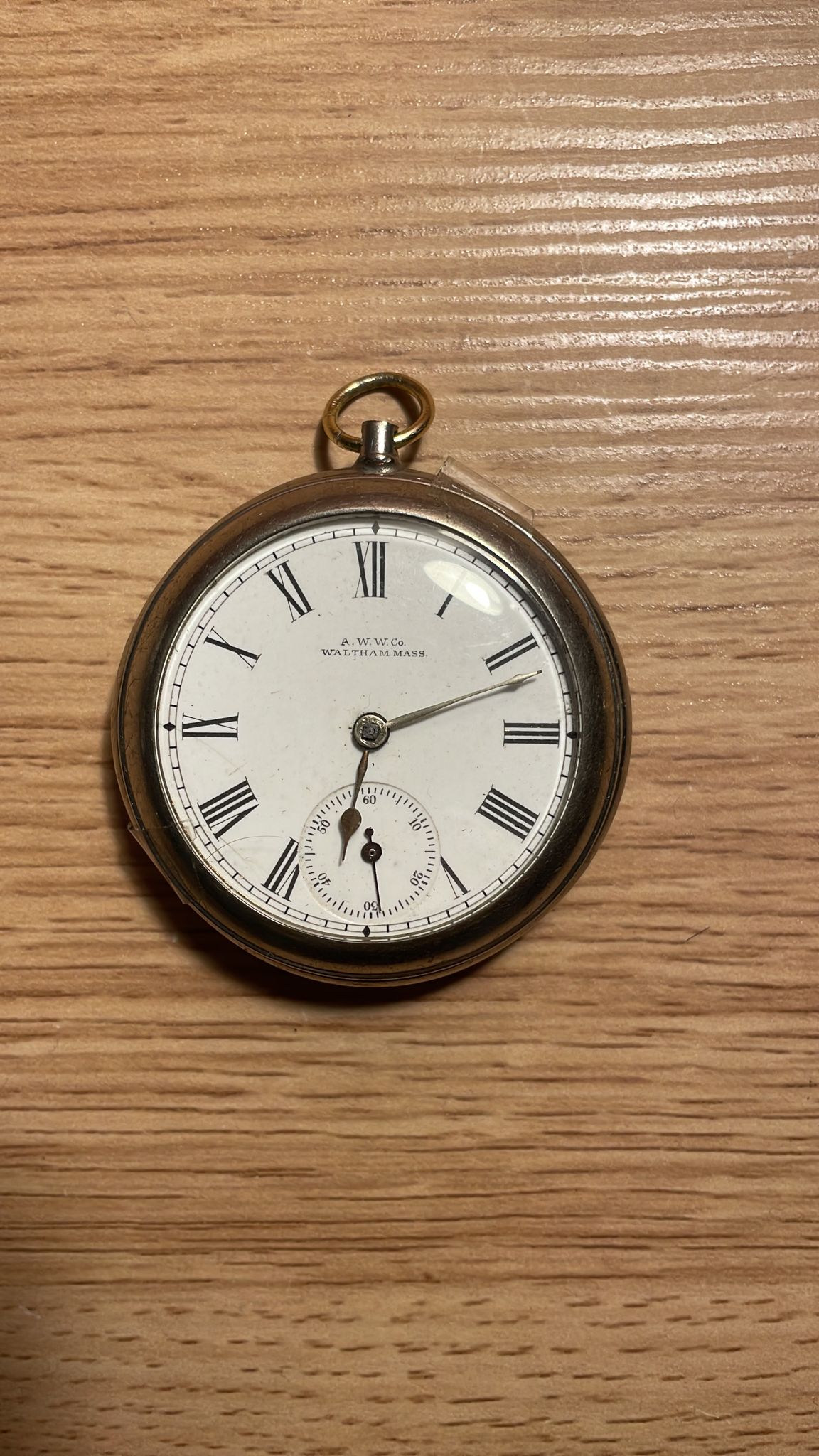

The first pocket watch I've tackled is a Waltham 1883 18S with a serial number of 8248400. It's an openface with a full plate (which I've since learned might not have been the easiest thing to start with) and I think I've diagnosed at least one main problem. The fork has a broken pivot/point on one end and I'll need to find a new one.
Here's where my question comes in. I look through all the parts (mostly on eBay) but it's really hard to understand exactly which fork is right for the watch I have. I know I need one that goes with the openface style instead of a hunter, but that's where my research hits a wall.

Hi Marvin you need JohnR725 on the case our vintage and Waltham guru. And have a look at Dave’s watch parts.com for Waltham Elgin bits   Another mine of information is thepocketwatchdatabase,   Insert the serial number on the watch and do a search fit the model, size ,grade.  It’s all there.
Thanks watchweasol for the response. Your response made me feel decently smart. I'd dug through daveswatchparts.com (they had the Hunter fork only) and the pocketwatchdatabase. I just could find the specifics to explain the different part numbers in the descriptions I was looking at. I'm guessing there are tons of stories on this forum about weird eBay postings like that. I'll be excited to hear from @JohnR725if he happens to see this. The Waltham's are my favorite right now so connecting with a real guru on them would be awesome. Really appreciate the kind response.

With your serial number and the pocket watch database on the left-hand side it says parts you can get a parts listing. But with Waltham's it isn't always that simple.
Yes 18 size full plate is definitely not the best watch to start with. Then because you don't understand how to deal with the pallet fork or somebody before you didn't breaking the pivots is a very common thing to do.

Early American pocket watches ran at a slower frequency Then they switched to 18,000 beats per hour which is what I think quick train means. In other words it's the standard rate now 18 size pocket watches were made earlier than the other sizes and if you have a key wine diversion it might have this lower frequency.
So the bottom watch database we find it's in 1883. You click the link on the left hand side in a give you images of the parts.

Now the problem with your descriptions here are first one is not for your model number. The last one is not for your model number either and the middle one for 1883 is right but now we have to find the part numbers. The problem will become lots of things like old part numbers sometimes get upgraded to new part numbers that we somehow have to figure that out
Then another place once you know what you're looking for would be another material book like found at this link
https://archive.org/details/catalogueofwalth00walt/page/38/mode/2up
As you can see clicking on the link will take you to the right page hopefully 1883.You can also scroll down and download a PDF or whatever your favorite format is.
Okay I took out a image from the catalog it looks like the middle part description is right for the escape wheel and a pallet fork. No idea whether that is the correct pallet fork or not on the other hand. The last time I had to deal with a full-size 18 whatever pallet fork was after going through all the pallet forks we had I just change the arbor I swiped it from one of the other ones I think but don't quote me they friction in some of him screw in but I think this one frictions in you do need to have the right tools though to get it out. It actually should be listed as a separate part but I'm not seeing it right now you probably won't bill Byatt is a separate part because a lot of them have been broken over the years.
