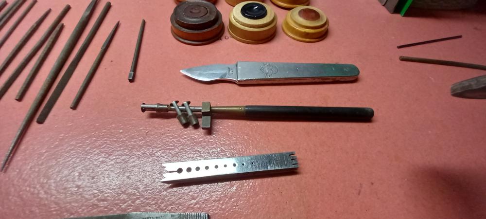

Hello all you watchmaking peeps, i trust you are happy and in good health.  Well I'm back, missed me ? Please don't all sigh at once. Work commitments has kept me busy and my watch repair interest had to take a temporary back seat. But its now time to return to it with a vengeance. Starting with my latest acquisition of vintage tools. Nothing spectacular but some food for thought for beginners on a budget and maybe some interest and a question or two for the more advanced and pros if they would indulge me. So lets start with a source and a figure of cost. My favourite buying site Ebay, this can be a waiting game for the right tool at the right price. Which can payoff if you are like me, I'm never in a rush to buy anything in particular. But always keep an eye out for something i like and might use for when my skill set improves. I never get into a bidding war, i decide what i want to pay long before the auction ends and submit that figure around 6 seconds before the auction ends ( known as sniping, unethical ? As has been discussed before, you have to play the game same as everone else). These are actually two ebay purchases, one at 6 quid and one at 14 quid so including postage came to around 24 as they were the same seller and he combined the postage for me. The majority of the two buys are cutting broaches and files. A lot of large sized broaches probably for clocks and some smaller ones for watches. Some nice part making files, names include stubbs, favourite and one the oldtimers may know Gantoine Glardon. A graver and a few homemade gravers from square files handles i think . Something of particular interest to me is a pivot burnisher with the name David Borlo A. Vallorbe. Also in the bundle is a solid ss one piece case knive, love this as it has a cracking Marvin logo on it. An unusual staking block with v slots at each end. Three agate oil cups that i am keen to replace the plastic ones i have been using, since reading some discussion regarding some plastic components can leach into the oils placed in them. And lastly the quiz tool that has 3 accessories slid onto the handle shaft. Happy reading and any input would be welcomed and appreciated thank you.

Thanks WW I need to get my finger out and find out what the mysery tool is for.
What you mean by Mystery tool it looks like something that's in my bench at work.

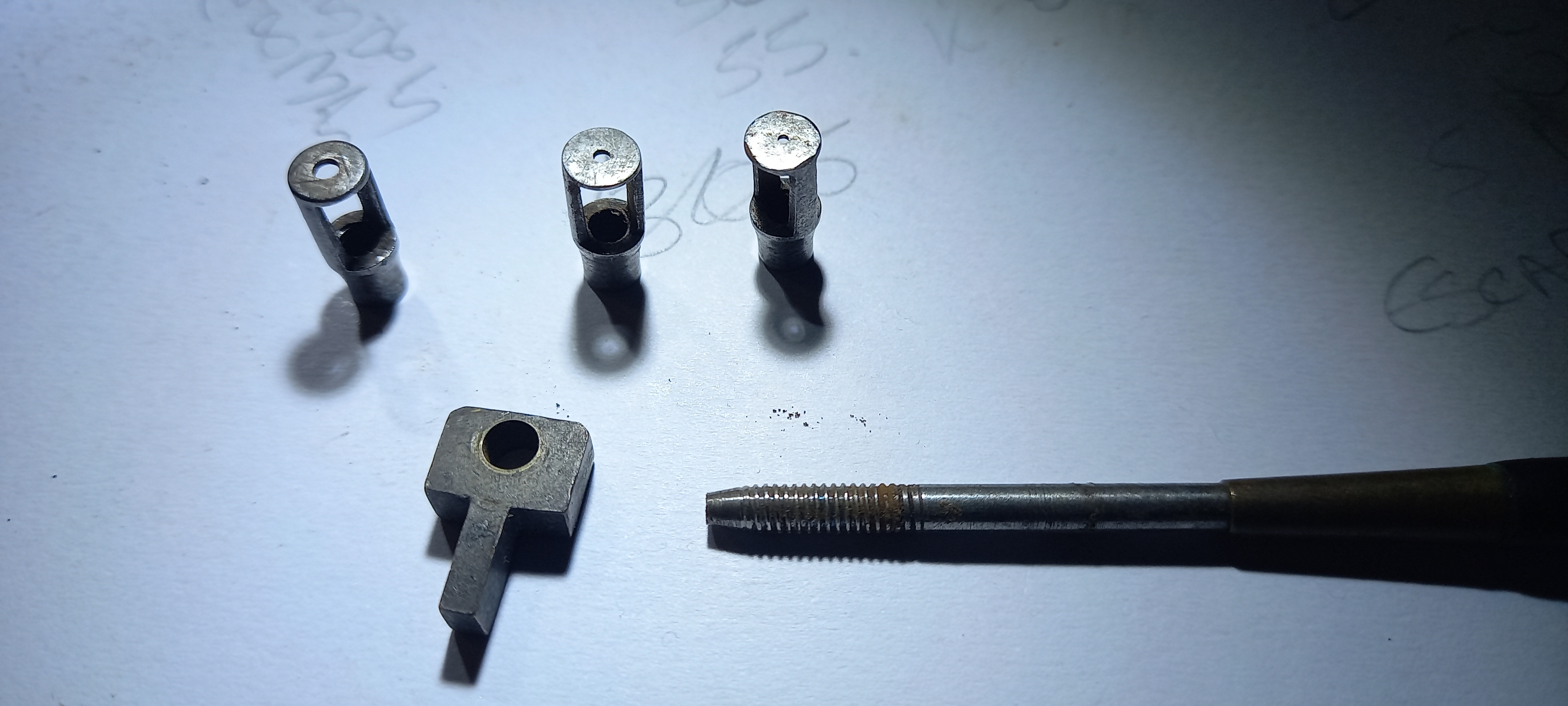

It would help on the mystery tool if you unscrew the end piece so everyone can see the holes in the end and then show the end of the tool. I suppose was really nice and find a vintage catalog and find your picture of the thing but do I really want to be that nice? Of course I find the Log of vintage tools. Okay I found the link to the tool catalog a little light reading.
I've attached an image the mystery is gone how sad. So you can use that the finished the other end of the screw providing you have enough tips to fit the right size which typically I don't.
https://archive.org/details/20thcenturycatal00purd/mode/2up
So typically to dress, shape, shorten the tip of a screw. I now owe you a few beers/coffees John .
Not sure if the brass piece is part of the tool, it was slid onto the shaft.
The mystery brass part is not on the catalog page. It's also not included with my tool but it might still have some unknown purpose maybe it's used to hold the tool somehow for some reason that I can't think of.
Maybe used to fix the tool into watchmakers vice ? Possibly home made, and brass to lessen wear on the shaft .
