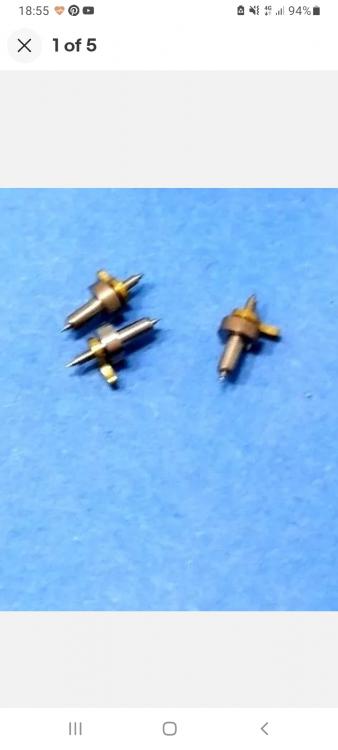

Haha. No mate i dont think so. Doigt is finger, finger on the staff . Yours has an impulse jewel. Maybe getting confused here , so lets go through it again. There are 2 fingers, a guard finger on the lever and a staff finger instead of a roller and impulse jewel. You want a roller = plateau.  🙂. This is what avec doigt looks like.
Aaaah so many new terms to learn 😳 This is why I put up photos, thank you. 🙂

To be honest i have not come across a staff with a brass finger as yet. As far as i know the guard finger on the lever is above the fork with this. So a quick recognition as soon as you look at the lever to say " oh no can i get a new staff for this if i need one " 😆
