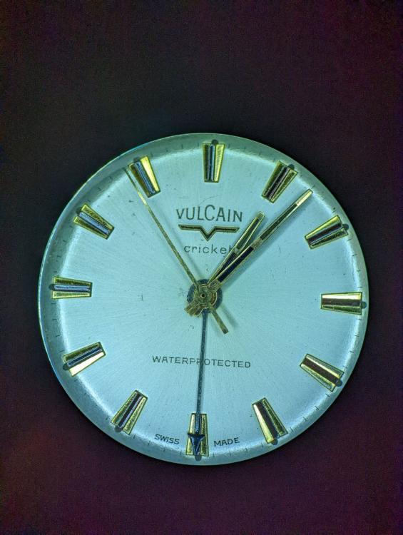

I would like to present to you my latest project, a Vulcain Cricket (yes, another Cricket), model S2315A. I always wanted a Cricket, and it looks to me that Vulcain has made a lot of different variations of dials, watches etc. Cannot really find much info on the one I have.
Initial condition overall: is running, but definitely needs servicing. It has a lot of DNA allover the place. Also, the watch came with its original bracelet (I wonder how that will turn out).

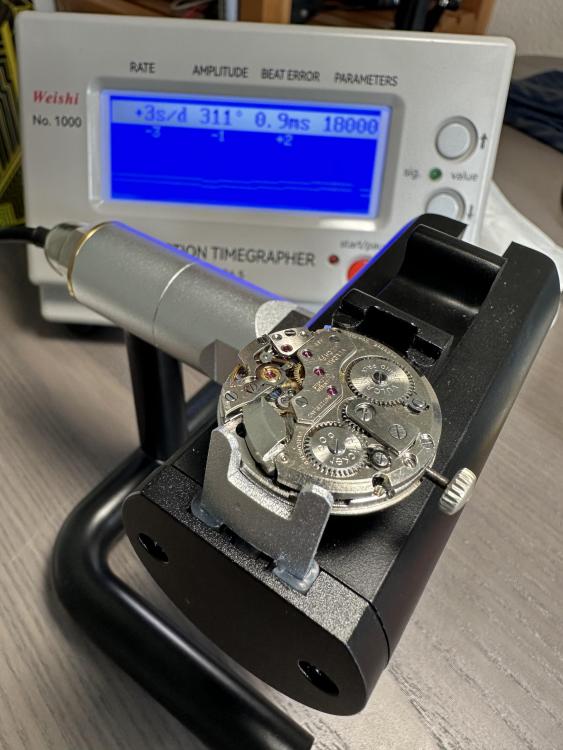

Movement: looks to be a cal.120. Not 100% sure as googling for this caliber brings different results. What do you think? Also had tested it on the timegrapher, results on the picture.
Crystal: needs a new one, as the original is cracked and has oxidation on the tension ring.

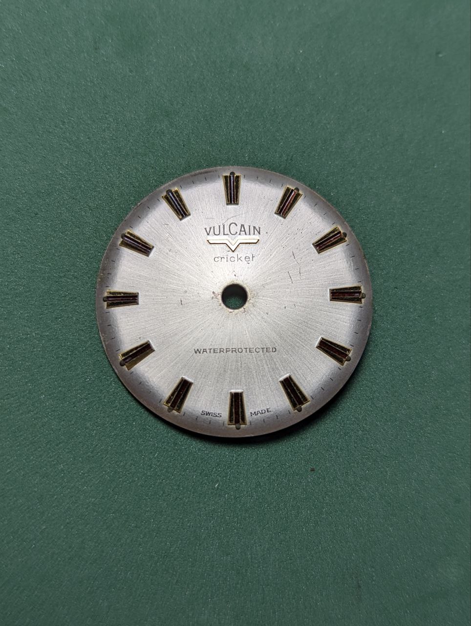

Dial: looks pretty clean.
Case: gold plating has some ware. Honestly not sure what to do as I have no setup of my own yet. Is it worth sending for replating?

Definitely Cal.120.....and the later version with incabloc balance bridge.  A nice watch. As to whether it's worth the cost of replating, the value is about 400-500 GBP serviced if sold in the UK 'as is' but could rise to 700-900 GBP depending on how the restoration of the case turns out.

Based on your pics it could be tough call on the case if the dial is great. Wait till you get the scuzz of I’d reckon…

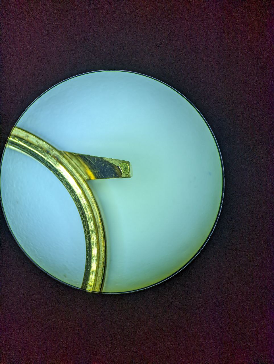

Crystal: Definitely needs to be replaced. When measuring I have 30.5-30.6mm, in the Sternkreuz Gezamtkatalog G22 there is only one that might fit is XAG306.697 (not sure how tight it would sit though). Also ho idea how it might look... Is it possible anyone knows the a part number?
Case and dial: Well I seen better dials, but also seen a lot worse. Does it make sense to invest in replanting the case? What do you guys think?

Your dial looks fine--leave it alone.
I have replaced several Cricket crystals but it has been a year.  I cannot recall if I used a Sternkreuz, GS Flexo, or some generic.  Do not use a low-dome crystal.  I seem to remember having an issue with the sweep second hitting the crystal.  Here is a side view of the Cricket I am wearing...OH NO...looks like there is a crack!  I know that I have accidentally whacked this thing a few times--I wear it constantly.

Eyup matey thats a nice timepiece that gets a nod from folk in the know. I would leave the dial alone its ok, it looks like a thin coat lacquer that might lift along with some lettering if you try any restoration on it. Good luck with the plating it will be a cracking watch if it restores and polishes up  well.

Well this one really really tasted my patience. I had it assembled and disassembled back and forth 3-4 time. Was not running no matter what I do. Turns out the problem was in the balance wheel, with out its jewels it would rattle allover the place and not take up momentum (others that I worked on didn't behave that way).
So, from Rate +73, 167 Amp. and 1.5 Beat Error I have the following (check picture).
Now it runs more or less stable, but some times speed up, some times slows down. Why?
Beat error. I could make it 0, but! if I do the balance speeds up so fast that adjusting to max slow position still doesn't help it. It runs +30-50s per day. What are my options?

Can you post a readout from the timer?
2 problems.
1. When I adjust beat error to 0, rate goes to +50-60 and not adjustment helps.
2. Amplitude jumps from 250 to 290 back and forth, witch affects rate. Does that on its own.

How does the hairspring look at the regulator pins? Are the pins correctly spaced, is the spring pushing against one of the pins, is the hairspring vertical (not twisted) at the pins?
Yep, looks fine to me.
It doesn't make sense that adjusting the beat error 1ms makes such a difference in rate - 1ms is only an angular movement of 2°.
And the amplitude jumping around so much is odd.
I've had similar odd behaviour, and it turned out to be either a loose hairspring collet, or loose roller or jewel. Unlikely as your balance looks to be in original and excellent condition. But worth a check !
What if there is some oil between the forth wheel and the escape wheel, and that oil is just on one side of it, I thought. What if its sticking on one side?
I took off the escape wheel, the pallet fork and the forth wheel. Cleaned them one more time. Removed any oil that might have been on the pallet forks jewels (leaving the pallet fork unoiled). And assembled it all back.
Results: Amplitude now is jumping from 300 to 320 (I assume that's because the pallet fork is now snappier)... Meaning I was partially right (about the above mentioned), but the problem still persists, only difference its in a higher range 😃
