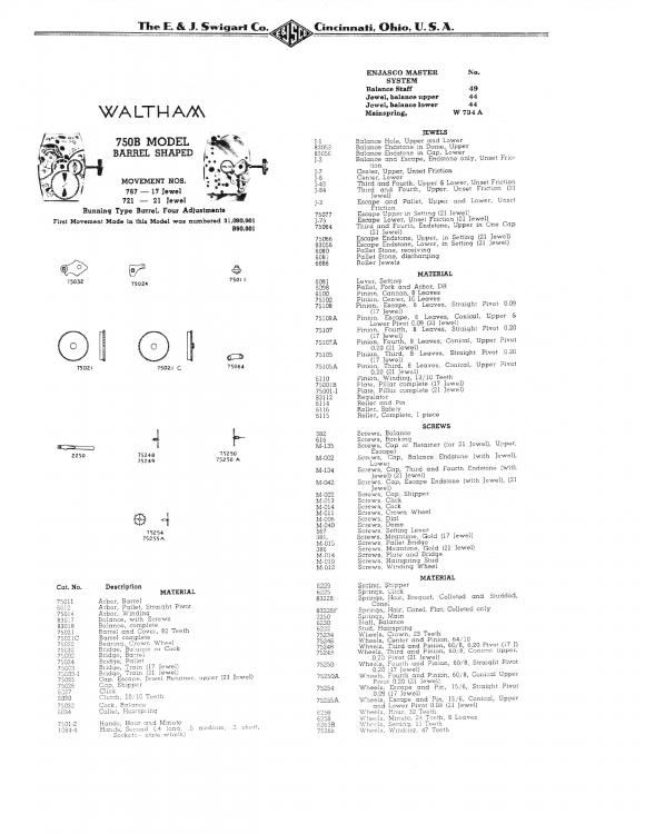

1 hour ago, Murks said:
waltham 750b
attaching the parts list for the Waltham watch as you can see there are two separate hairsprings.
