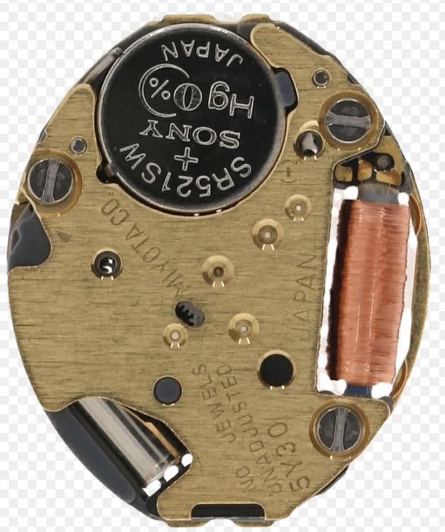

Hi everyone. I am trying to fix a Skagen Ladies watch for a friend of mine where the minute hand has come off. I need to remove the movement but can’t find a release for the stem and crown. Any of you out there know the trick?
Welcome to the forum!
Could you please post a crisp foto which allows to identify the movement? Or could you tell us what is written on the movement?
UPDATE:
Found it! It‘s a Miyota 5Y30
The arrow shows the release pont. Just push gently and pull the crown.

Thank you so much! It’s a 5Y20. I found the mark and the arrow points to the same place. You’re a star and a life saver.
