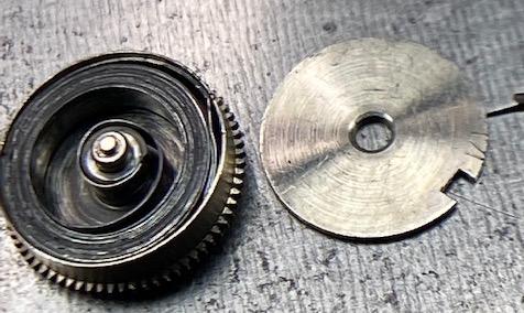

All the parts disassembled prior to cleaning.   The mainspring should be replaced as it is retaining its compressed shape so has lost power and does not have the reverse curve for sustained power.
Mainspring cover was scratched, and had grease in the barrel that was one of the worst I have seen.  Cleaned the barrel and cover manually before placing them in the ultrasonic.

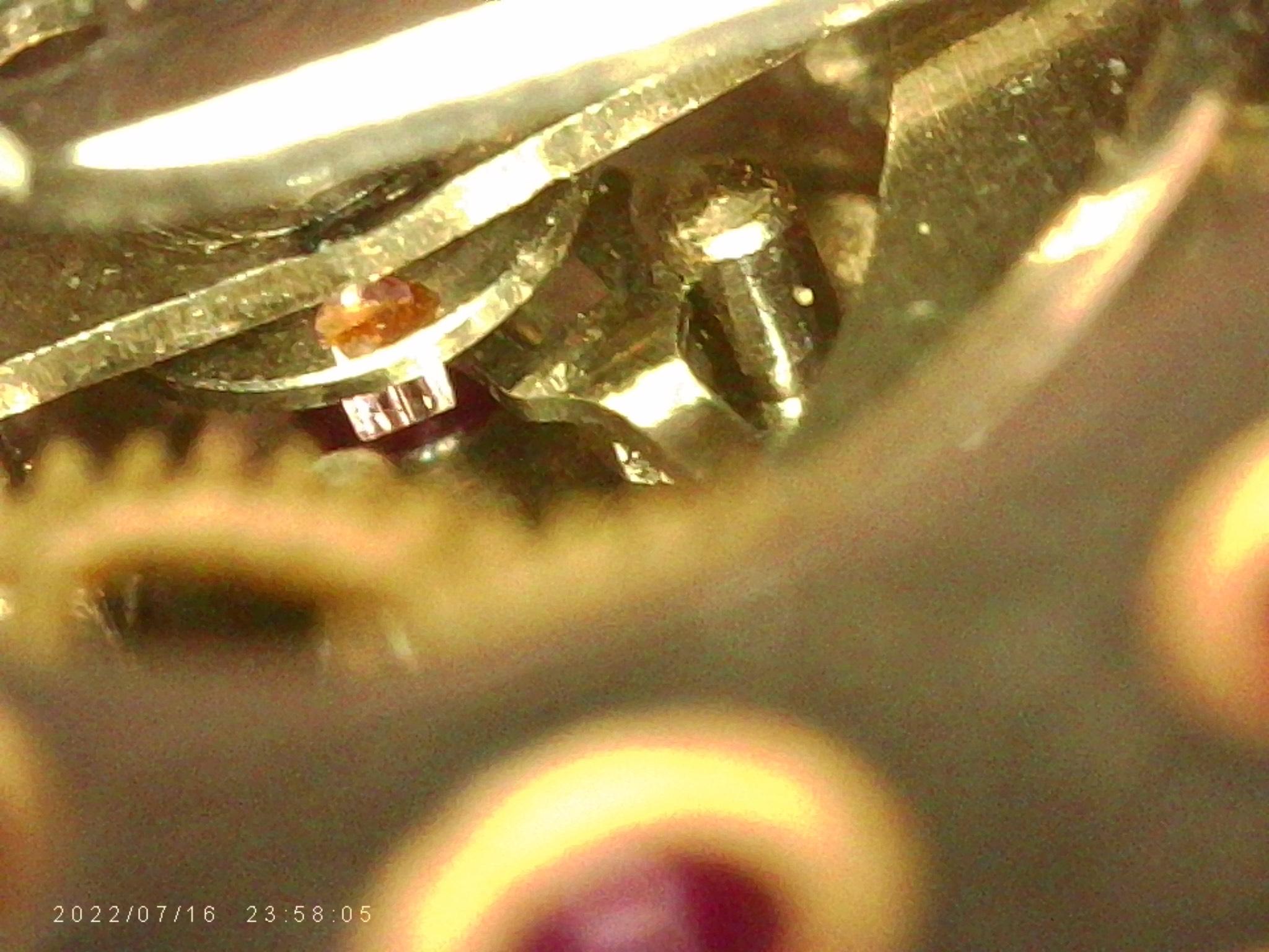

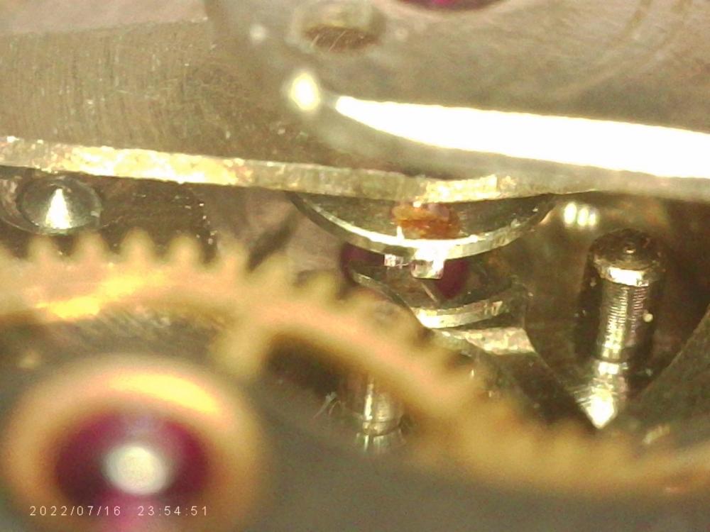

Watch runs ok in dial down and vertical positions.  As soon as it moves towards dial up the balance stops.  The impulse jewel ends up on the wrong side of the pallet fork instead of being inside it.  Somehow the impulse jewel is jumping over the guard forks.  Initially I thought it was due to excessive endshake.
Here is an example of when the impulse jewel is jumping out of the pallet fork horn and sitting on the pallet horn .
When it finishes it’s movement, the impulse jewel pushes off on the horn sending it back to the other banking pin and the watch stops running since it is now overbanked.
That is when NickelSilver informed me that the roller table appeared to be crushed (see the red background picture earlier), which explained the impulse jewel jumping over the pallet.   So I needed to replace the roller table.
